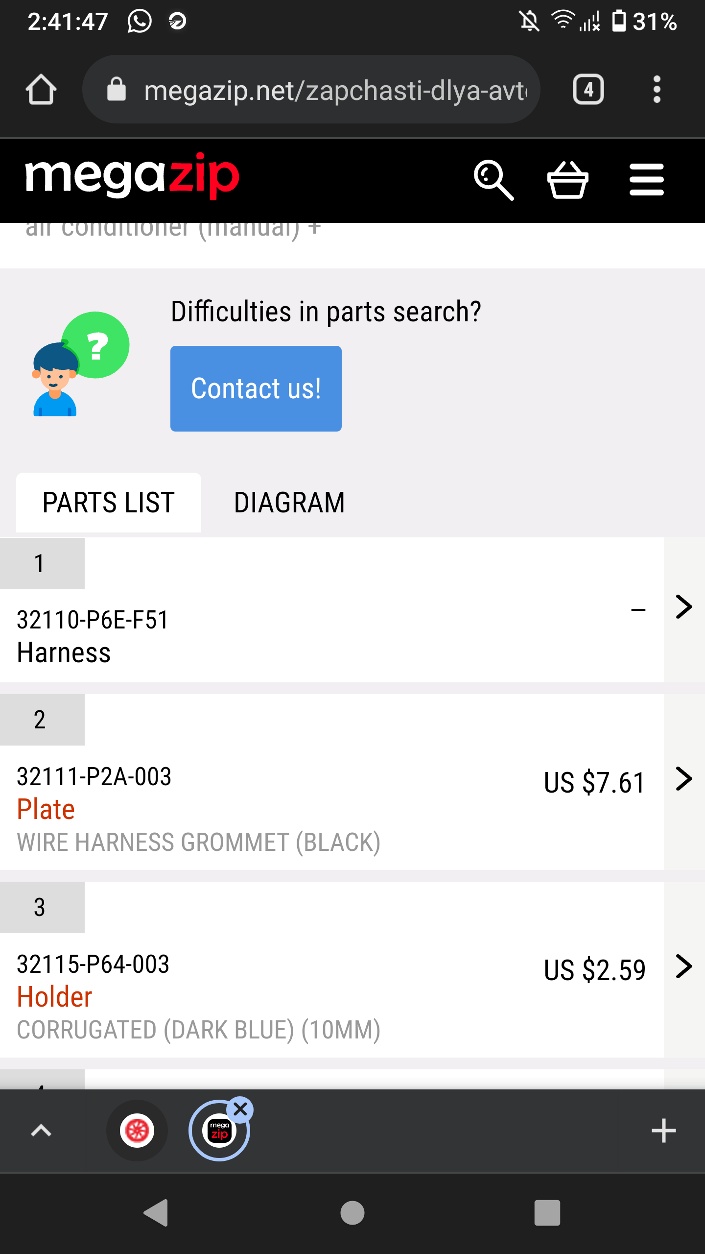

my engine comes with 37820-p2c-003 which is having some issues with AC and fuel average no stable rmp and a lot of power issue I searched same ecu but found no luck with it I got 32110-P6E-F51 ecu it get fit and car is started with good power and all components looks working fine I just replaced it today my question is that this right for my d15b engine or it will be rich fuel etc just need suggestions I can replace it I have options currently
That a chinese local 1.6 ek civic ecu.Which d15b you got to be precise? D15b only or there's a digit after b?
This is not ecu part numberEcu part no usually start with 37820

If you have pkdm exi stock engine d15b, you should then go for p2c-w01 as it will not require any changes in wiring and sensorsAlso as I said you qouted wrong ecu part number. Can you share the image of ecu sticker?
