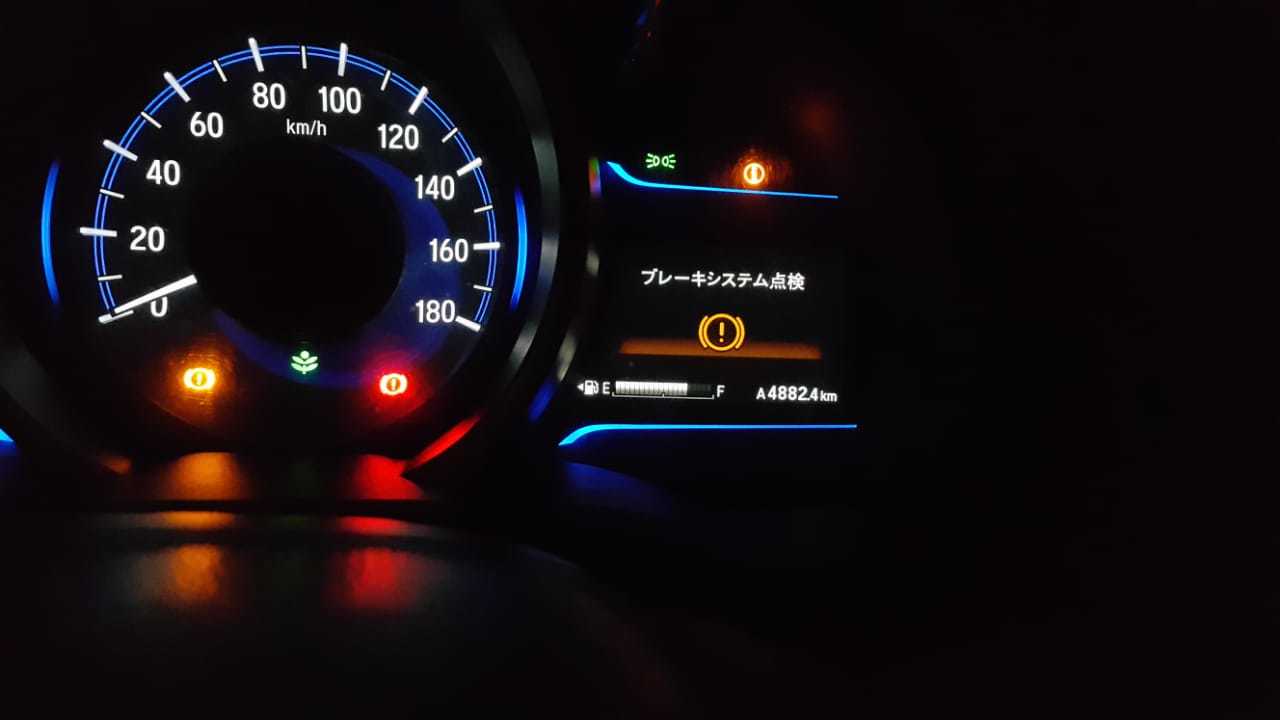

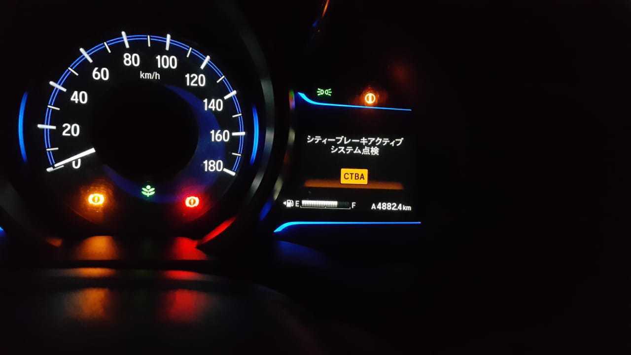

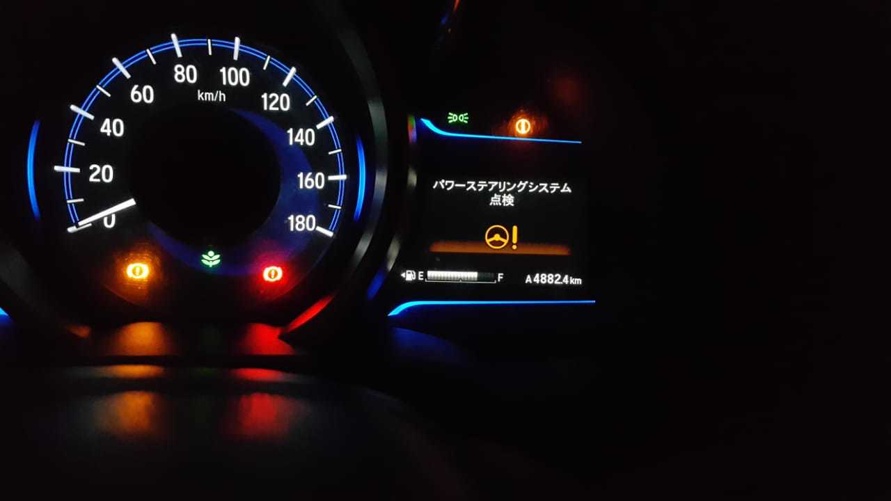

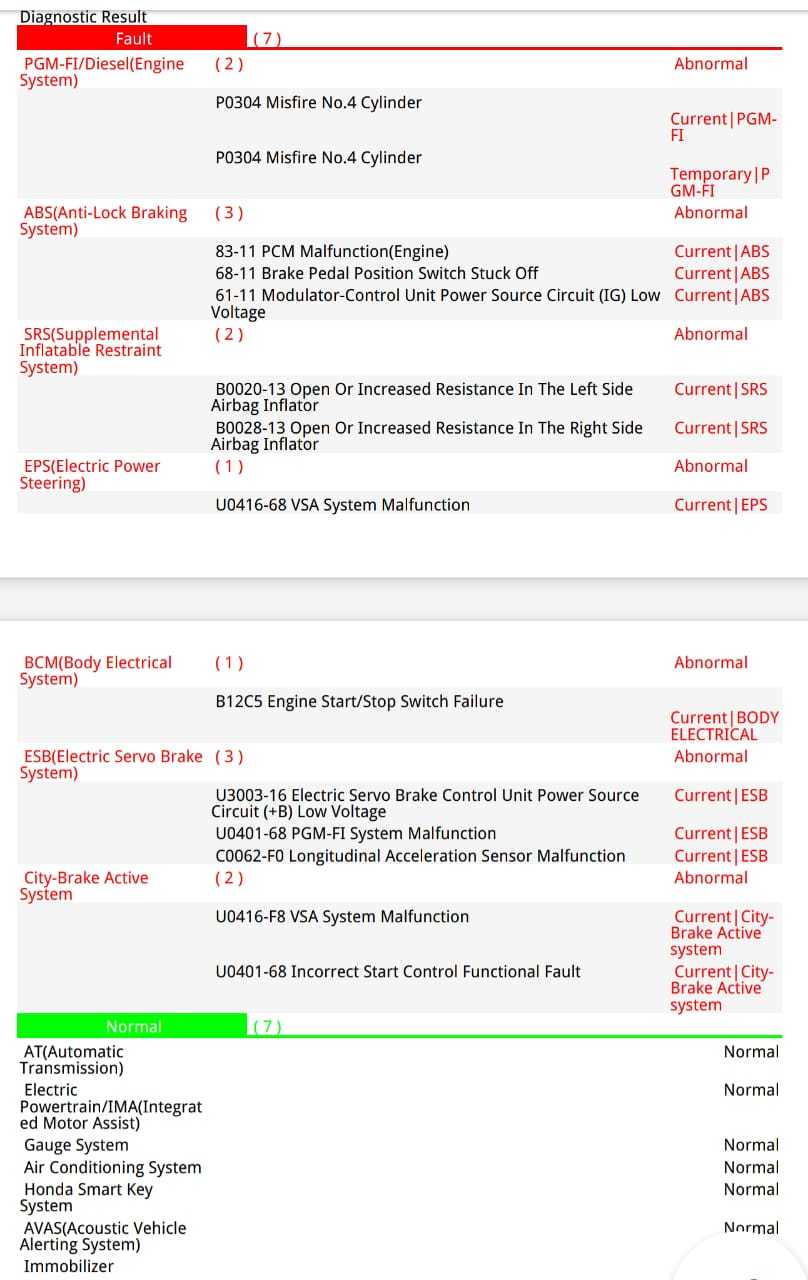

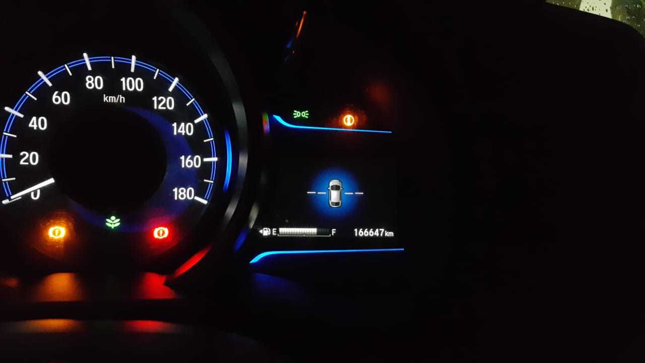

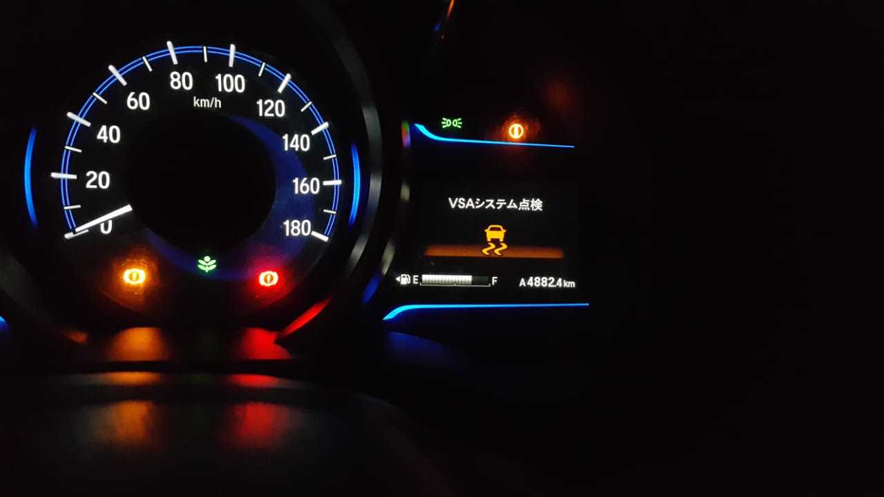

I bought a Honda fit 2013 Model (New Shape) 3 months ago. The car was okay for a month and showed no faults/error signs - But one day (it was a rainy day). I turned one the car and start driving the - it started beeping and was showing Engine check, Brake check, steering check etc. as shown in pictures. I consulted a friend and he said to reset it by removing the battery terminal. i removed positive battery terminal and connected back. The signs goes away for a week but it started coming back. did the same battery thing for a couple of times. Also i did oil change and routine tuning. But i won't go away permanently. I need a permanent solution for it. Also, The vehicle diagnostic report says 7 different errors.Further, While showing these symbols the car doesn't change to EV- engine is running continuously even in idle state. Without these signs, the car works normally.I have attached the pictures. Pls. Help. My Whatspp: 03235588058

Just one error remove in engine mis fire 4 slander automatically all lights off need to check coil spark plug fuel injector and tapit

I got the same issue a few days back and get it solved by replacing the plugs with the genuine NGK plugs and also replacing the injectors and now all the errors are gone Alhamdolillah.Anyone else having this problem might find it helpful.
