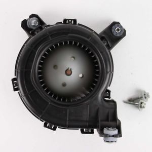

I have the same problems occured 3 months ago.There is battery blower fan located at back side digi.... your battery blower fan got short circuit.. Replace the battery bkower fan and this problem will be easily solved.

I had the same problem it usually occurs when the battery starts overheating because the fan has gone bad. Fan in defence in 16-24 thousand shersha 7-12 and megaZine line 7.5 -11
