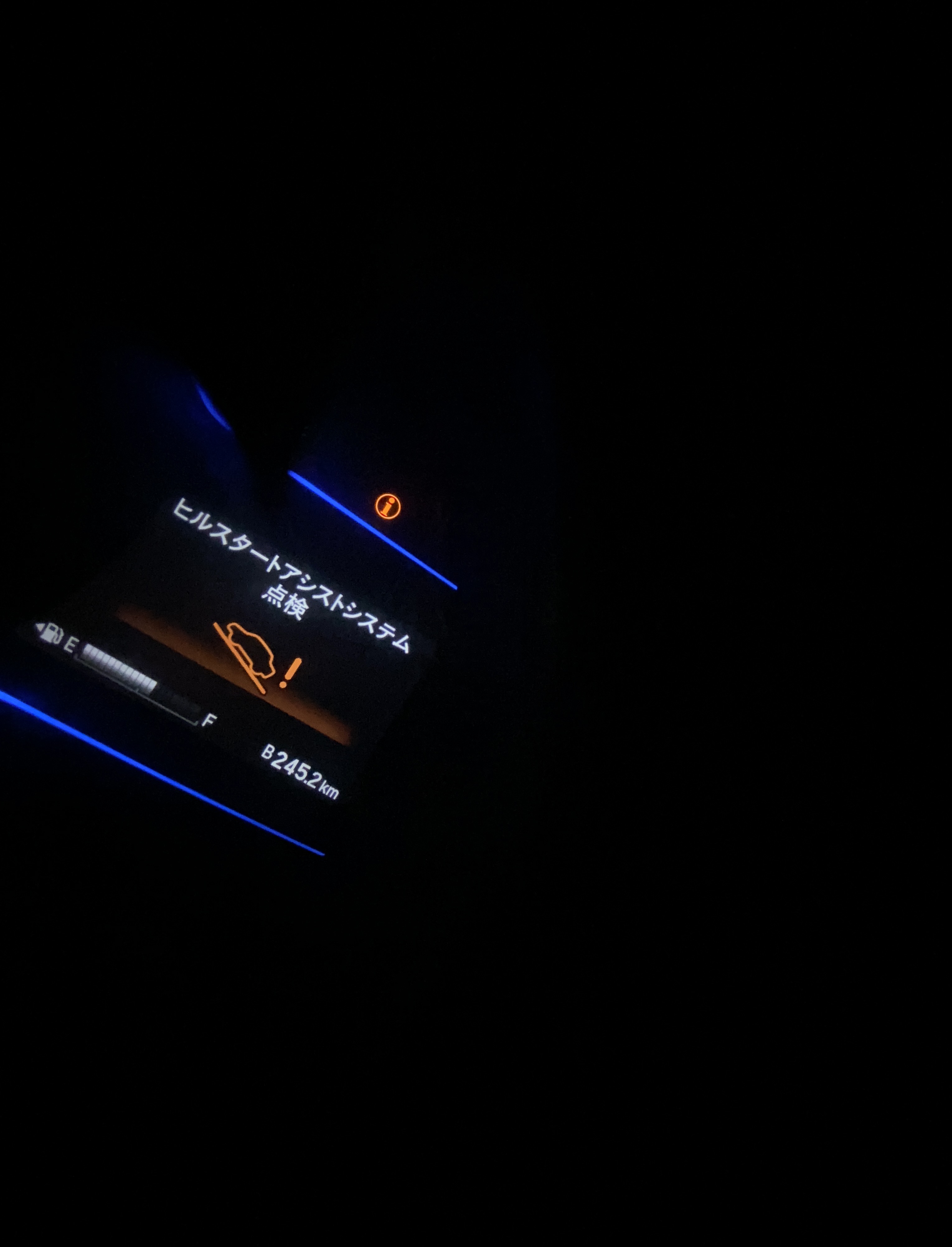

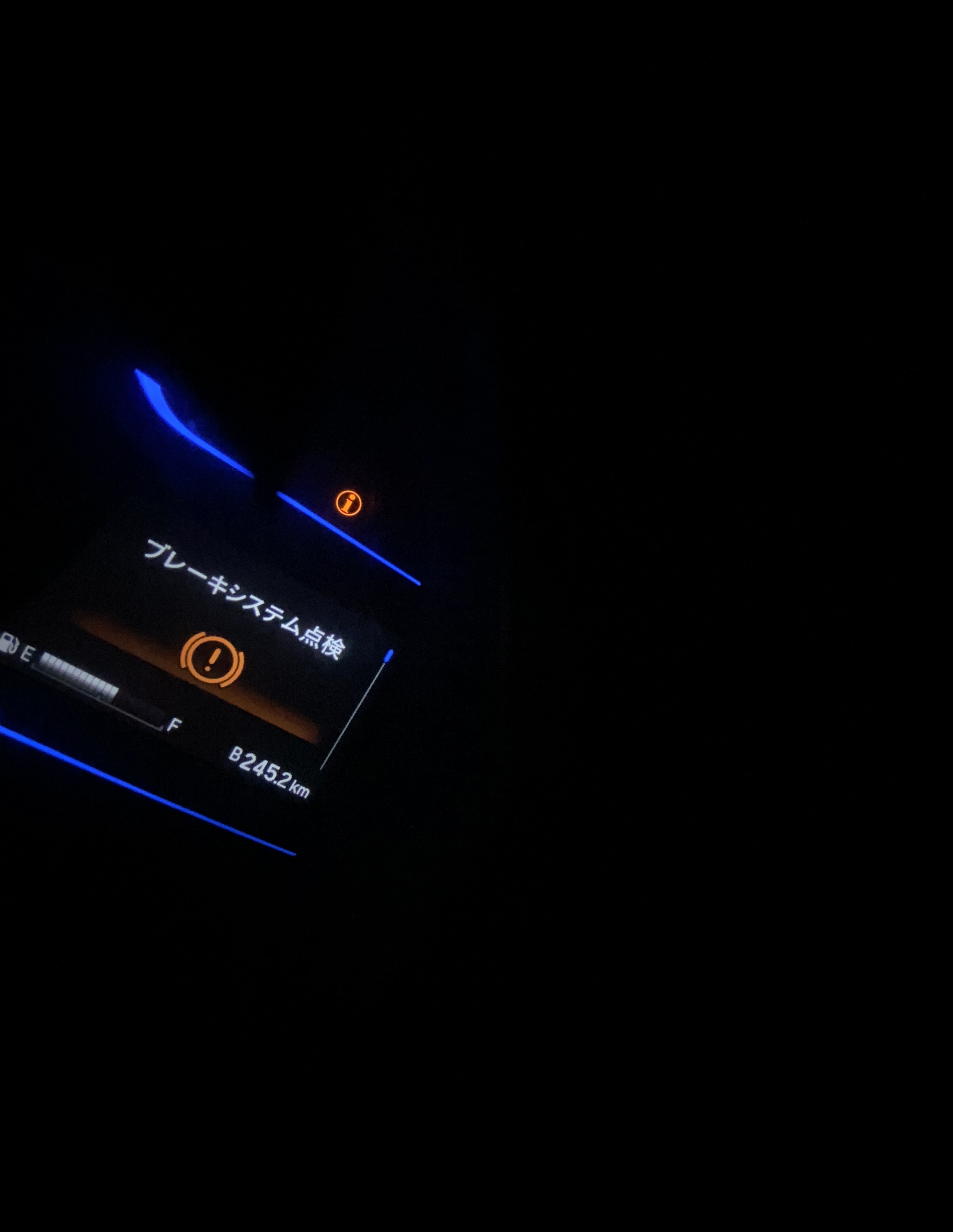

Not sure about the other codes, but the transmission issues are very common on this chassis for this year.
Honda had recalls for this as well. If you use the search, you will find multiple threads and information about this issue.

I would take your car to an expert mechanic who deals with these vehicles regularly and have them do a thorough inspection to see what's going on.
These dct units are dry clutch units. Not good for our climate and especially the type of city driving here. If we don't change our driving habits, they can heat up real quick.
