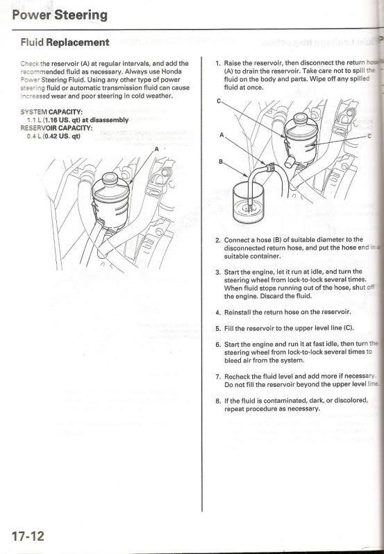

I am going through a very serious phase nowadays with my honda civic 2007. Last week when i was on my way to islamabad, its steering suddenly became extremely hard. I got a mechanic in islamabad and it was diagnosed as a power pump issue. I got the power pump changed and deive back around 200 kms. It was ok all around but suddenly i faced another issue. When the car is cold, the power steering works well. But as the time passes, you can say after the drive of about 35-40 minutes, suddenly steering gets stiff again. When i put my car on P, and accelerate it, the steering works fine again. But after stopping the accelration, it starts getting harder again.
Some body has told me to get the air removed from the system. And some body said its a power steering rack issue. Please guide me if anybody has faced the same issue or if some one can guide me about this problem.
