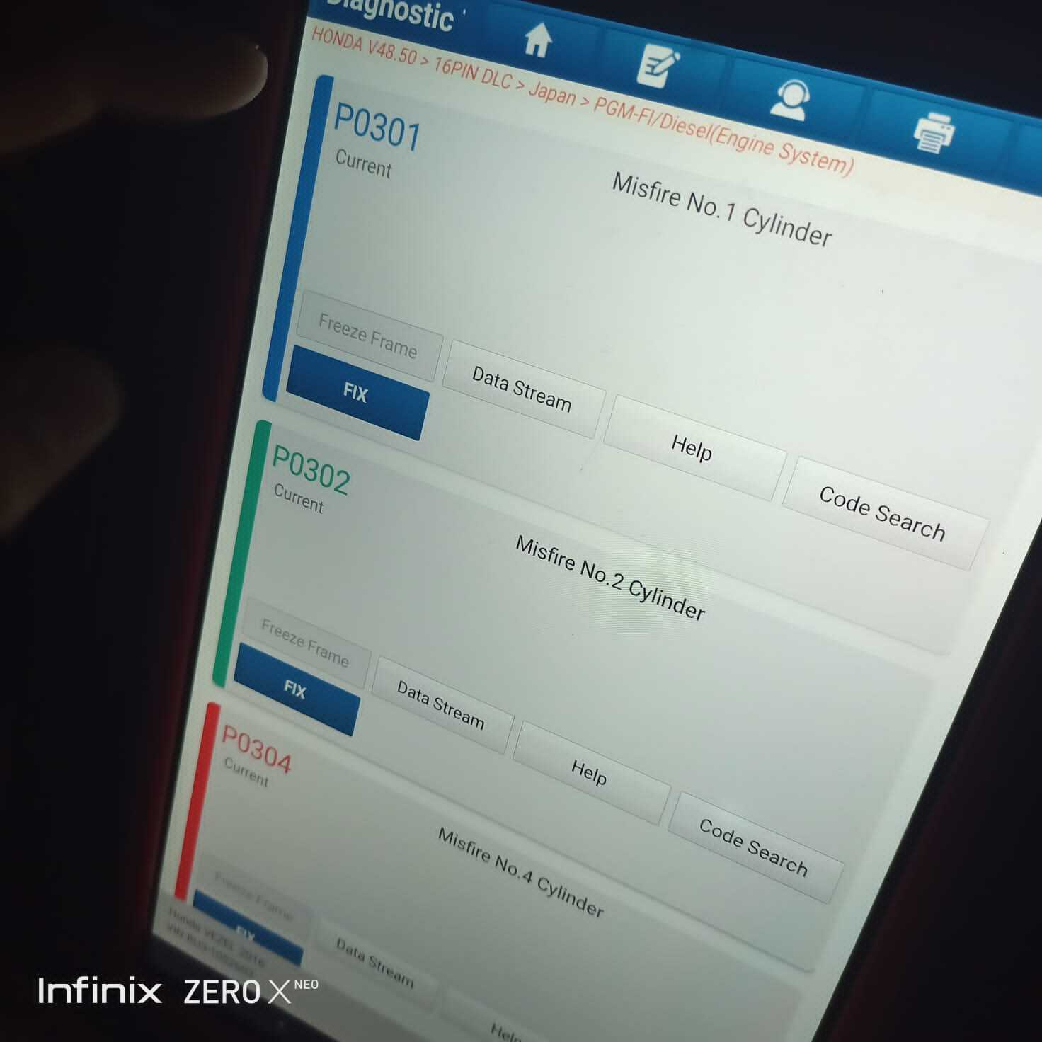

You need a deeper diagnosis, injectors clogging to the point of misfires will show a lot of other problems too.
What is the commanded duty cycle of the injectors at idle, fast idle and also driving?
Also test the AFR sensor output to see if it's not malfunctioning, cross check with the equivalence ratio to confirm.
Did someone try cleaning the catalytic converter or the exhaust sensors in the past?
