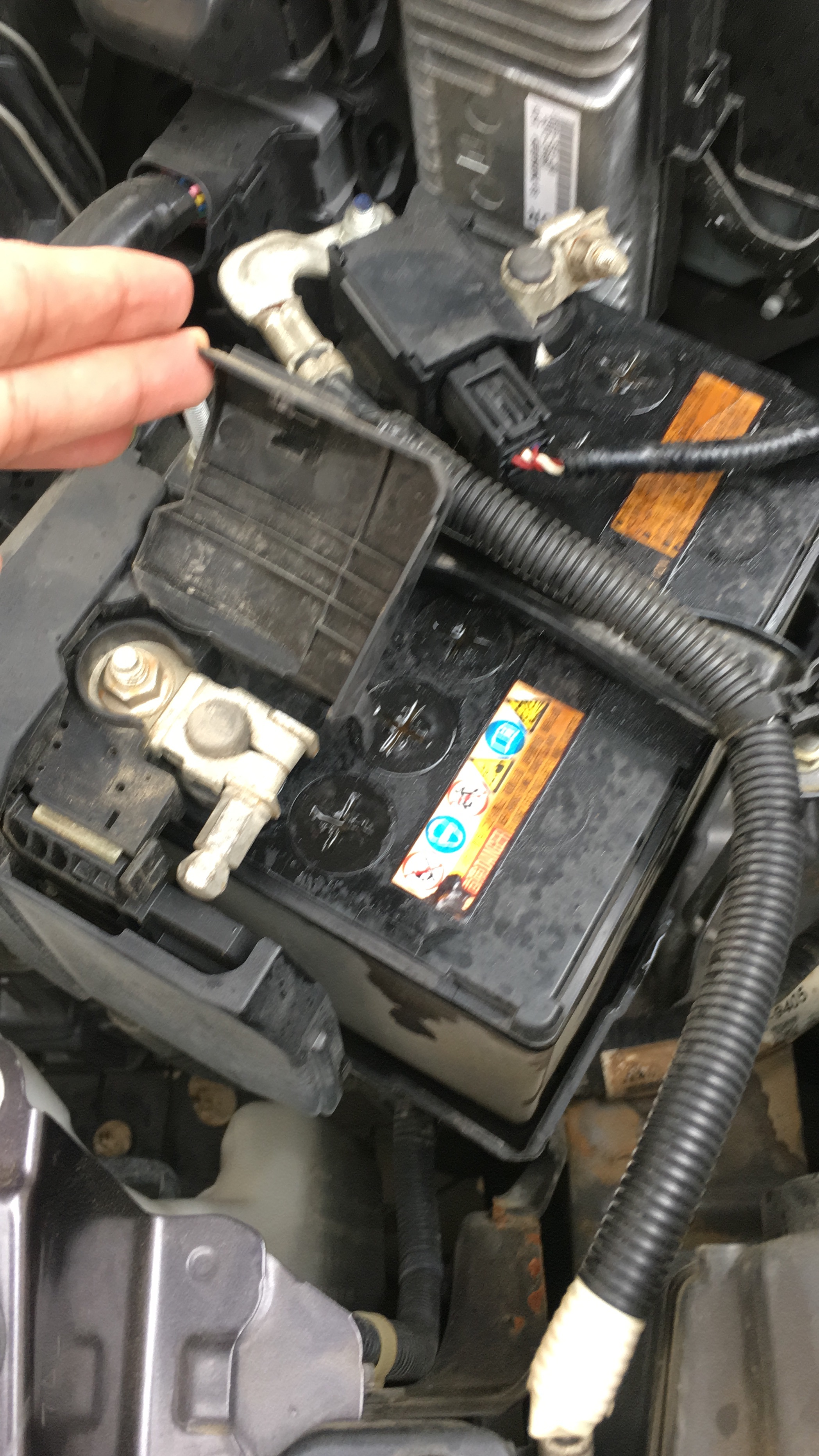

I have a Vezel and just today when I started it, it gave a lot of different lights on the dashboard. The lights went on and off, and it seemed like there was some issue. After a while I tried turning it on and off a couple of times and then the lights went off, but it kept giving a beep beep sound. A sign showed the power button and what I think (after translating it) a message about it going into accessory mode.
Now I know that if you press the power button without pressing the brakes it goes into accessory mode and if you press it again it goes into the normal mode but that does not happen. I tried checking the battery terminals but that did not help as well.
Any thoughts? I'm wondering if my battery is gone or if the battery terminals are disconnected from some place. It was also recently serviced from Honda. I cannot even tow it now as the handbrake is on. Any ideas?
I'll get my battery and my terminals checked from any local electrician, and if its a battery issue, I'll get a new dry AGS Battery.
