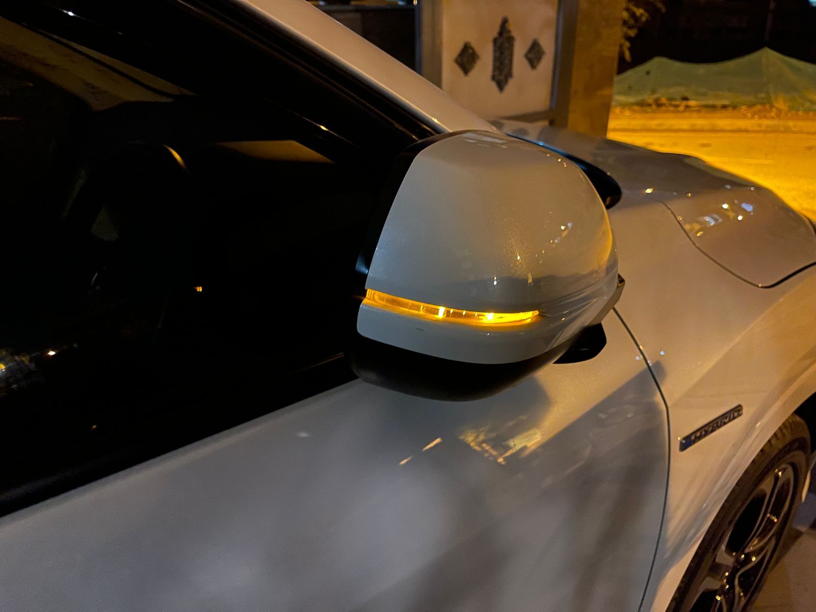

Hey guysI have a honda vezel 2016 z model. For some reason it s side mirror lights are not switching off even after I power off the car and lock it. can any one help regarding this issue?
did u try to dc 12v battery and reconnect
Thankyou but the problem has been solved.Turns out an earth wire was disconnected while changing the lcd panel.
