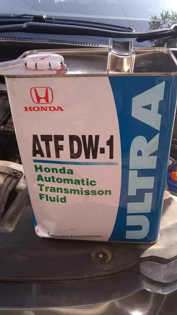

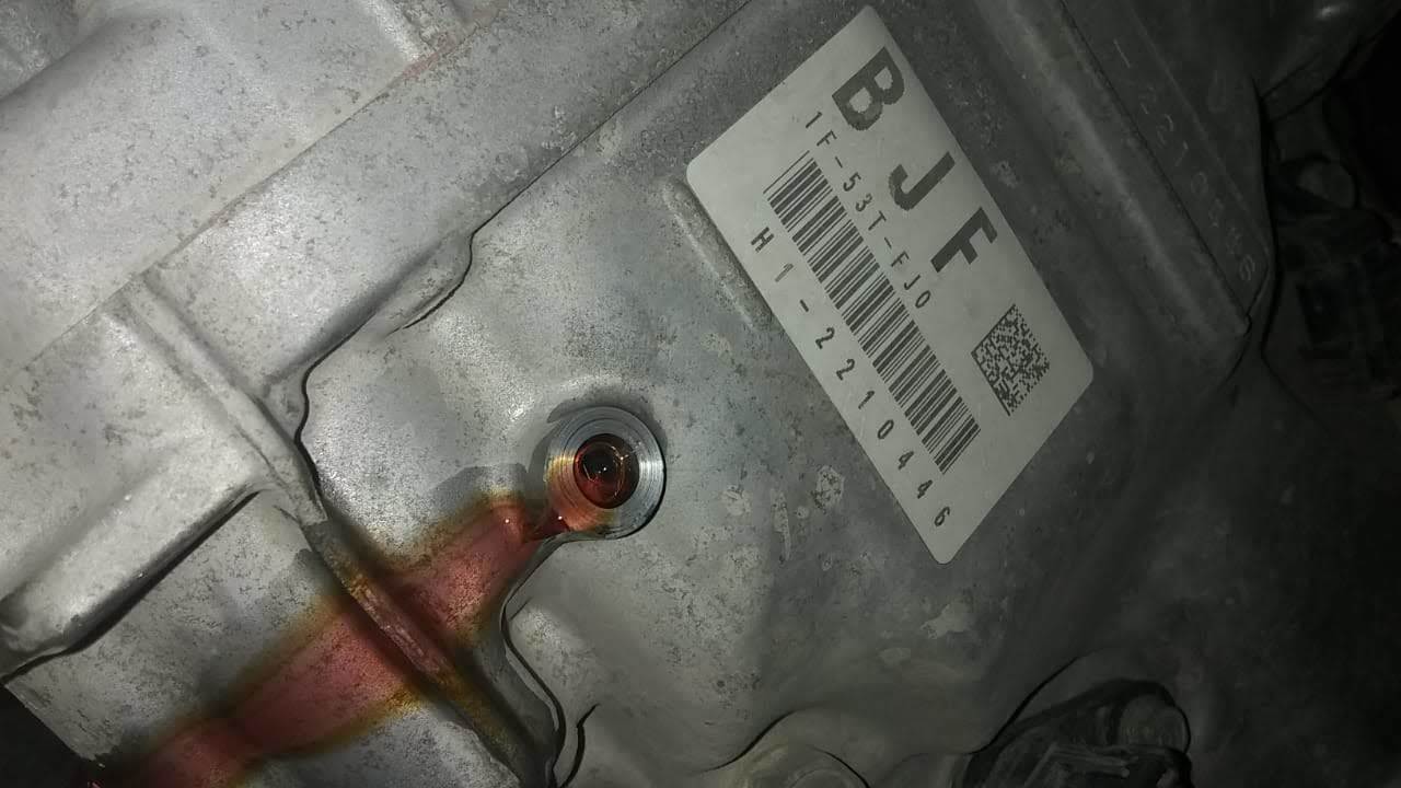

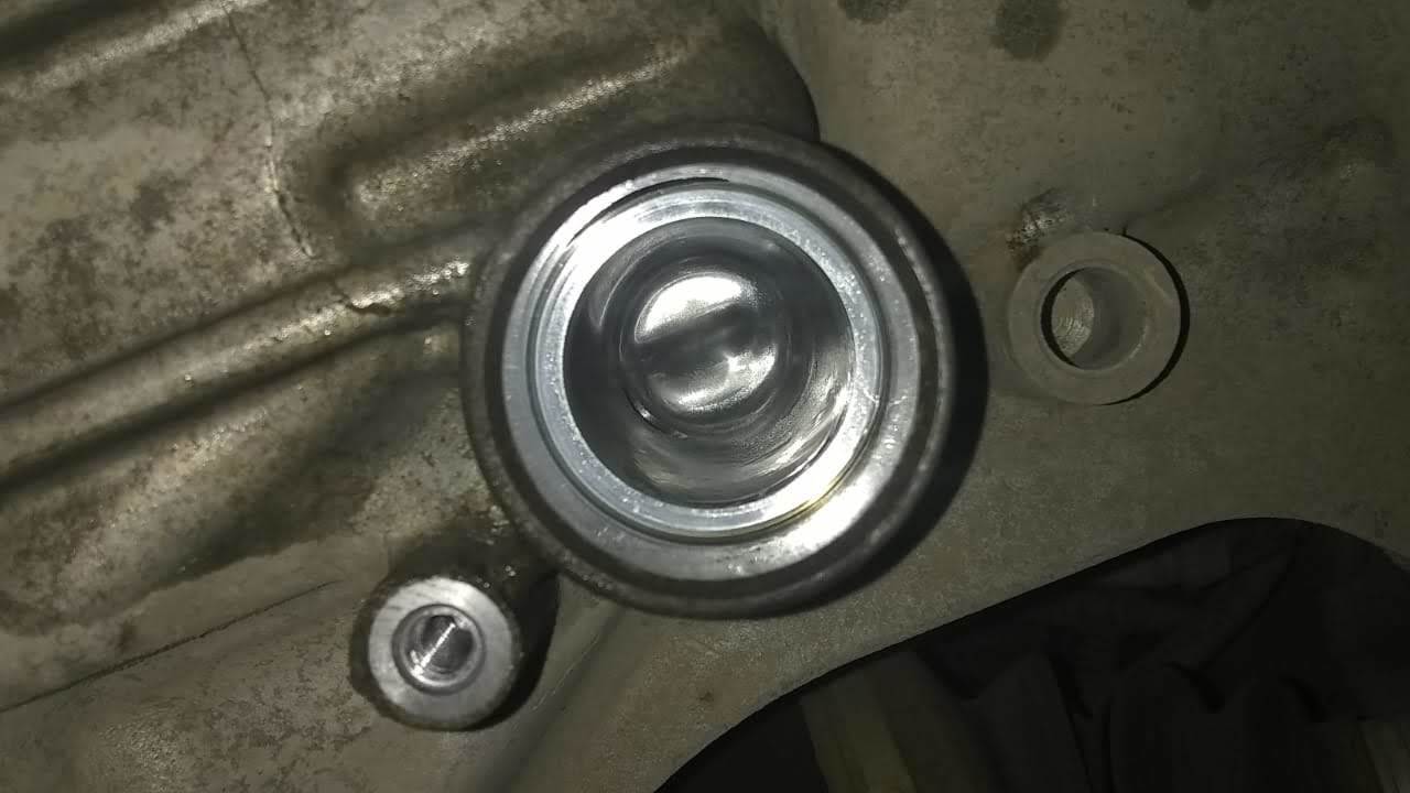

Honda OEM fluid was purchased by the owner., drain plug is under the vehicle it is ribbed plug with a filter, and over fill is on the axle side of transmission
The drained fluid was under 2 litres and poured in was 2.4 and it started to overflow. Pictures tell the whole story - it was done at Jameel Autos Karachi,
