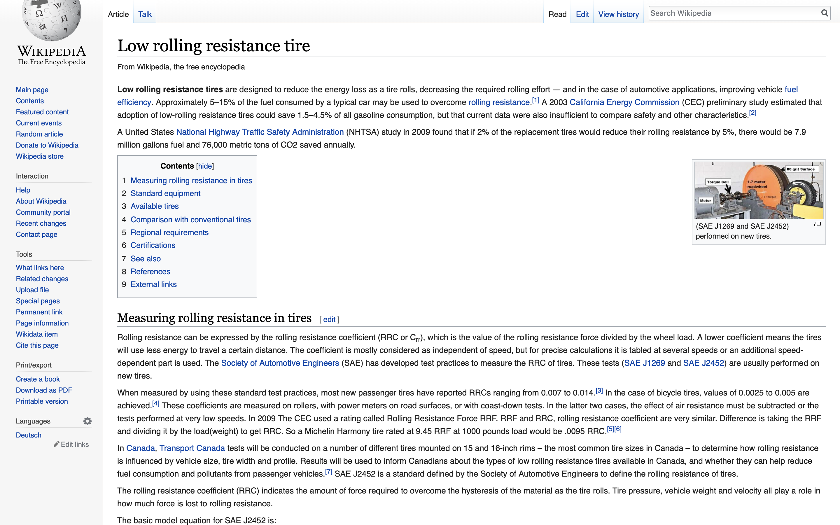

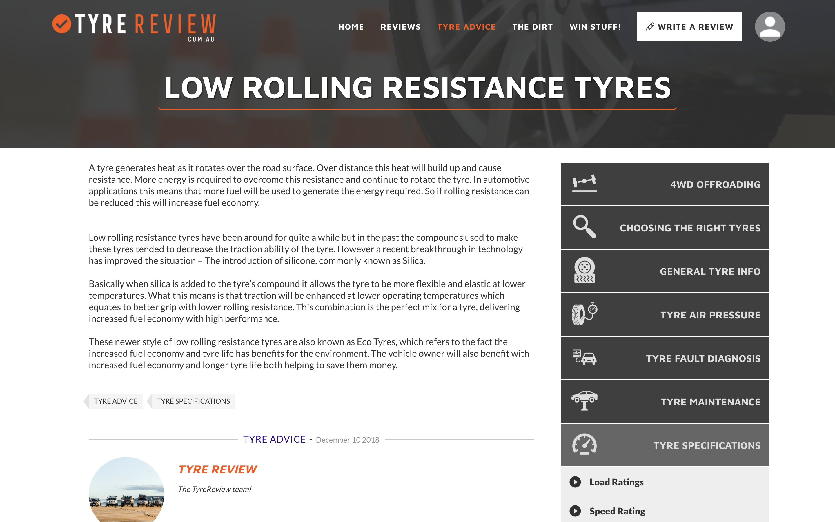

with reference to all other members feedback regarding 0w20 oil and low resistance tires etc all stand correct and should be followed to ensured maximum efficiency
