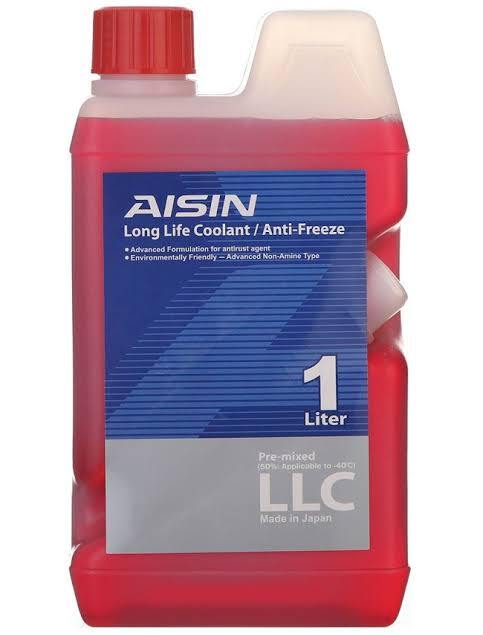

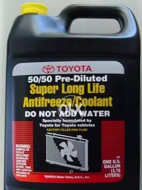

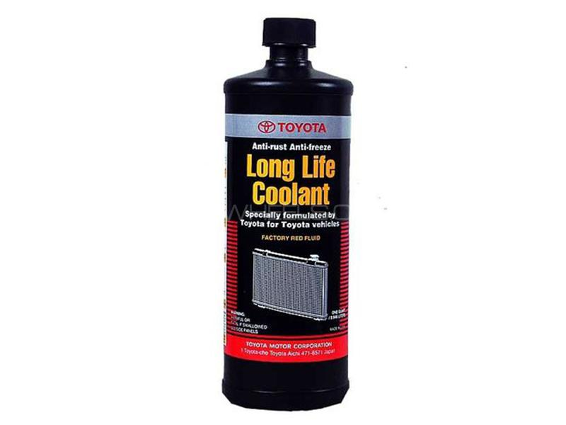

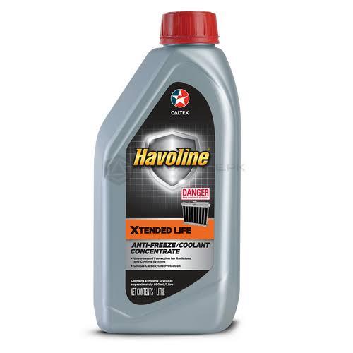

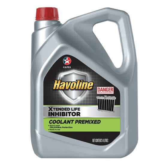

After that, use the new coolant and do air removal procedure. Continued...
