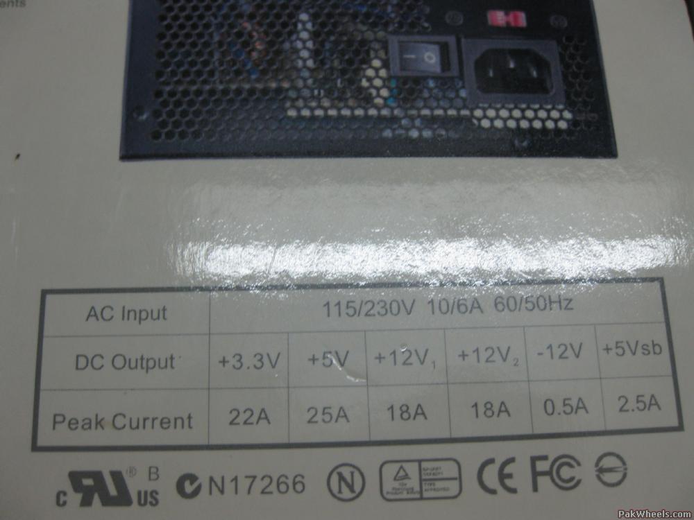

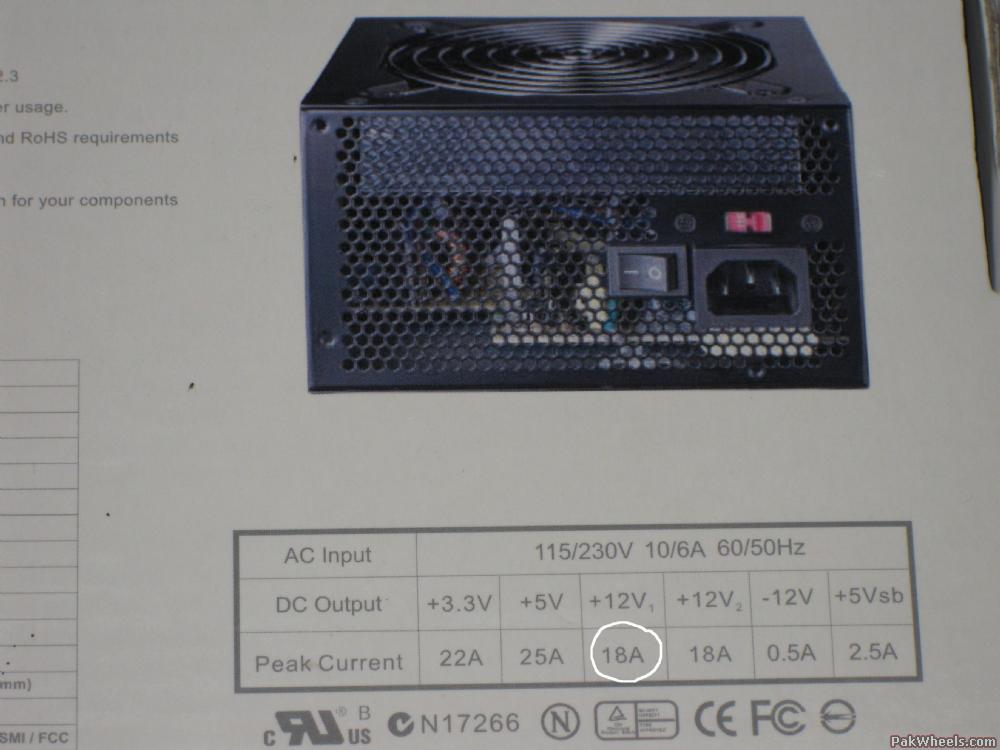

Luckily every PSU has a large sticker on the side listing its max current ratings in amps for each voltage rail. See the attached image for an example. You're concerned with the +12V section. First find the max wattage rating of your amp. Let's say it's a 300 Watt amp. Now divide that by 12 as in 12 volts and you get 25 amps. So at 12 volts it needs 25 amps to reach max power. The example attached to this step wouldn't be sufficient with its pathetic 18 amp peak power. It's so low because they split the normal 12 volt rail into two. Most modern power supplies can supply 20+ amps at 12 volts. If you have a 600 watt amp, you're probably not going to find a power supply that can supply 50 amps for it.
i I have a cooler master supply of 460watts so it is useless to run my 300watts solid audio amp becouse
300/12=25ampere and my supply is capable of providing 18A so its [MOD EDIT] !
