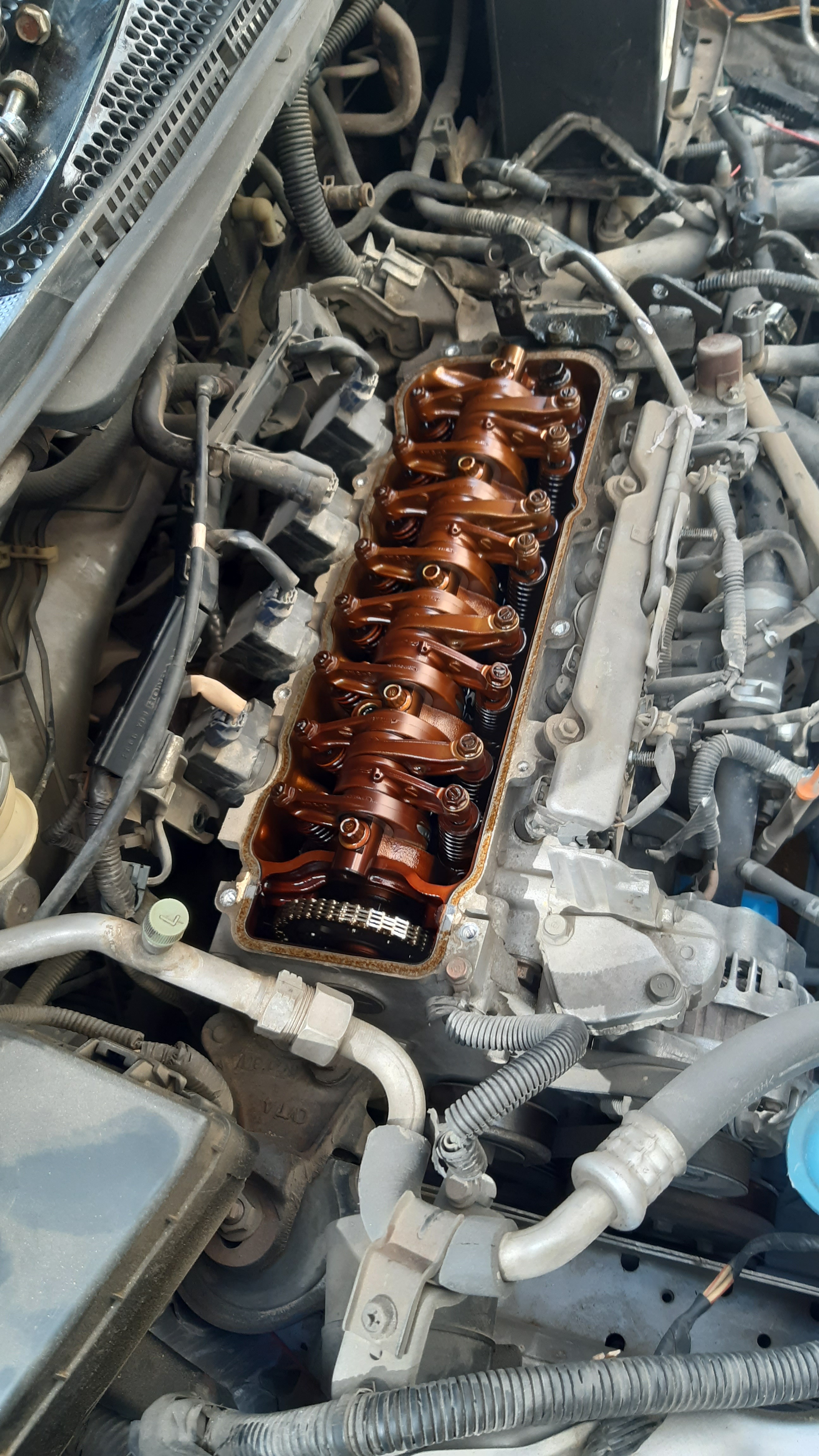

the engine is only moved from the crank bolt.

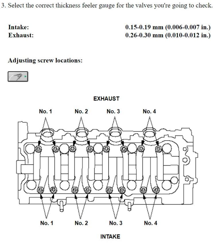

but its critical to ensure the engine is stopped at the correct timing to check and adjust valve lash - if its stopped at the wrong timing because mechanic was looking at the cam lobe from a skewed angle - the clearances wont be correct.
the calculation is very simple. - its a 4 stroke engine meaning 720 degrees of crank is one complete power cycle of engine. Its a 4 cyl so divide 720/4 and you get 180 degrees.
your firing order is 1342
meaning TDC mark on crank is used to set cyl1 - (verify engine is at compression stroke and not exhaust).
now rotate crank exactly 180 degrees forwards and set cyl 3
then another 180 degrees (again TDC mark) and set cyl4
rotate another 180 degrees and set cyl 2
job done!
