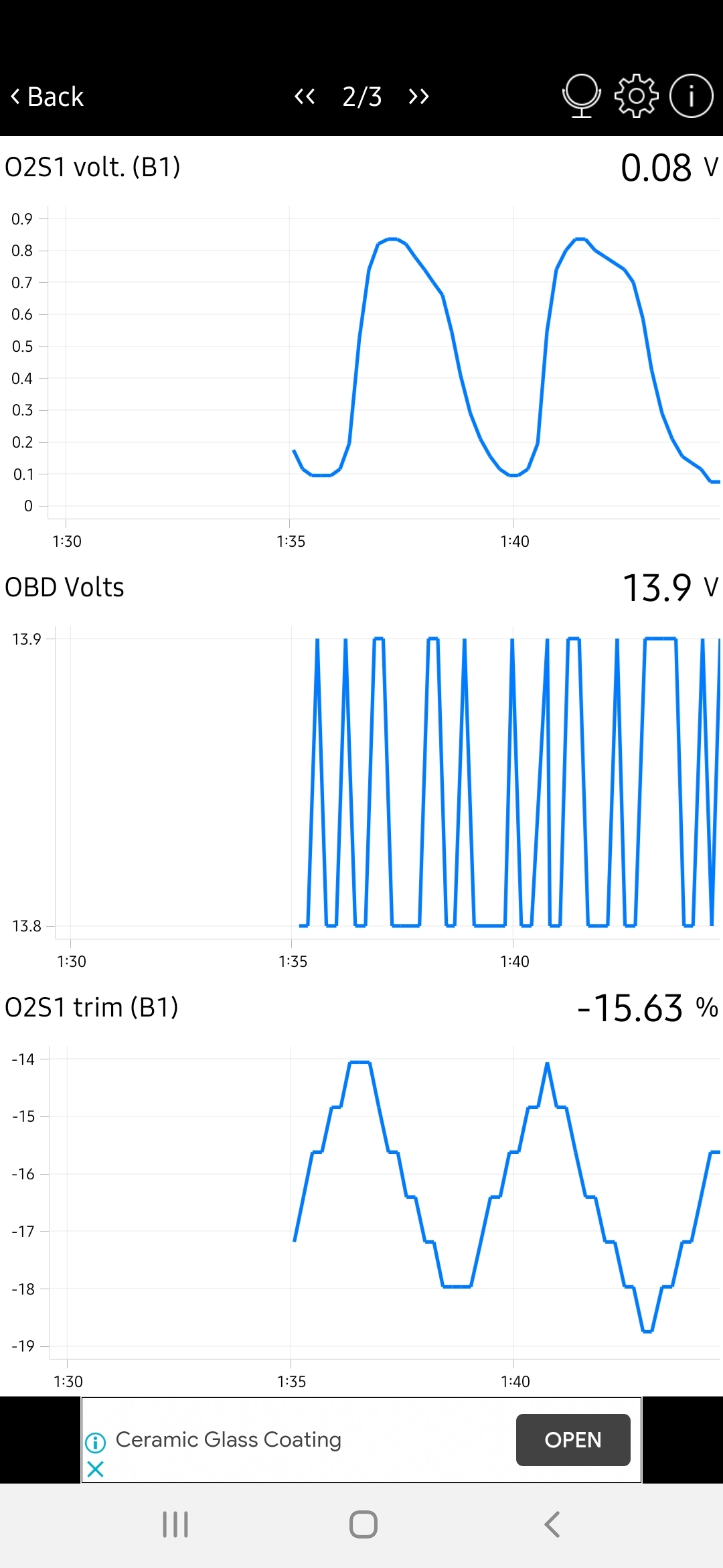

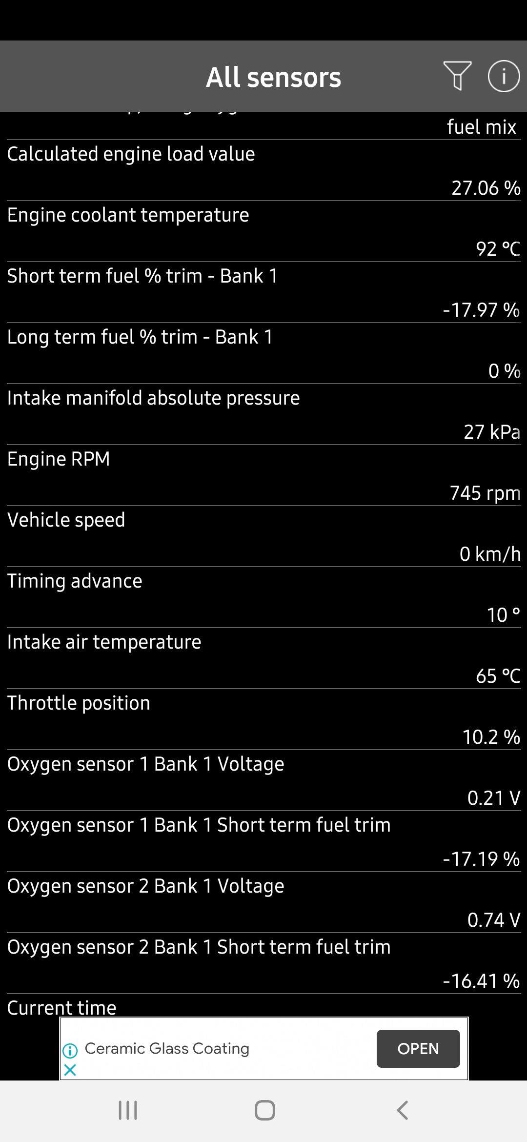

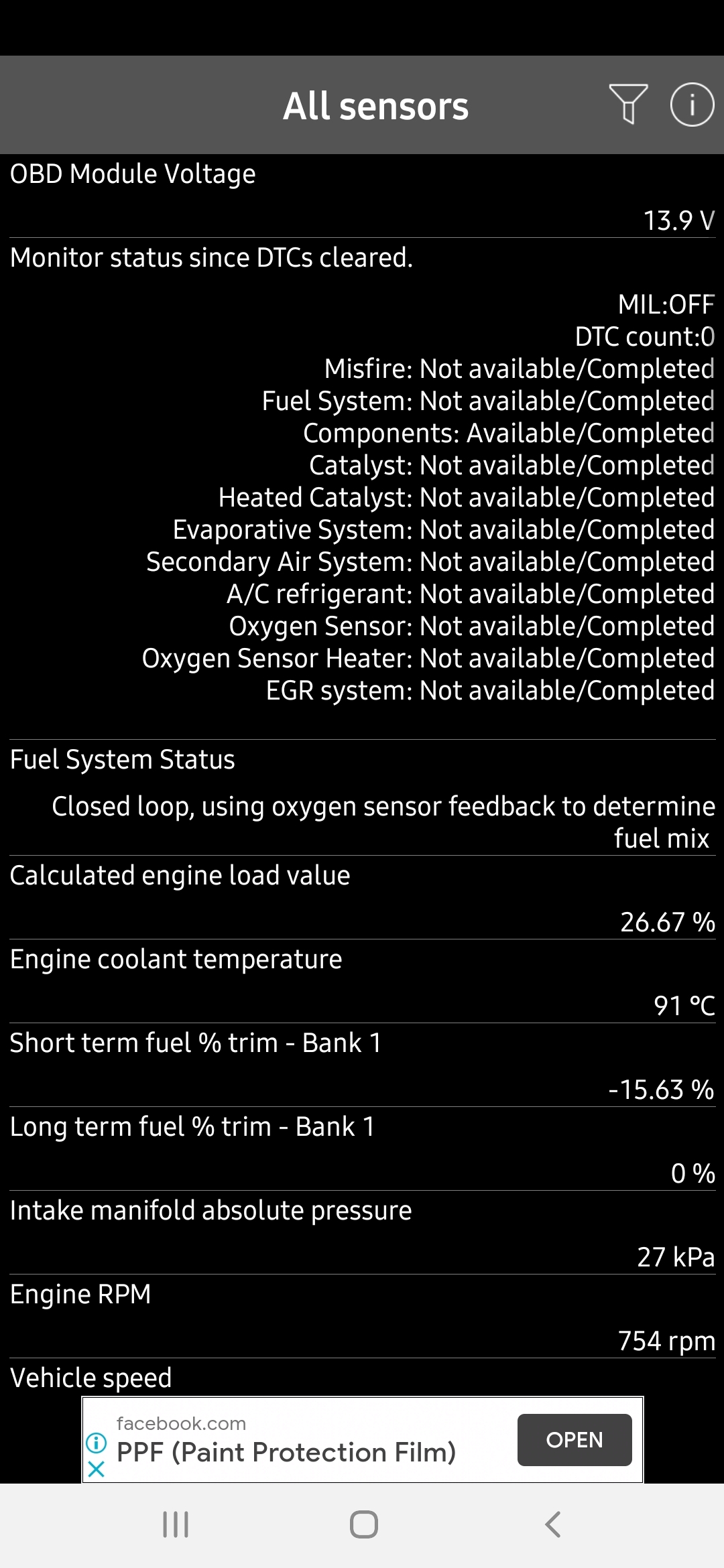

Don't adjust fuel trim. You don't need to unless you have already messed other stuff up.

So while on ACC mode, connect a scanner, read TP sensor values, with WOT it should read exactly at 0.49V. If it does, don't mess it up. And ya, I hate this model's IACV (idle air control valve), it sticks a lot. I used to clean it every couple of months. If by turning on AC and pressing the throttle a bit and then releasing it the RPMs drop, you gotta clean the IACV but I'd suggest you can get a good Throttle body for rs1500 very easily that has never been opened or dis-assembled before, get that, clean it and install it.
