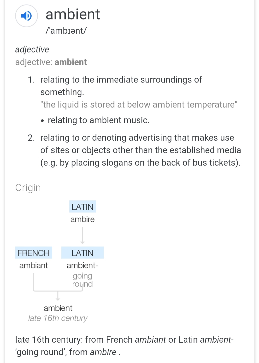

What do mean by ambient temperature? I am in Islamabad. Here now a days temperature is below 15 C in the morning and evening.

LOL, not asking meaning. Anyway, Thanks for your replies.
