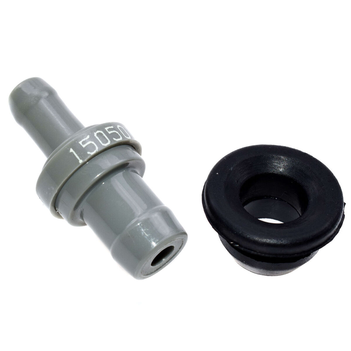

The thing has happened. This time after 3-4 weeks. Which is quite concerning. The blow valve image is attached. There are oil deposits around it and it isn't choked.
Ur valve cover is missing the rubber grommet for the pcv valve
So is that the problem?
Yeah the rubber needs to be there
I've cleaned the pcv valve thoroughly with carb. Cleaner and dried and then plugged in and then will observe the result.
I checked today that the rubber grommet is there it's just darker so it didn't look like it was there
The problem is solved till now, I hope it stays like this. Thanks for your cooperation and help. Thanks
