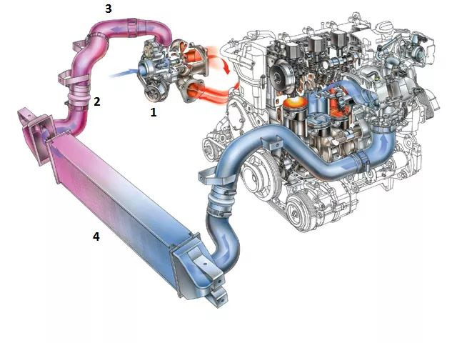

An intercooler is a mechanical device used to cool the intake air on engines fitted with a forced induction (either a turbocharger or a supercharger) system.
What does an intercooler do?
The intercooler’s job is to cool down the air after it has been compressed by the turbo or supercharger, but before it enters the engine.
How does an intercooler work?
Turbochargers work by compressing air, increasing its density before it reaches the cylinders of the engine. By squeezing more air into each cylinder, the engine is able to burn proportionally more fuel, creating more power with each explosion.
This compressing process generates a lot of heat, and increases the temperature of the air entering the engine. Unfortunately, as air gets hotter, it also becomes less dense, reducing the amount of oxygen available in each cylinder and impacting on performance!
The intercooler works to counteract this process, cooling the compressed air to provide the engine with more oxygen, and improving the combustion in each cylinder. In addition, by regulating the temperature of the air, it also increases the reliability of the engine, by ensuring the air to fuel ratio in each cylinder is maintained at a safe level.
