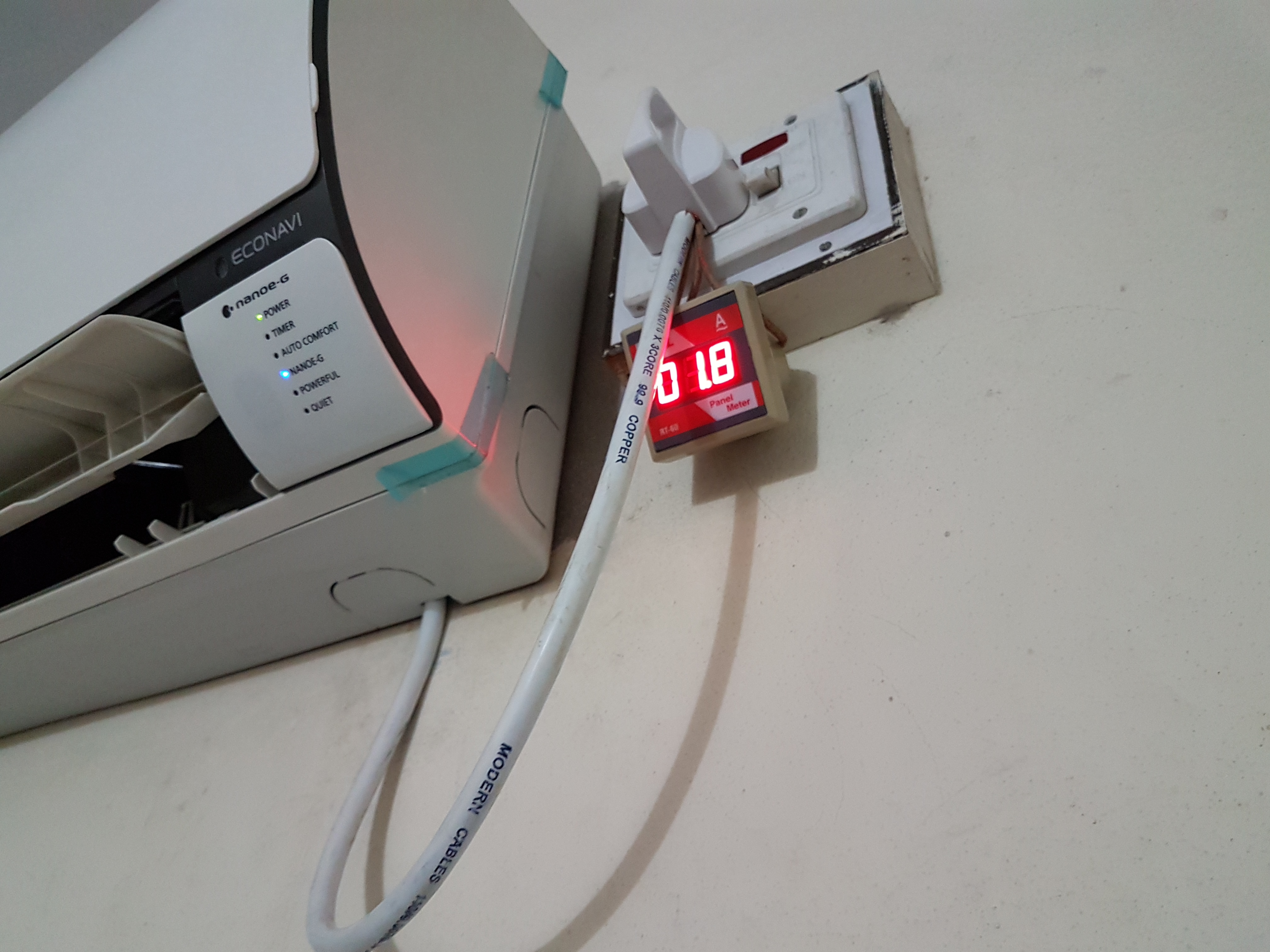

I am satisfied with the performance. It cools the room down like any non-inverter. If we set on 26c it takes about 15-60 mins to cool the room down depending on how hot it was. Normal operating amps are 6-8 @ 200 volts.
After achieving the desired temperature amps comes down to 2-5 amps depending on temperature set. I have done extensive testing on different temperatures from 22 to 28.
If I set the desired temperature at 26c, it keeps it at 25c and stays between 3-4 amps.
If I set the desired temperature at 28c, it keeps it at 26-27c and stays between 2.5-3.5 amps.
So unlike Panasonic people are complaining about, it keeps the temperature at least 1 degree lower than the set temperature. I set it to 26c when I go to bed and 2-3 hours later I turn it up to 27-28 as I feel cold even under the blanket.
The turbo mode is pretty good. I tested for peak amp by setting turbo on 22c. It goes up to 2300 watts as mentioned in specs.
Usually when I set to 26c the amps stay around 6-8 most the time, then comes down to 3-4 amps. If I put it on turbo at 26c it goes up to 9-10 amps and then come back to 3-4 amps.
So the compressor is fully automatic, it calculates how hot the room is and how cool it needs to be and figure out how much power it will use.
