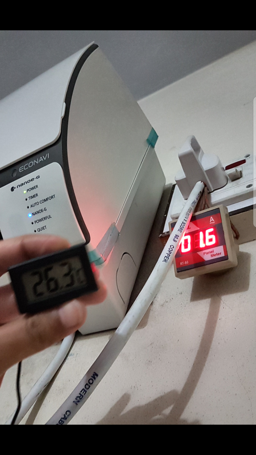

I slept after this and today in morning when I woke up after 8 hours I took this pic. There is no Sleep/economy mode activated but somehow Inverter likes to raise room temp by 1.5 C in morming the final temp was 26.3 C and final minimum power/wattage only 1.6 amp (350 watt approx). Cant call it weak performance still is quite strong. Energy saving is great. It seems you have to set temp at Minus 1 degree from the value you want to achieve throughout the operation. If you want 27 C u need 26 dialed in and if you want 26 C u need 25 dialed in on remote.
