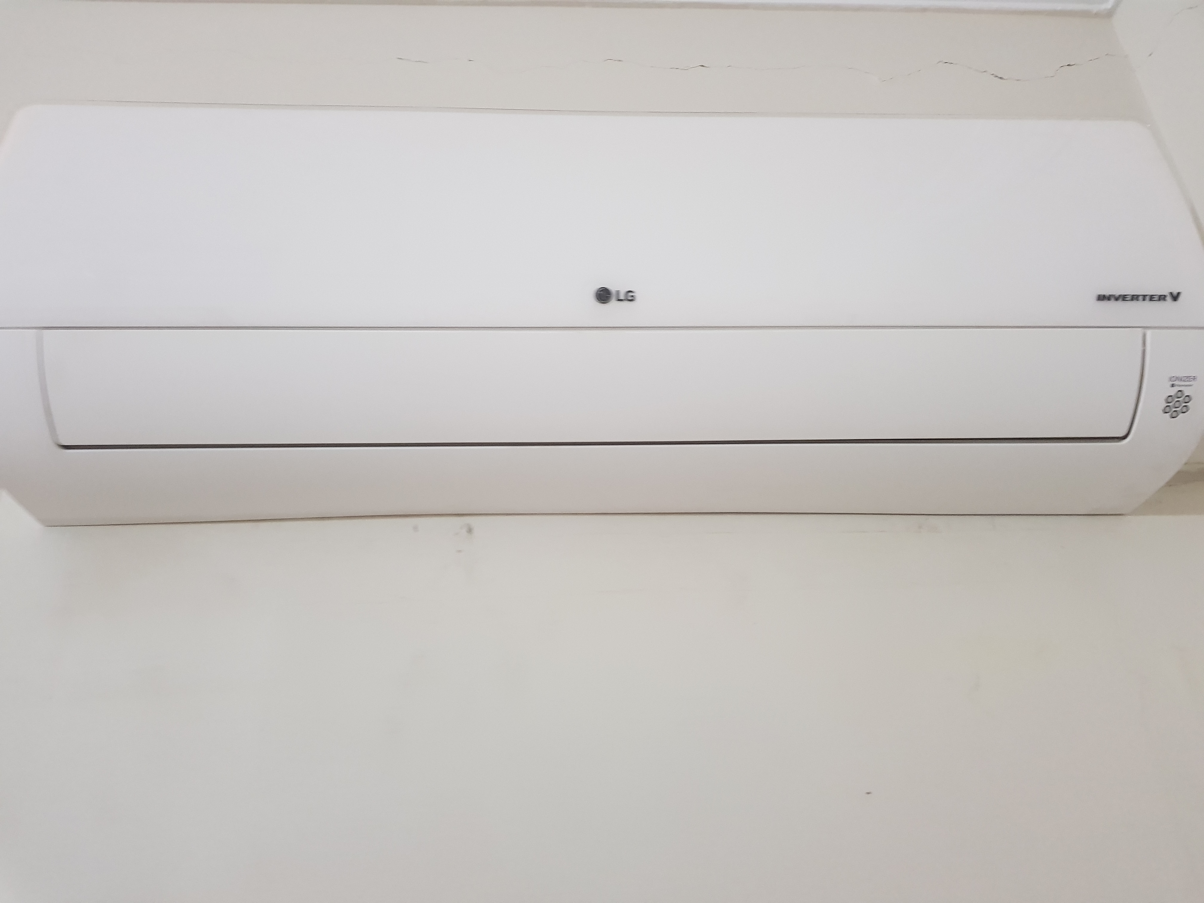

I was doing research for a new a new conventional AC. I thought why not go for a good brand this time. I looked into LG, Samsung and Panasonic; Daikin is overpriced in my opinion.
Any way, I thought these brand are expensive but they surely would be better value for money as they must be more energy efficient or work better in some way.

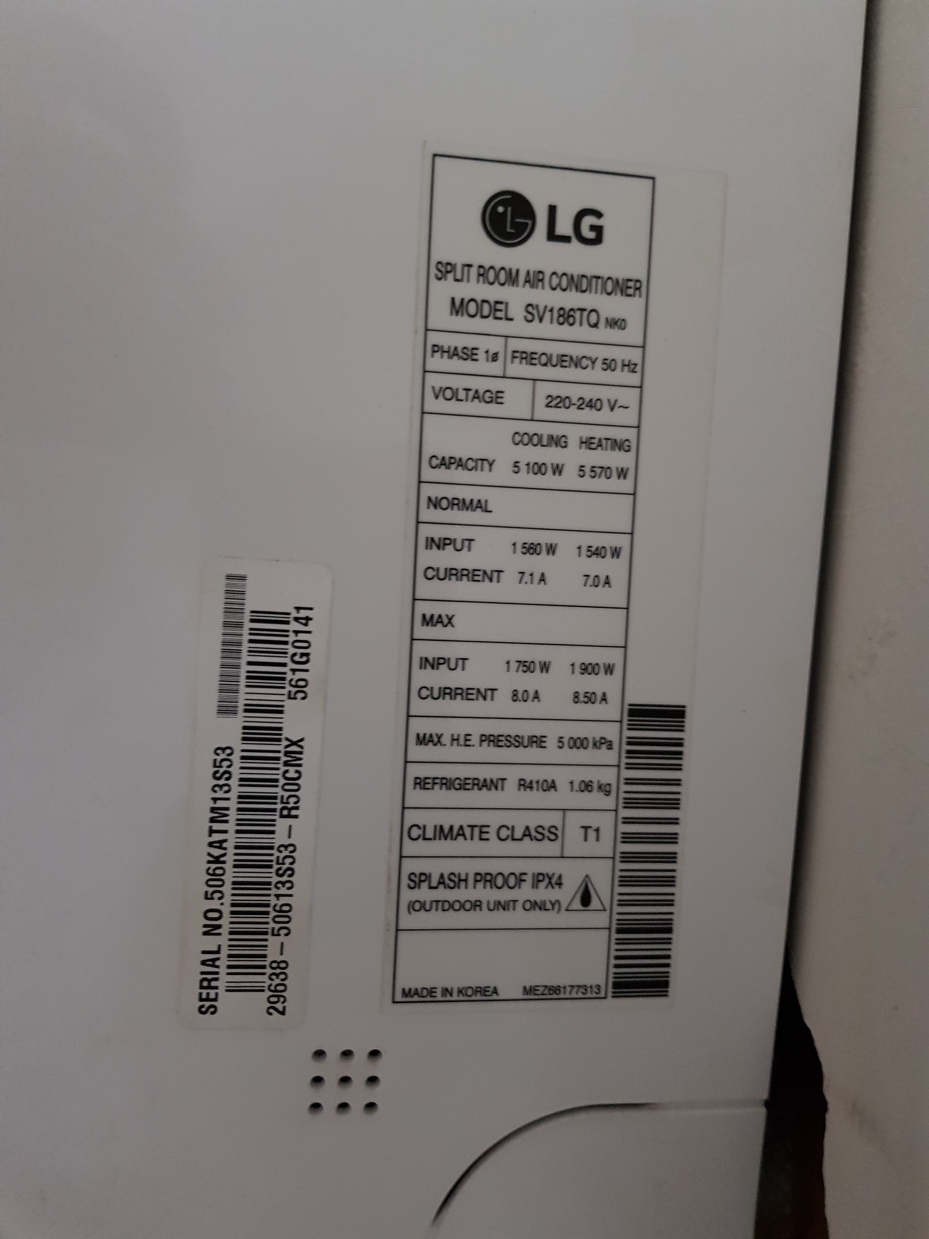

I was surprised to find out power rating of one LG 1.5 ton unit at 2090 watts and a Samsung at 1900 watts. So I thought may be they do more cooling compared to what I have a GREE Lomo. I did some research online as to how cool the air should be blowing out of the AC. I found out that it should be 15-20F lower than what it's sucking in.
