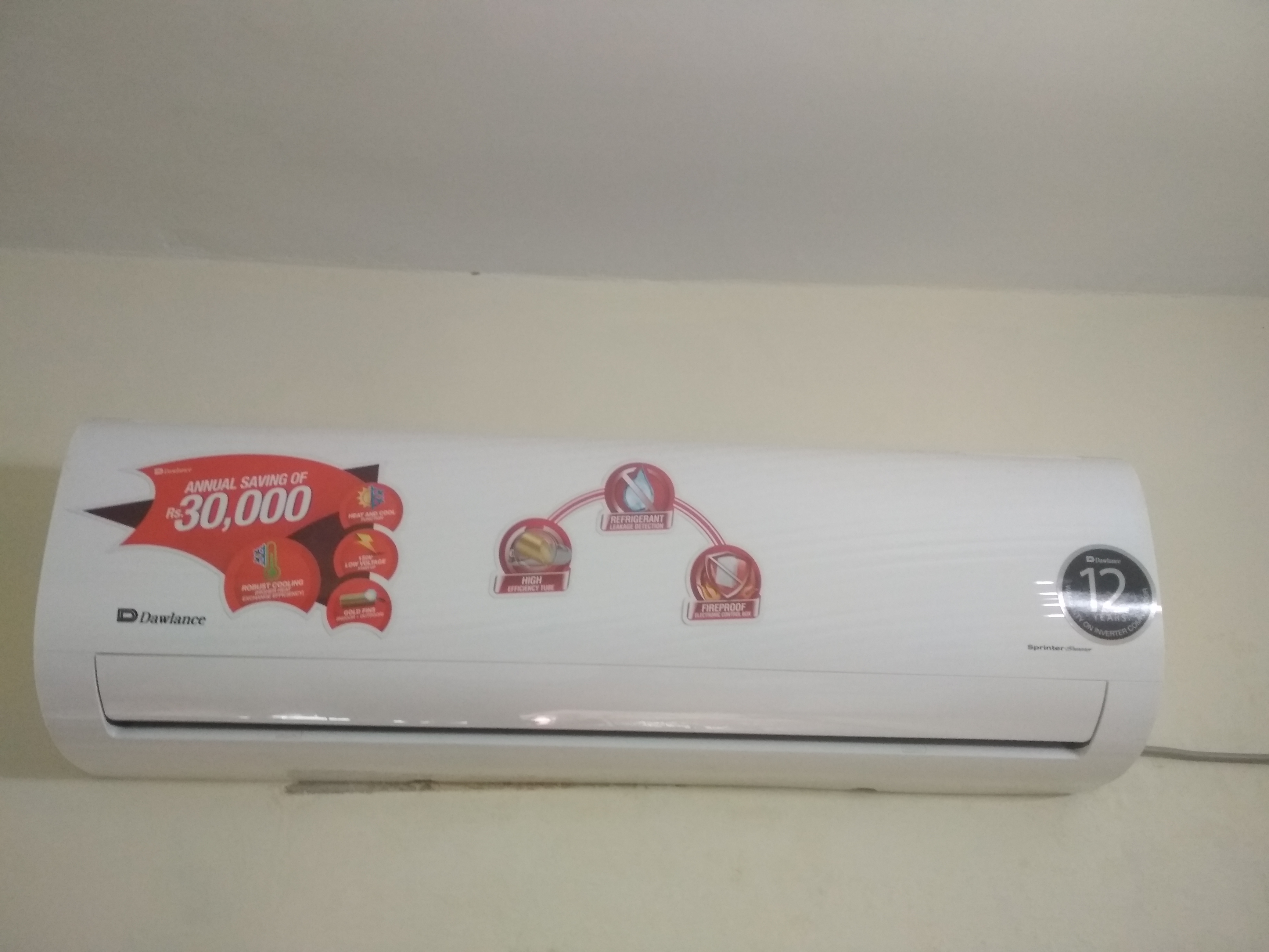

Just to clarify, there used to be an electrician who had a shop nearby my home, the 14 years ago Dawlance was installed and serviced by him and that time i didn't know anything about vacuum pump (i was 16 that time) but i remember he always brought a pump with him. So there are always people who go by books and provide quality work and then there are those who are jugarri baz.
