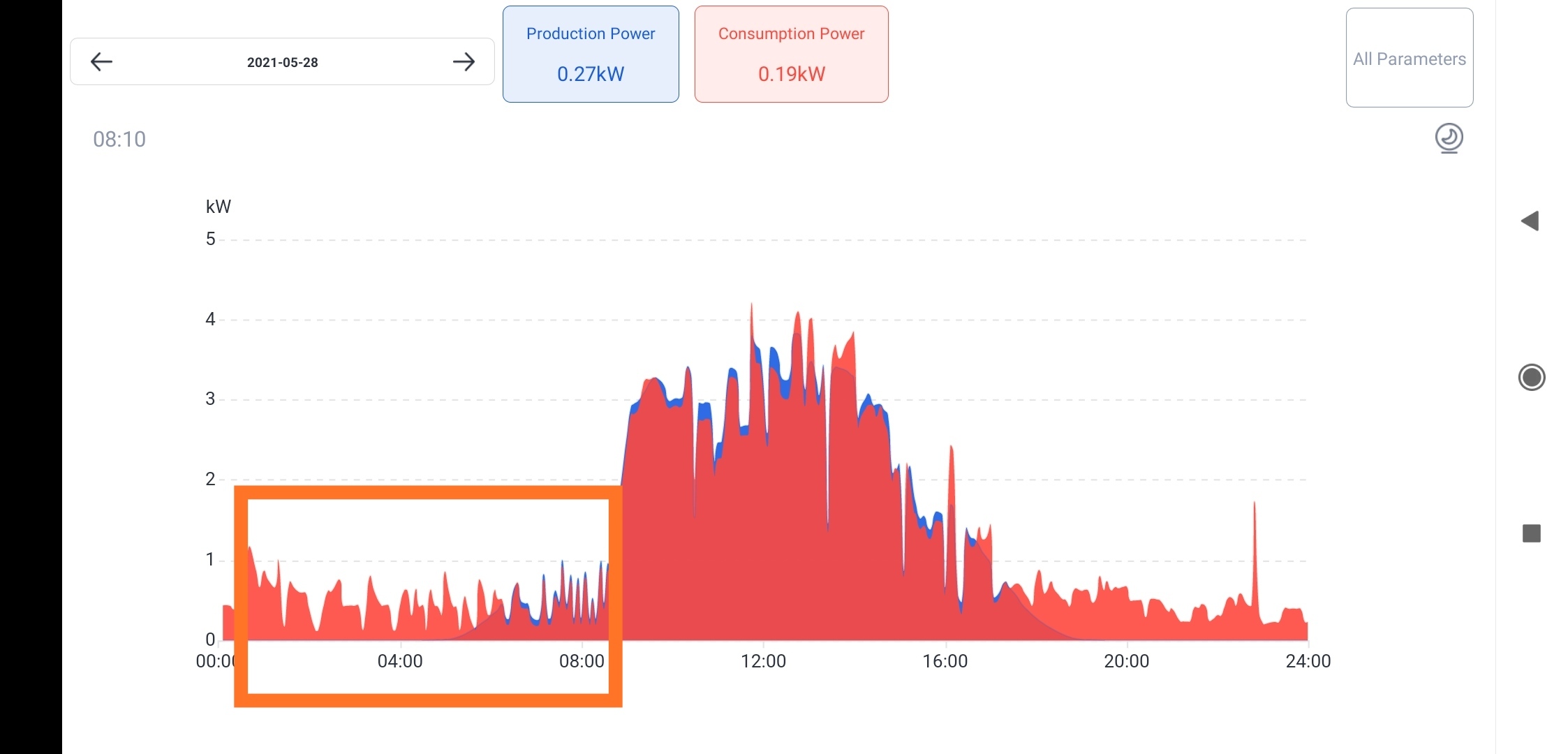

Now to performance. Since my room is small (123sqft) and undersized for 1.5 ton,it cooled the room within 5 min.Temp was set at 28. Ambient temp of room was 34-35. I checked vent temp it reached 10c and touched 9c for 1 min.
Max amp were 10. After 15-20 min the amps went down to 2.5. After 1 hour it went down to 1.9 to 2 amps.
Air throw is quite good. Outdoor is completely silent, just a minor humm. Coming from noninverter, i was surprised with the sound of outdoor. Everything copper. Overall ac quality is good. Only if the installation part is done according to standard process it could last for a long time.
