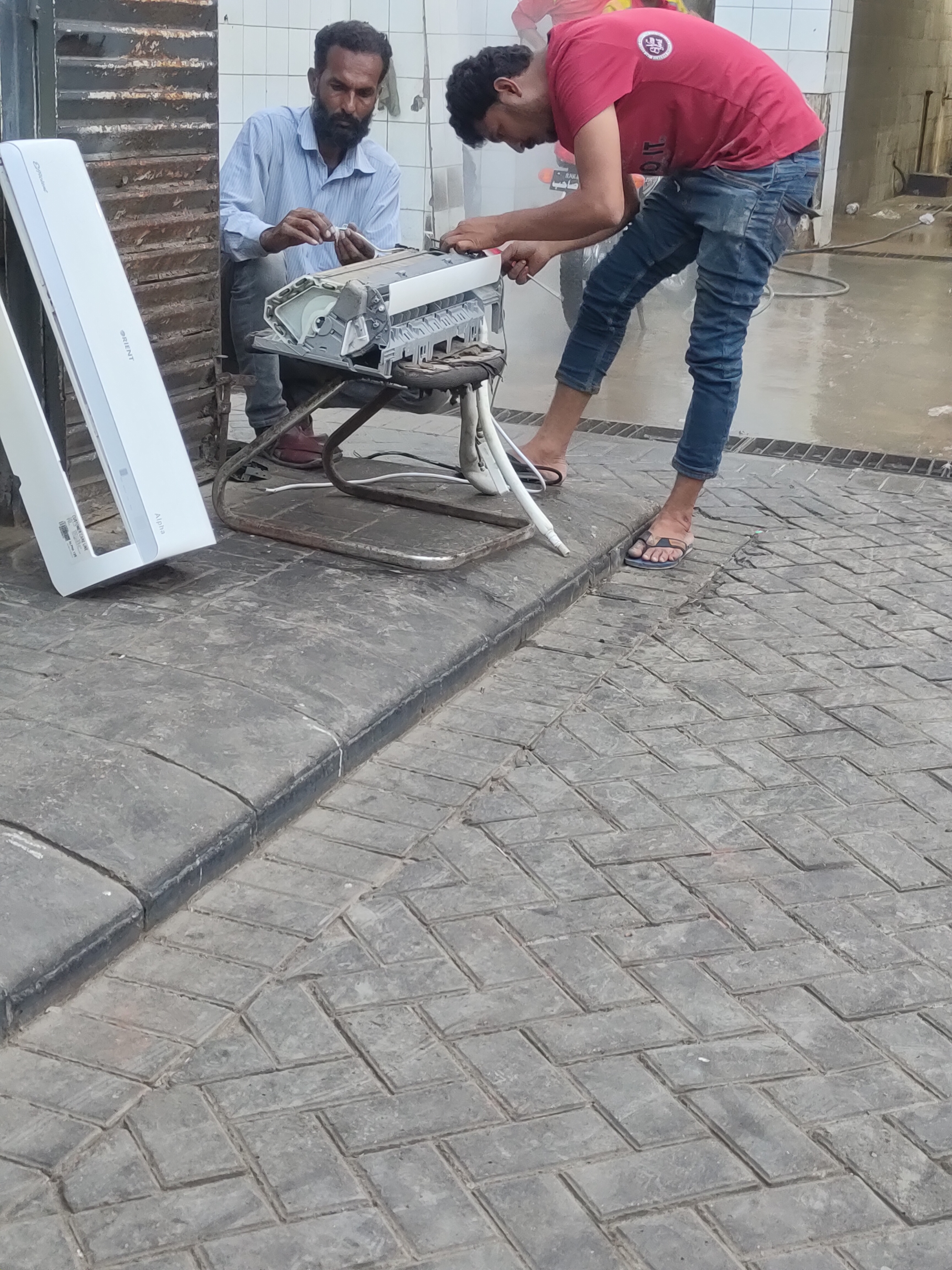

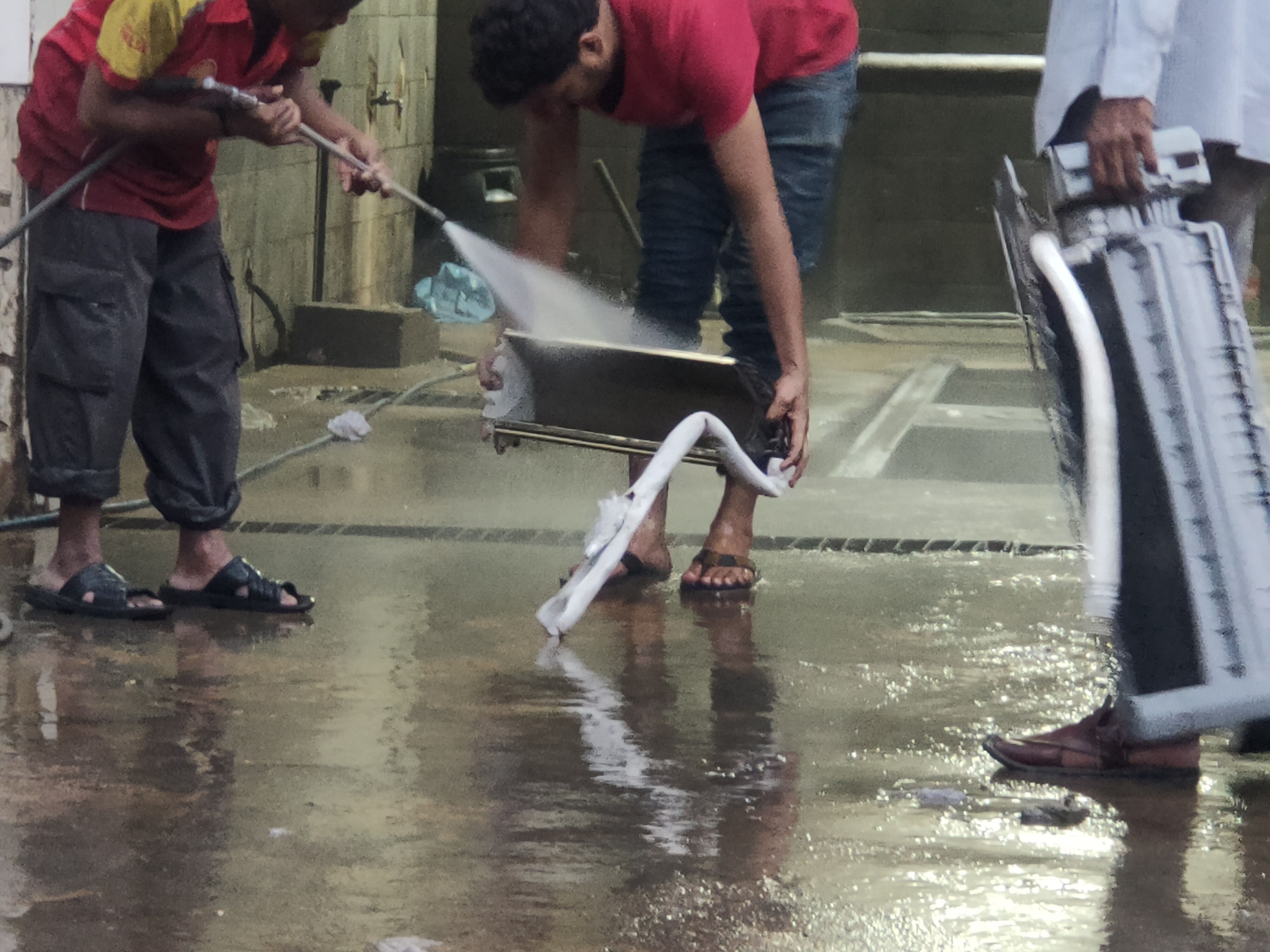

How to clean the blower of tcl miracle?

Does your miracle make any whoosh wind sound when running? As if lifafa stuck

No.But it has high wind noise when fan is running at full speed.

Plz check post#6995 in this thread. Basically, I removed the plastic body of indoor unit. And serviced the unit with pressure washer.There was no other fast way to clean the mould buildup on blower.
Same was the case with mine. After cleaning, all good.
