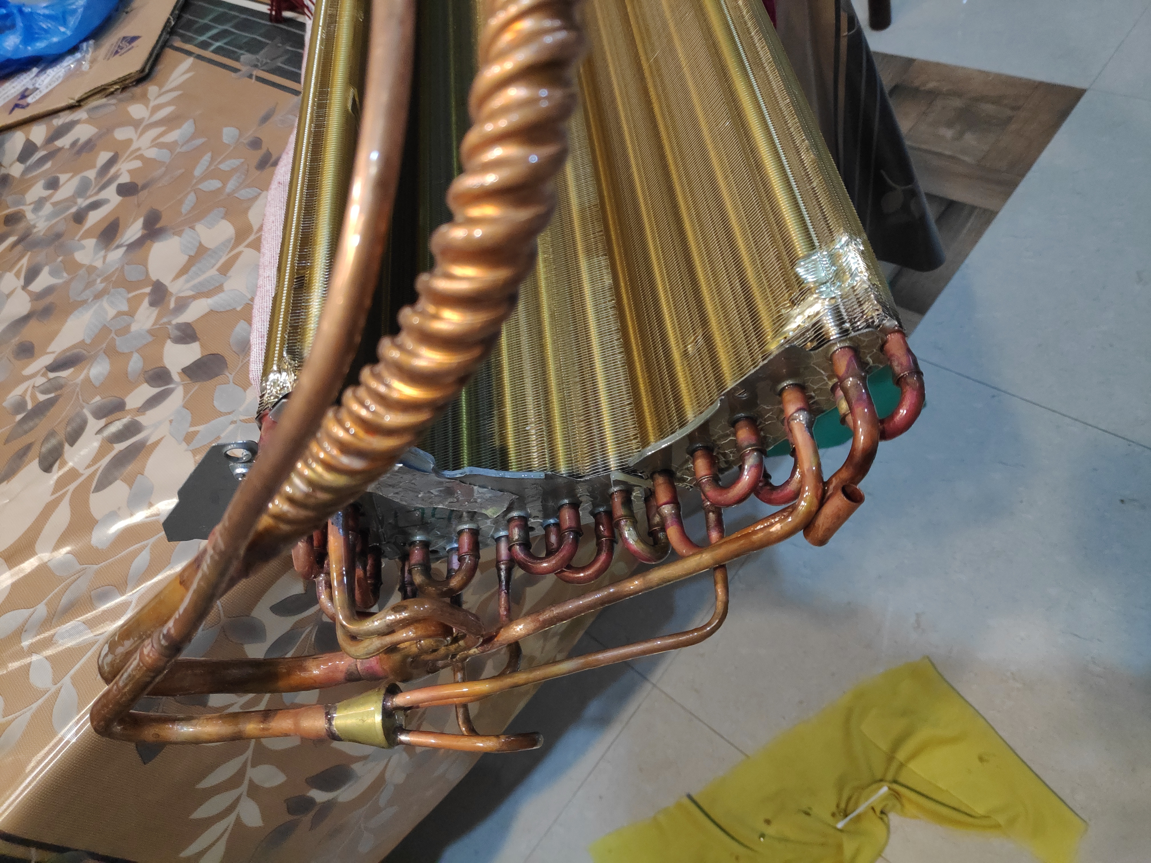

I am also not a typical consumer/end user. I have my own tools and material for carrying out AC install my self. such as vacuum pump, gas charging lineset, clamp type multimeter, drills etc.
since you mention the sea, you can either pay Pakref guys PKR 7000 for doing a corrosion protection of your AC. or if you can take things apart and put them together, do it your self with epoxy. honestly it is NOT at all difficult, at the max you will need a phillips head screw driver
