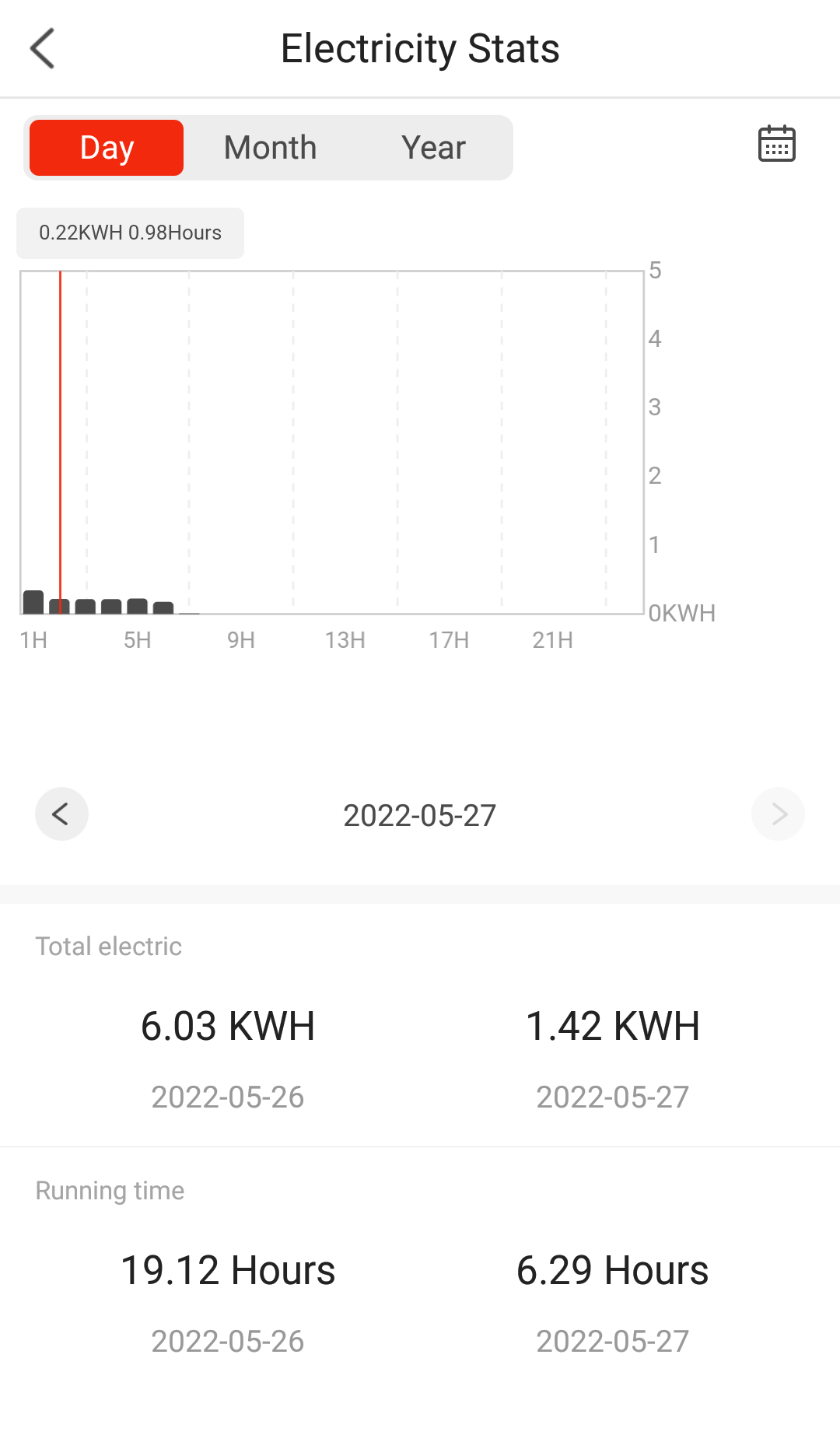

But I believe if pcb is programmed better you could save more electricity.
Personally in my observation, with just 1 degree C difference AC starts behaving differently.
For example if its 35C outdoor AC will run at (3A x 220v) then enter tripping mode after achieving set temperature.
If it's 34C AC drops amperes to 2A - 2.2A (at 220V) and trips.
If it's less than 32 it further drops to 1.6A (at 220V) and trips or sustain.
Below than 28C outdoor, it could drop to 1.2A and sustain running compressor.
