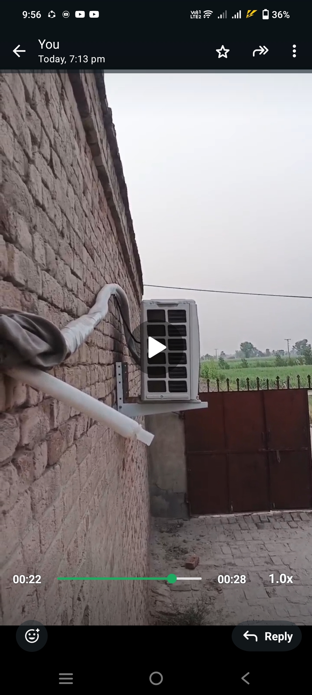

2 Ton Inverter AC installation experiment done last year in a 12.5 feet x 14 feet upstairs room. Room is mostly 40C without AC in peak summers.
The main benefit of an overpowered inverter is that it will automatically adjust it's capacity according to room and provide instant cooling, that brings stabilizing amps very low, even at 22C - 24C thermostat.

The Universal "Darwaza band karo, AC chal raha" problem:
It increases amperes nominally upon leaving the door open and instead starts cooling the room next to it.
