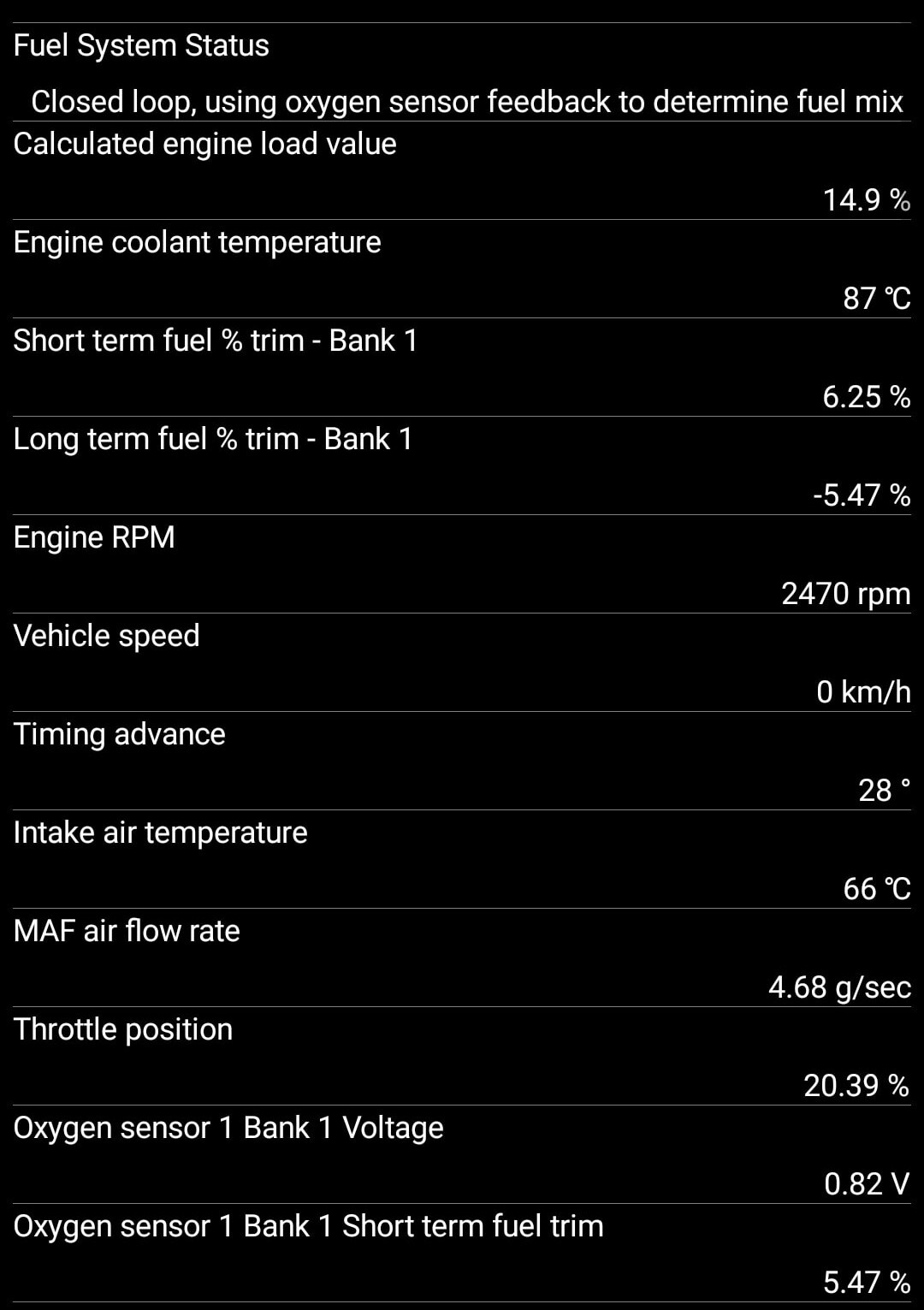

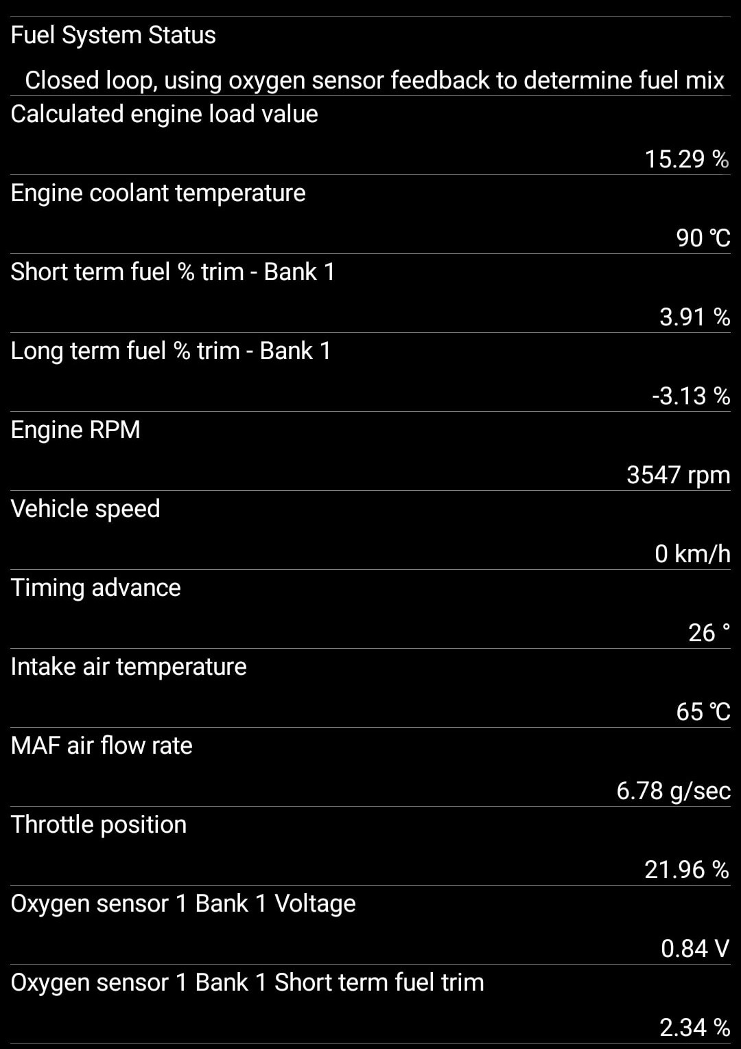

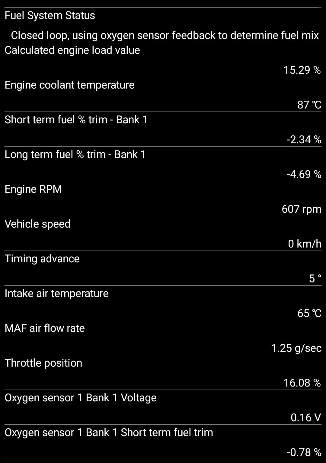

By the way here is some data. LTFTs here are learned values after a 60km run on highway.
IDLE
2470 RPM
3547 RPM
What mileage you are getting on these readings?
And of which car these obd pictures are?
This is 2SZ 1.3 litre engine for Toyota Belta.I haven't calculated the mileage.
O2 is on the higher side in each picture. But trims are fine. So overall things are good.
