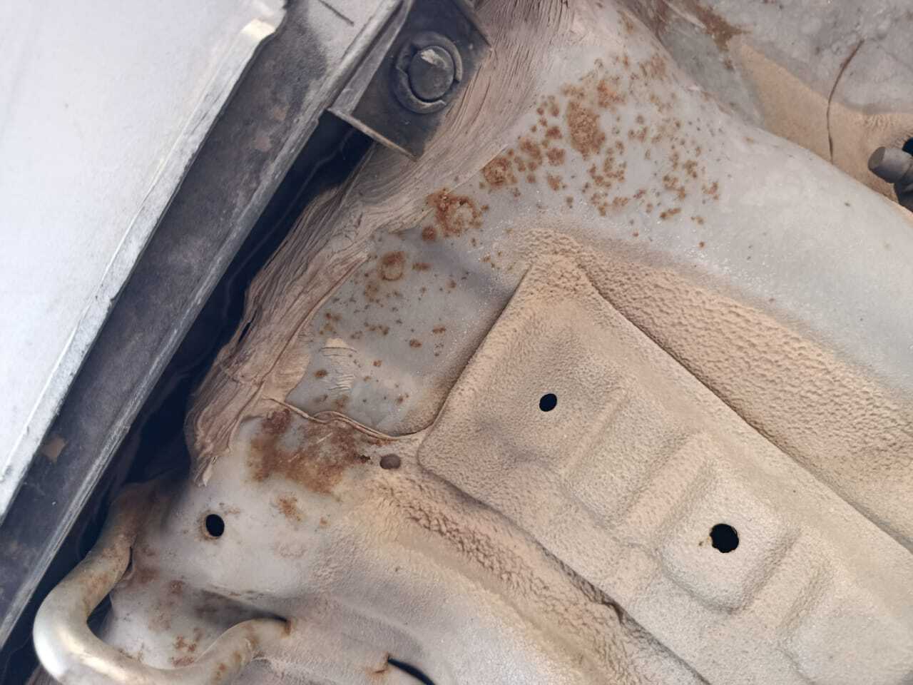

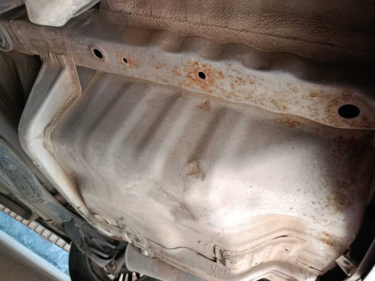

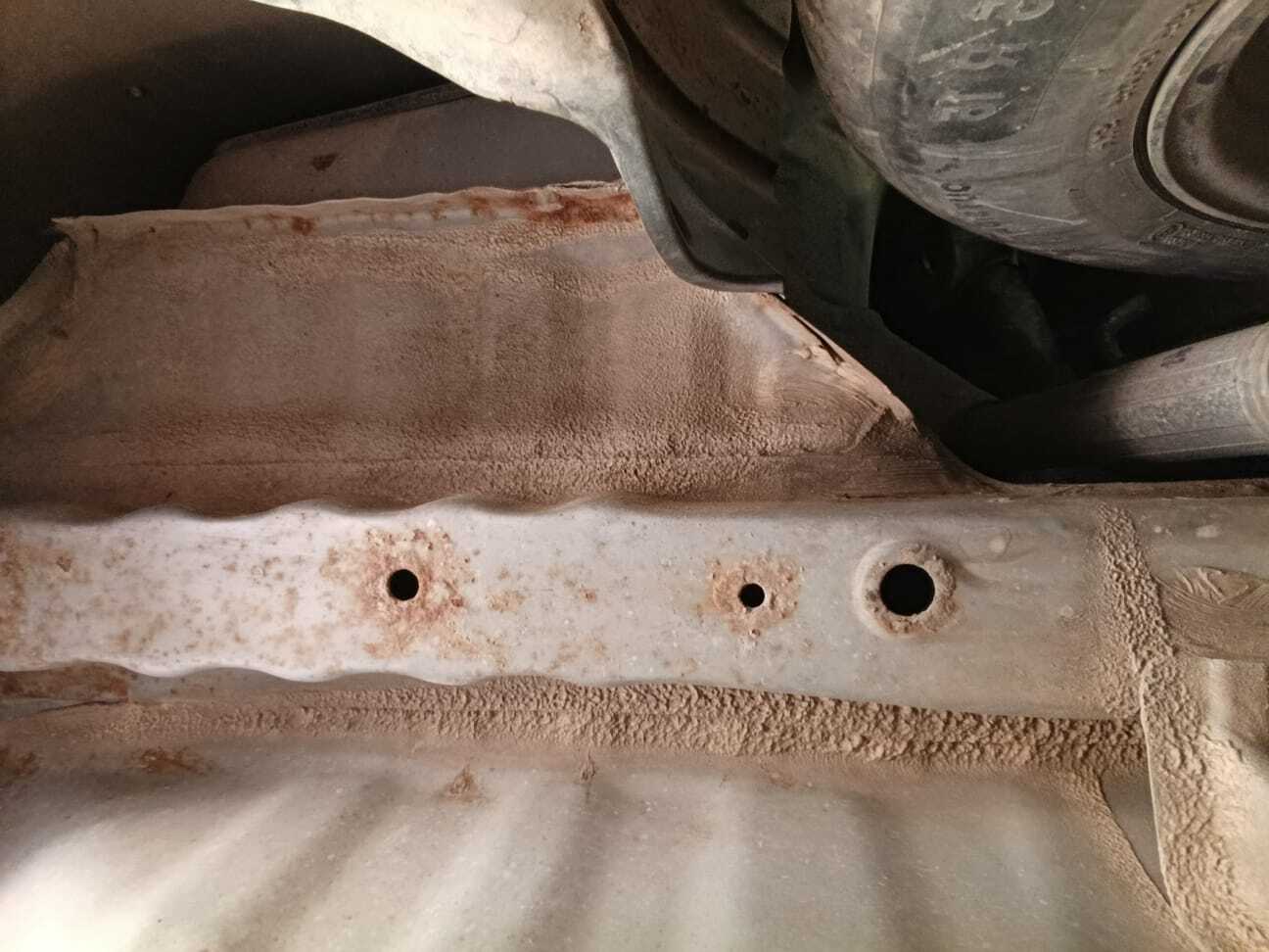

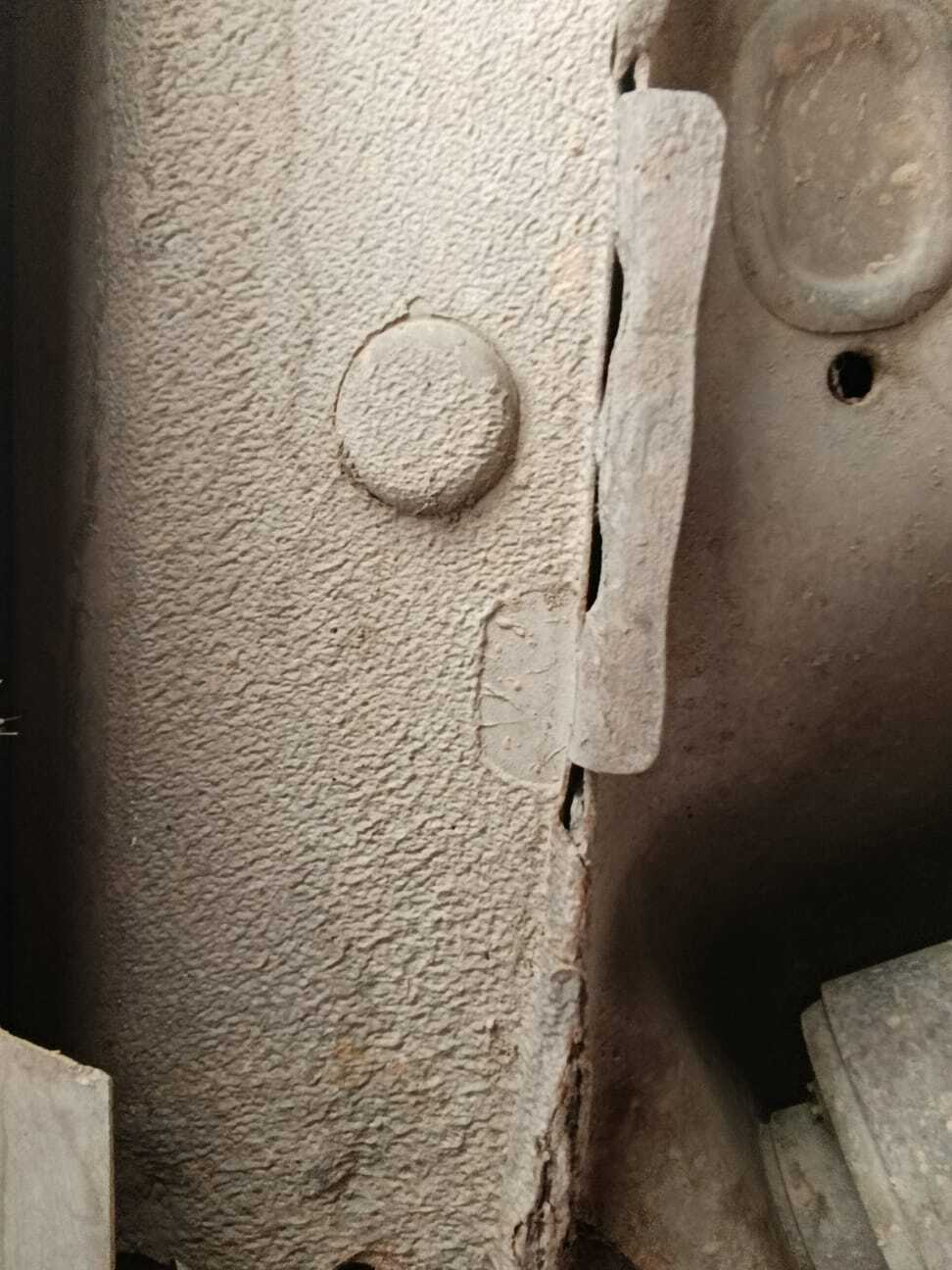

I purchased this car honda city 2018 model is it recommended to use or return to person for reference i am attaching pictures
What is your question?
Is the rust stain bothering you?
He probably wants to know if he should keep it or return it back to the PO.
dear i want to know that is this rusty okay or it is a sign of danger
These rust stains are not a danger. Its literally surface rusting due to the excessive “serviss tayshun” washings that people subject these cars to.
hi all i need some more recommendations please.
bhai ye surface rust hai, problem nahi hai. itni to ho hi jati hai cars main... it can easily be removed also by some treatment.
You should probably avoid this POS....this isn't just surface rust but harbinger of the crumbling days ahead...these Shitties rust like these are being used as oceanliners. Most definitely the body cavities have started to rust from inside out.
