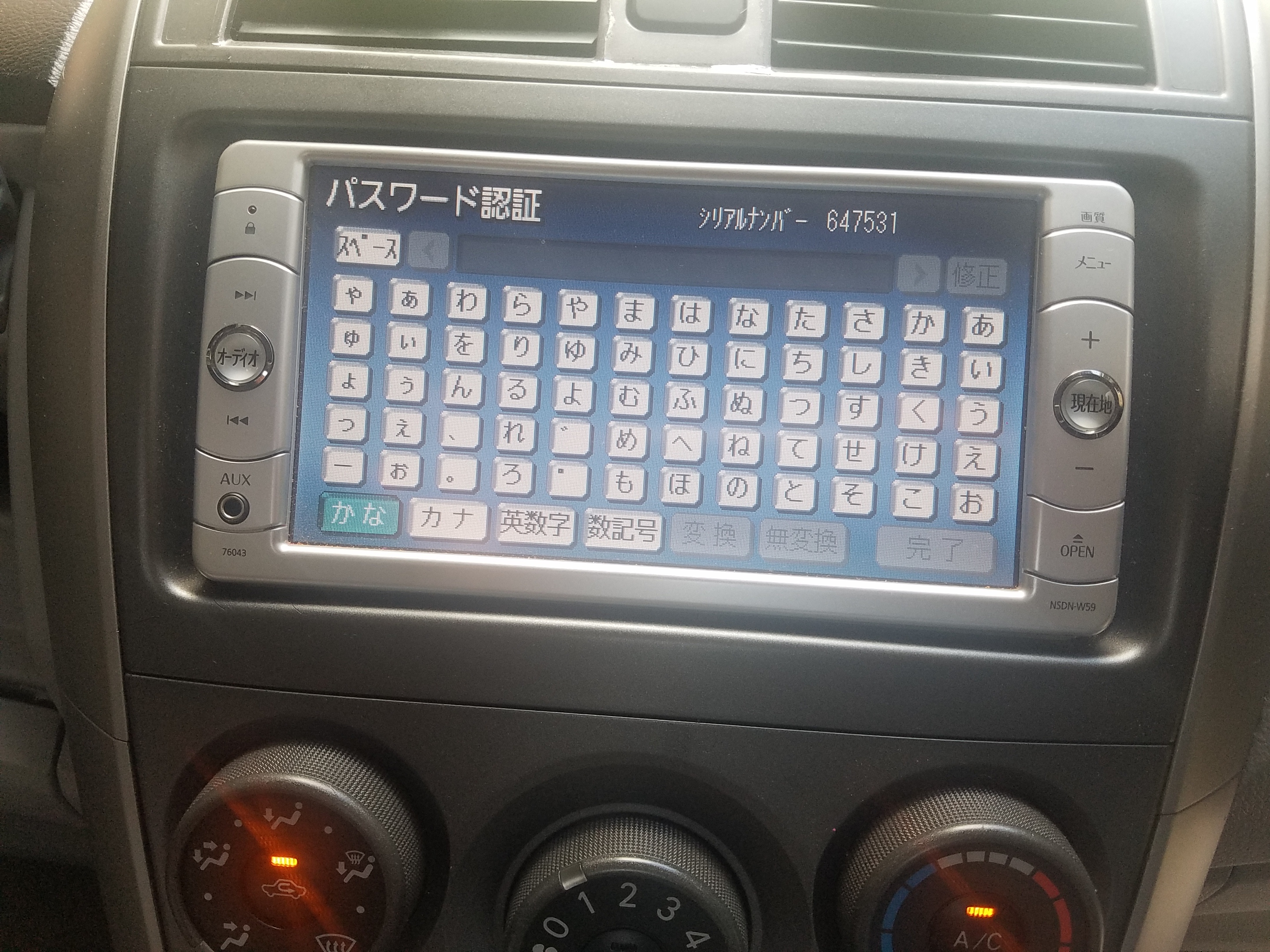

Hi, Please confirm if this is the ERP code. THis is the display i get . I cannot view anything else.The device was operational untill i reset the battery. It has ben asking for the password ever since.

Turn on ignition half way. Press the deck disp button (large bttn on left) and hold. Turn on and off parking lights three times. You must keep the disp button pressed continuously when doing this. You'll see a series of screens with click able buttons. Only click on highlighted buttons. It will end up on ERC code screen.
Thanks Tarif, I'll check and confirm.
Hi Tarif, It worked.

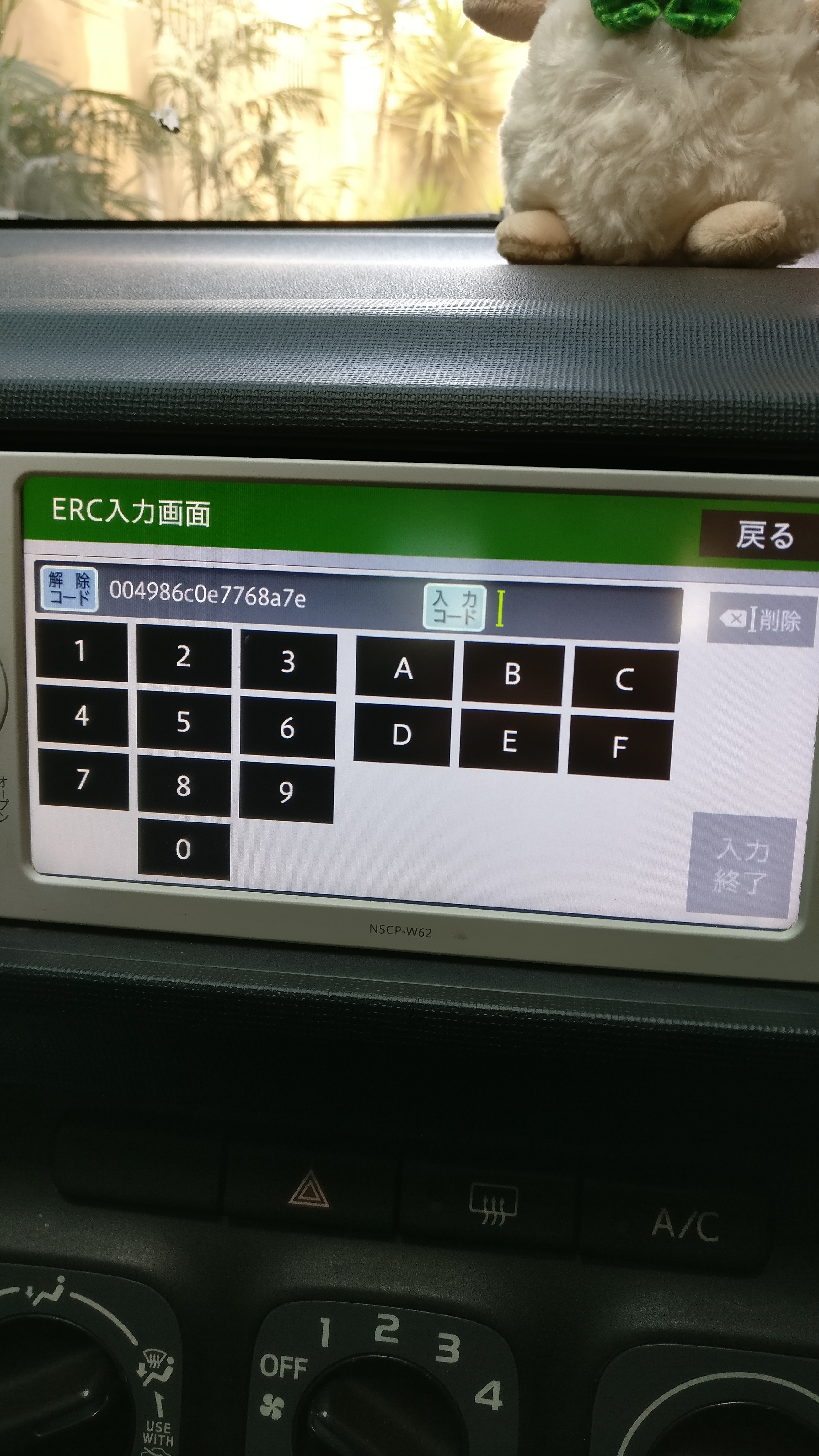

@KeiWorks12 the ERC is 009121aac00000000, model NSCP-W62. Please share the password.

Dear Sir and everyone,May I know how to get the ERC number for my NSZT-W60 car radio?
Thanks in advance.

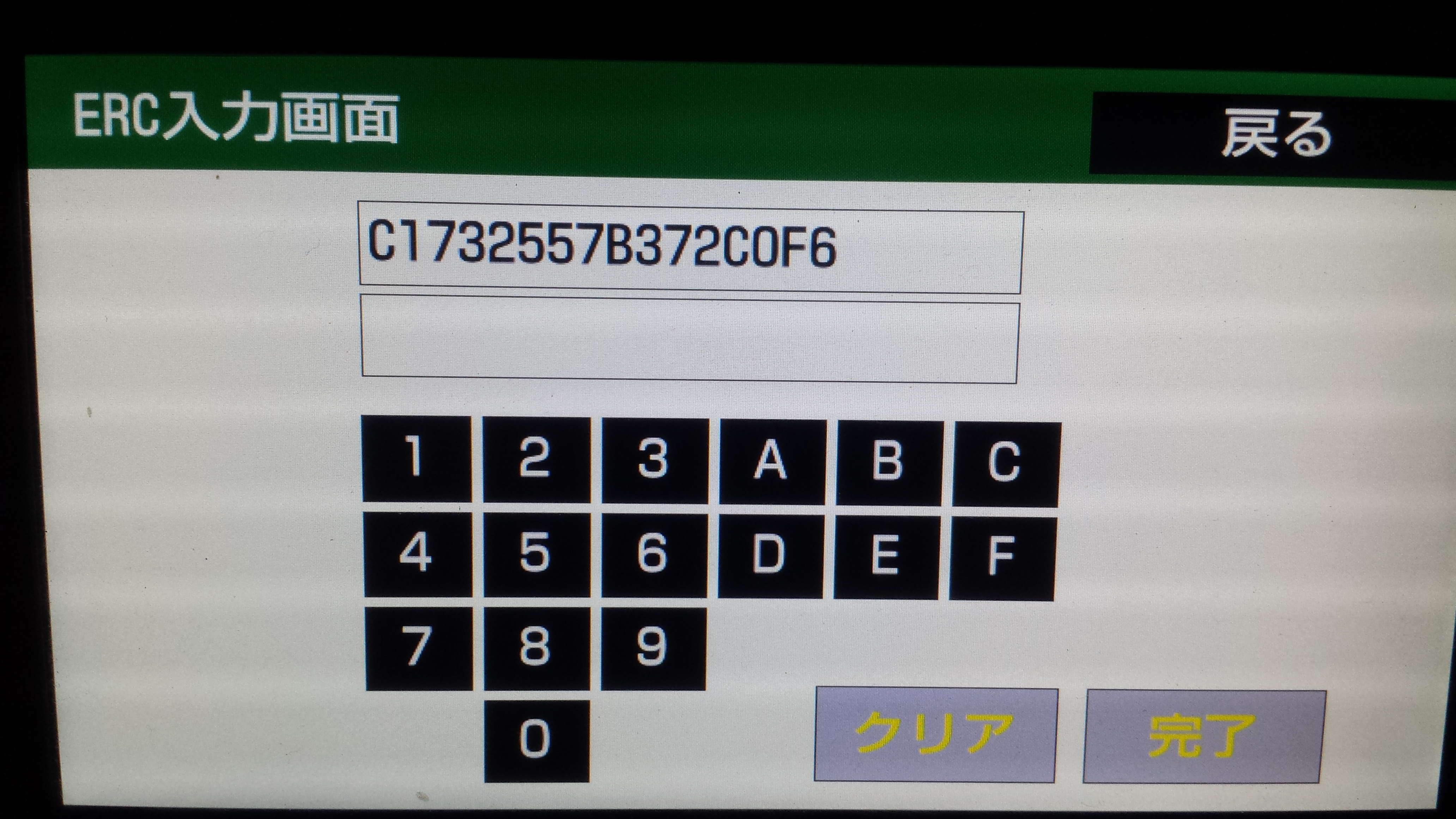

I have TOYOTA NSCP -W62my ERC is 00e0409800000000Please help me unlock codedransiluict@gmail.comthank you

Thanks.. It works
Me too. Thanks for the share.
