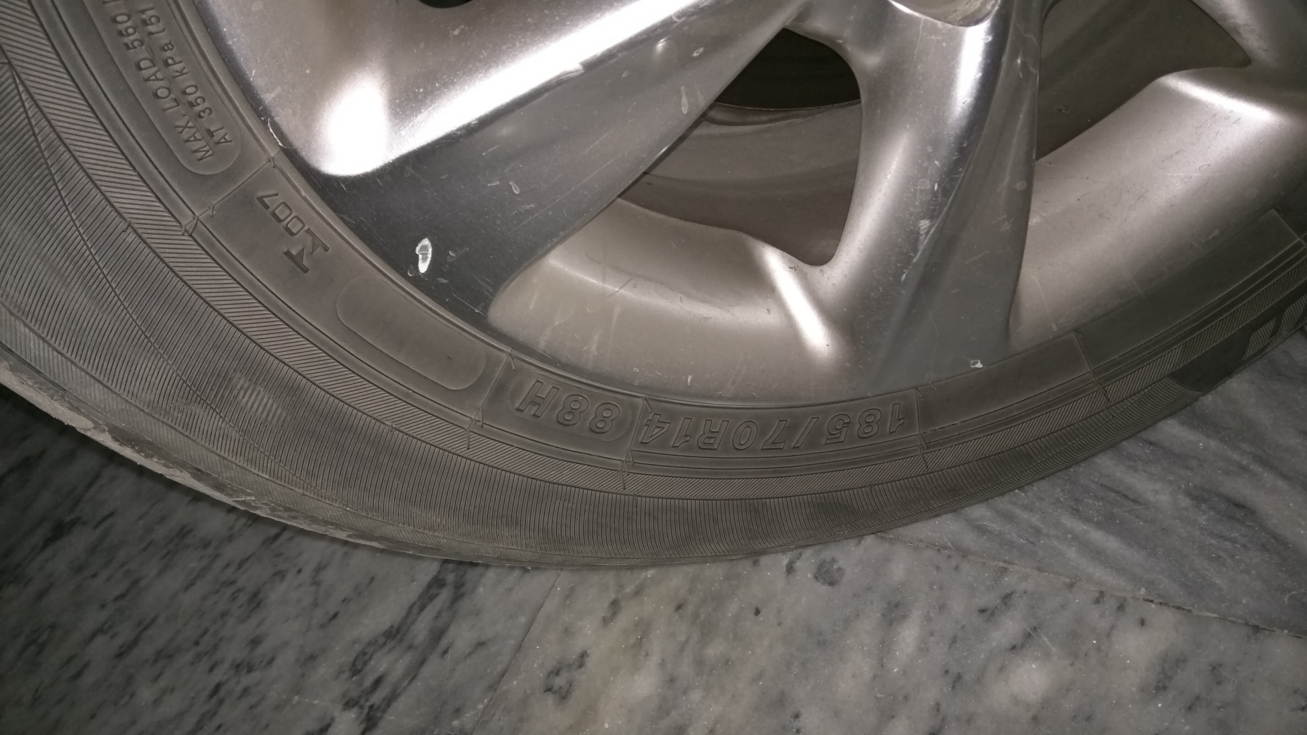

Standard tire size for passo is 155/80/R 13 where( 1 inch is equal to 25.4 mm).

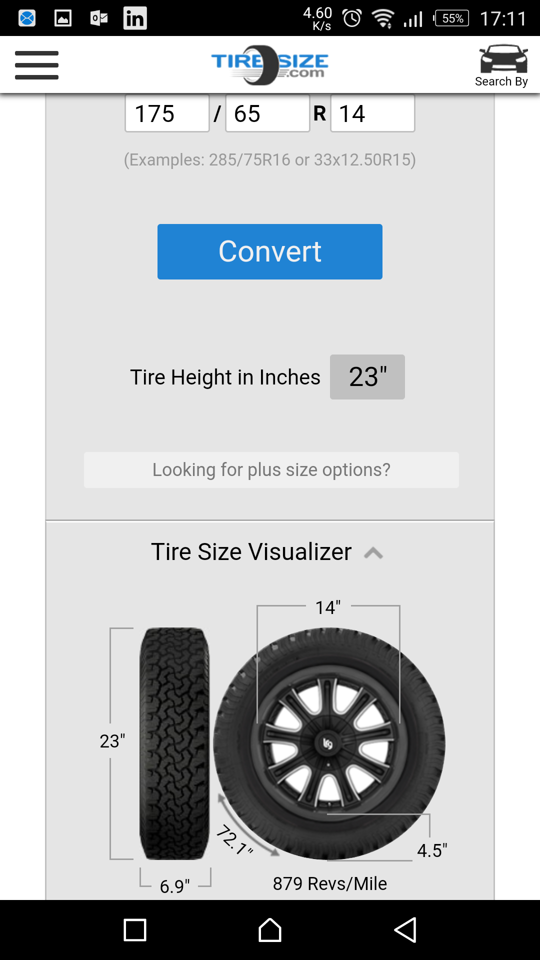

Standard size 155/80/13 (22.76) v/s 185/65/14 (23.46) => Difference = 0.708(Nearest in rim size 14)
Standard size 155/80/13 (22.76) v/s 175/70/14 (23.64) => Difference = 0.885
(Correct me if I'm doing something wrong)
When changing tyre size, the tyres should not have more than a 1% difference in diameter - less than 0.5% would be ideal
