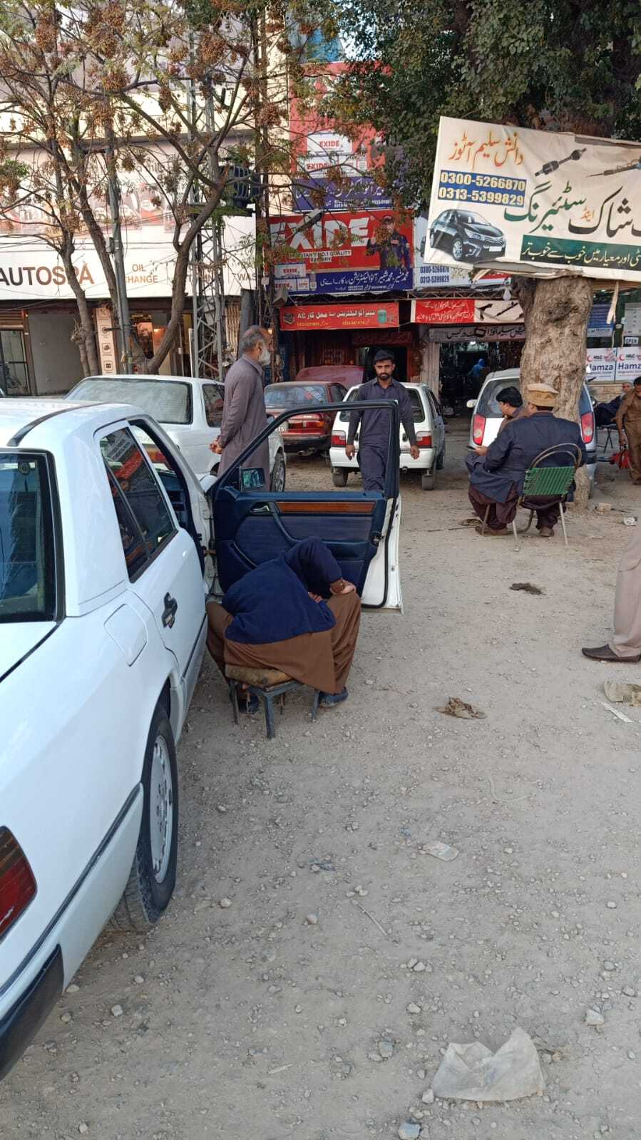

So, I went to Raja Atta Bhai, amazed to see that the workshop was open & operational at 8:30, a nice person, humble, polite enough to answer each and every query and very detailed when it came to diagnoses.

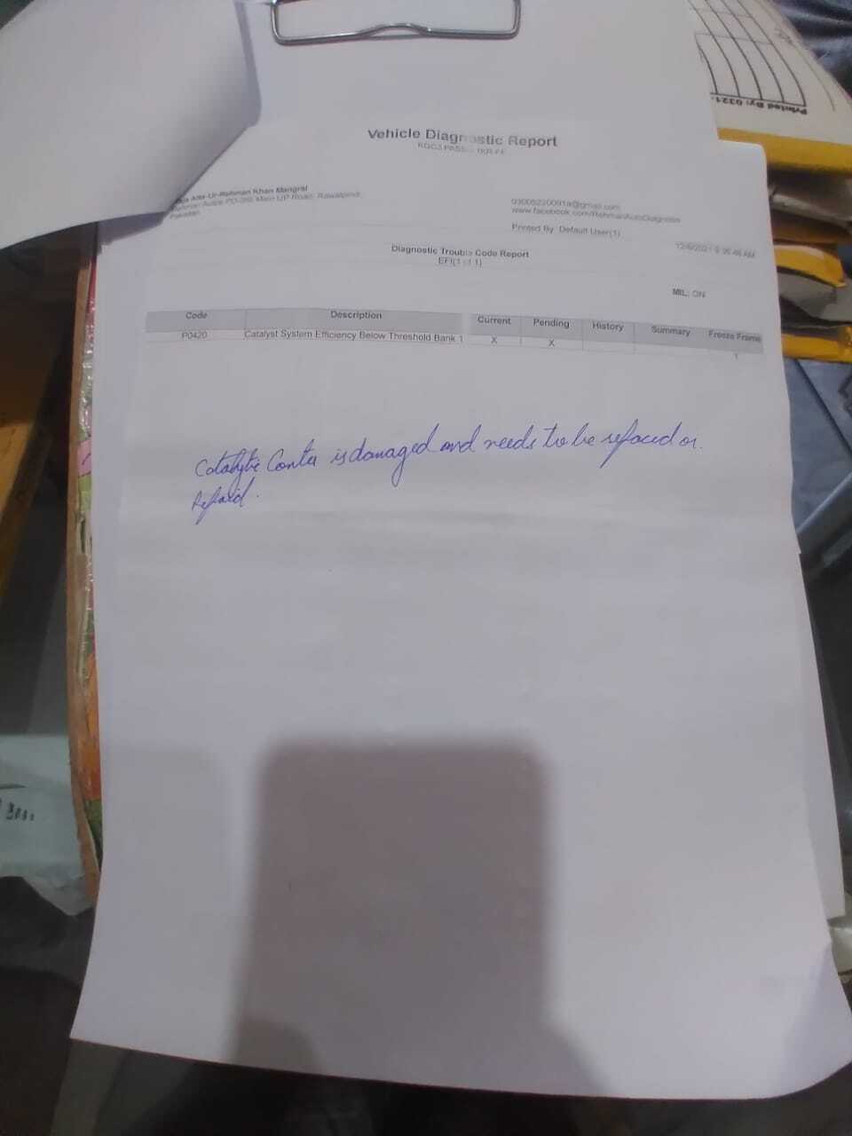

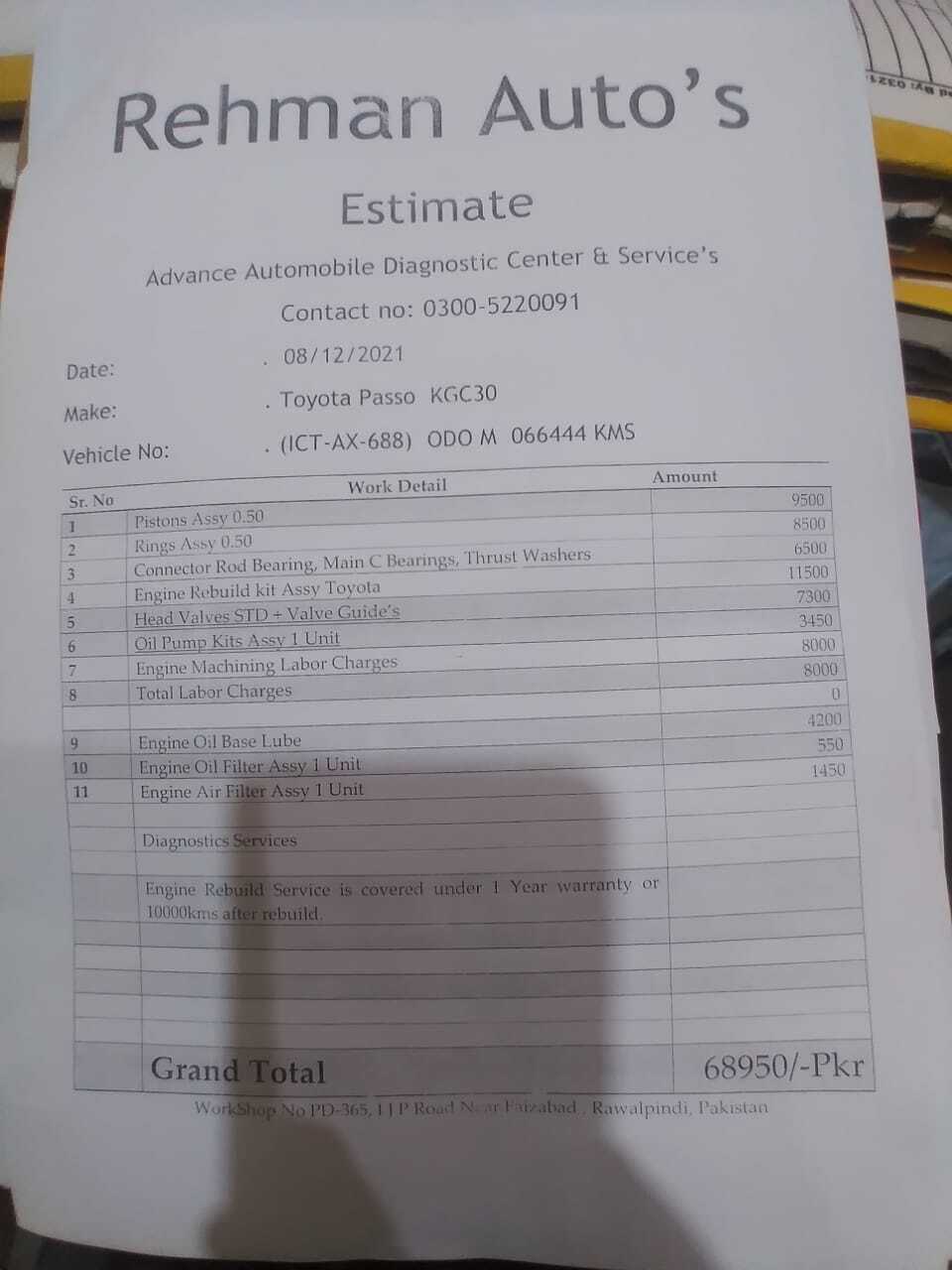

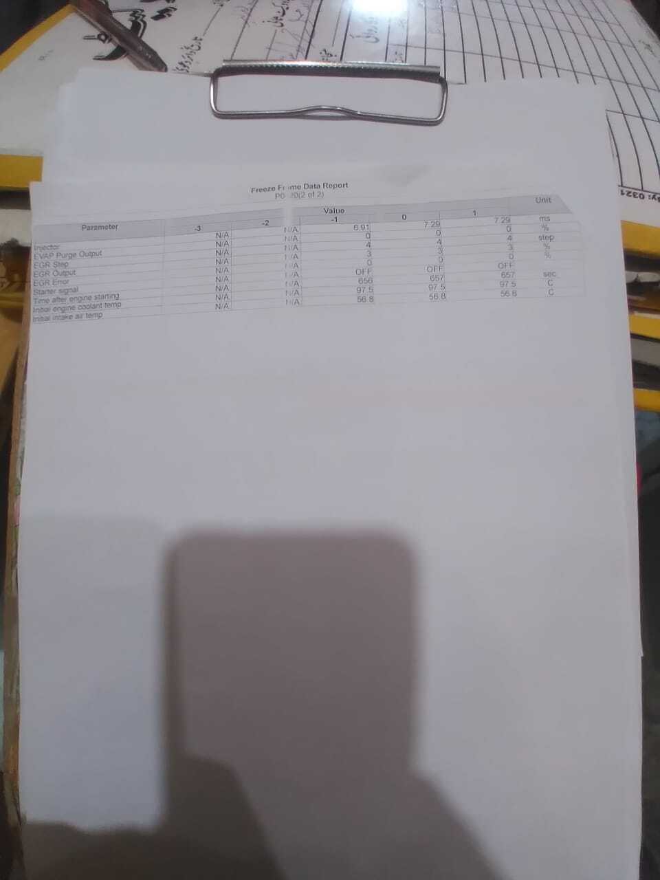

After the diagnoses, we were told that the engine has completely deteriorated and it needs a complete rebuild.
We took an estimate and discussed a few details, hopefully will visit in last week of December to have the rebuild work done.
