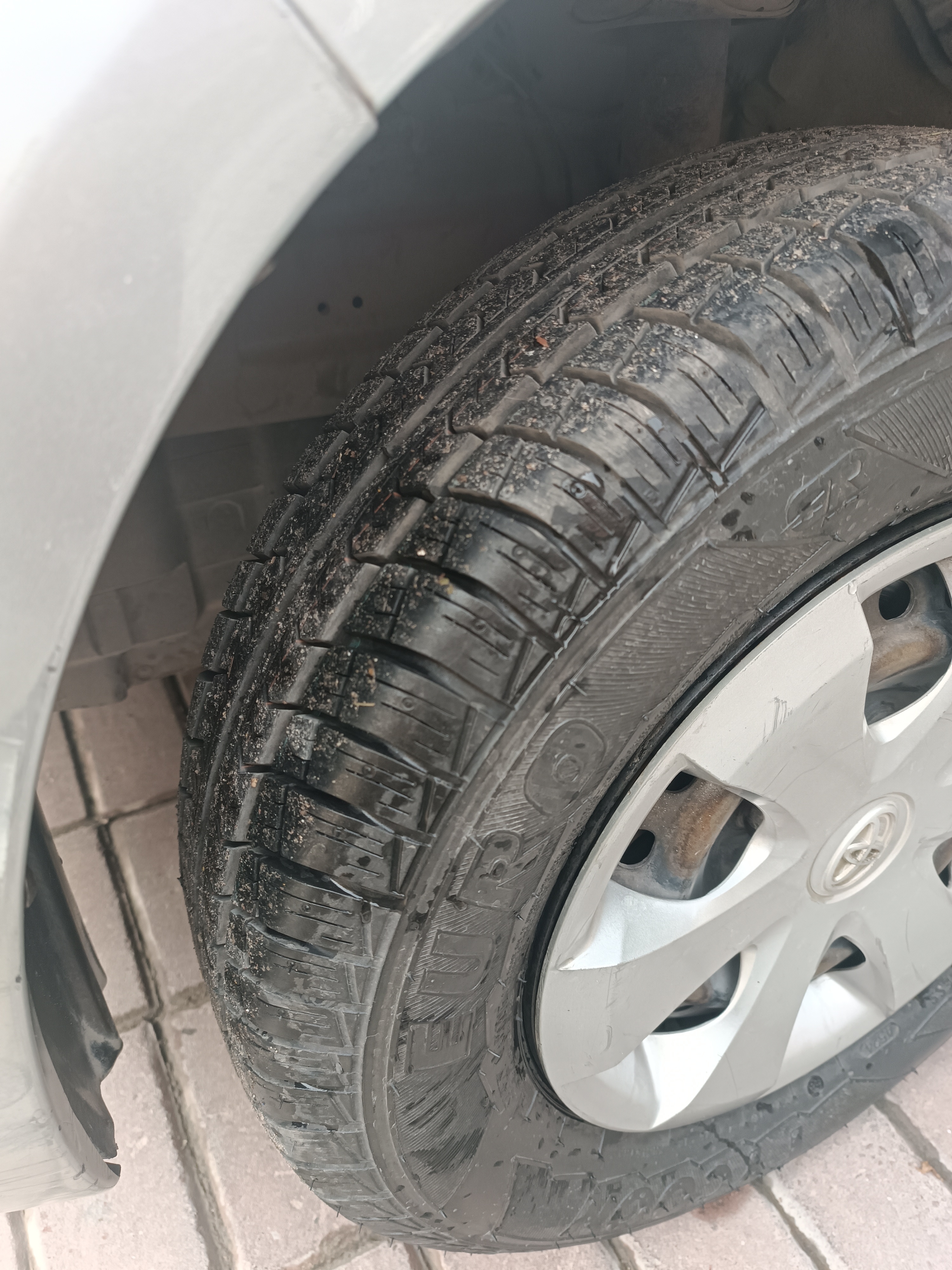

Got front new tires 175/70/13General Tycoon...11k eachChinese brands confuse me.n if u recall a good brand of it, they are always out of it
Currently using Kenda on my Dayz, very good tyres. Not sure if they're still available or not.
Nexen are very good specially 13 n 14 dia ones..
Officially imported available from daraz.
