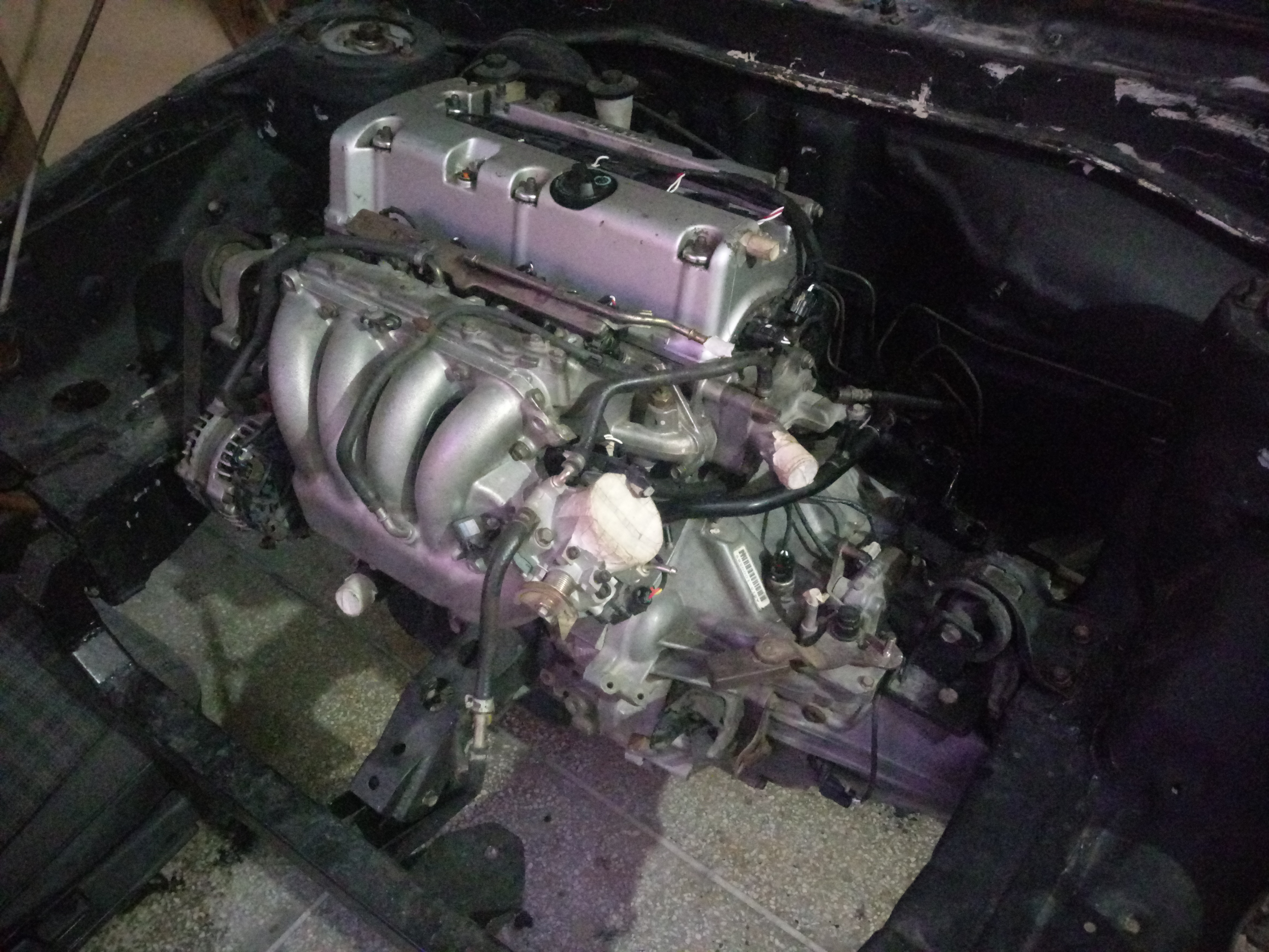

Valve seals replaced.

This is a basic tool that I made to replace seals.
The shopkeeper gave me all the seals of the intake side without realizing the difference between exhaust and intake seals, which required me to make another trip to the market.
Intake seals have white-colored springs, while exhaust seals have black-colored springs. Both of them are unique and cannot be substituted. The same seals came in various engines from 1992โ2020.

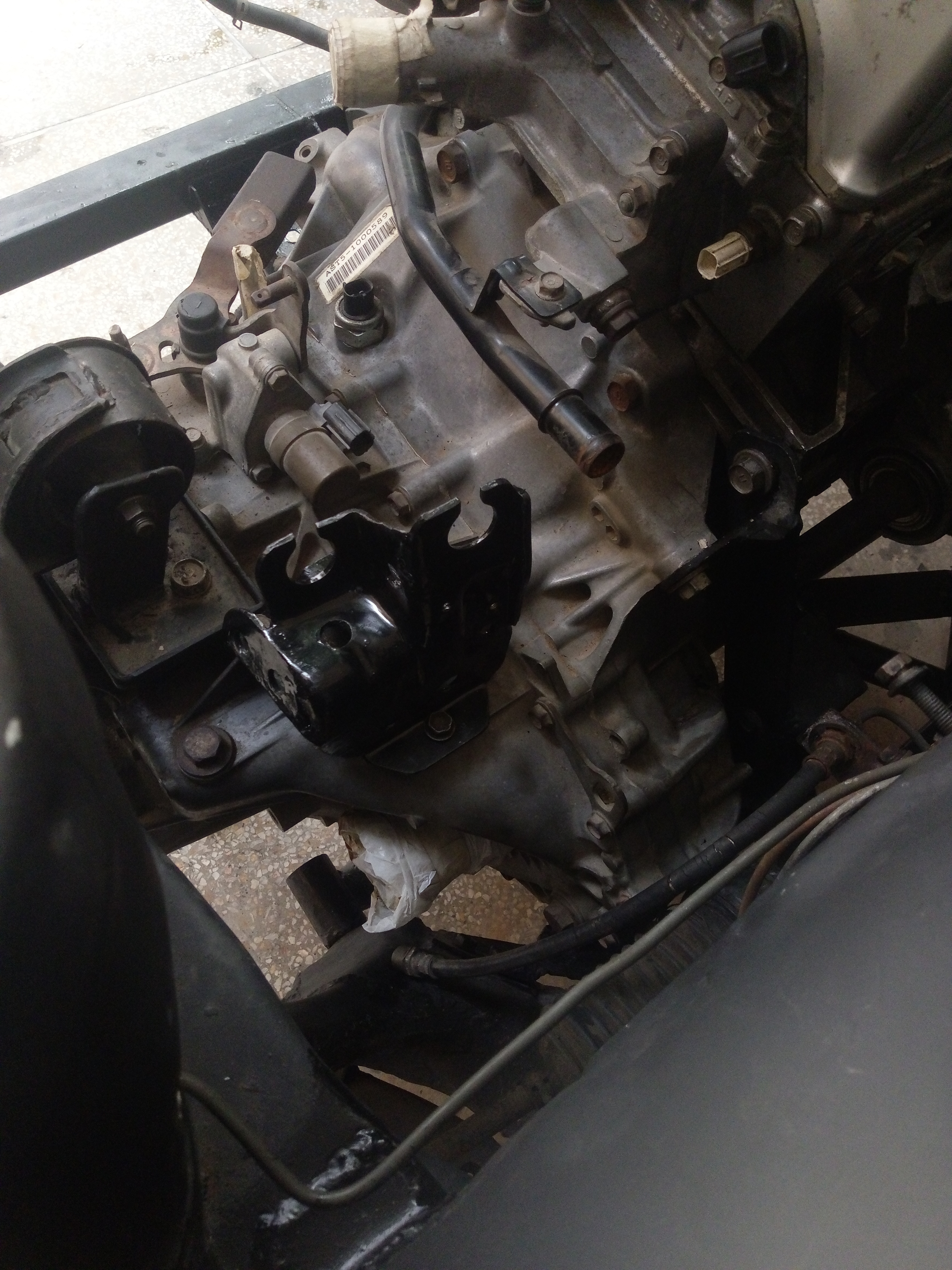

Next, I will put the engine back, modify the shifting cables, and make a new transmission shifting cables bracket.
