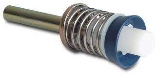

I faced same issue 1st I thought these are plug wires. Replaced them still the same. Than I checked plunger that was also fine. The petrol level was a bit high in carb, adjusted the float and this vanished but came back after float valve again not controlling petrol level and over flooding the carb.
If level is ok I noticed everything normalises.
