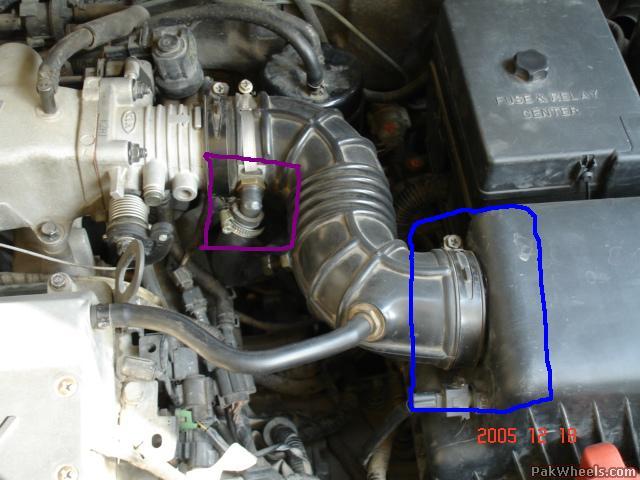

Dear Saqib bhai can you tell me exact location of gear oil dip stic and how to check.?if it is possible to explain with a picture.
Thanks in Advance
I dont have a picture but it on the gearbox towards firewall next to VSS. Beneath throttle body.

Dear Saqib bhai
here is ur ex-pic,,,, can u approx. indicate the location on it
