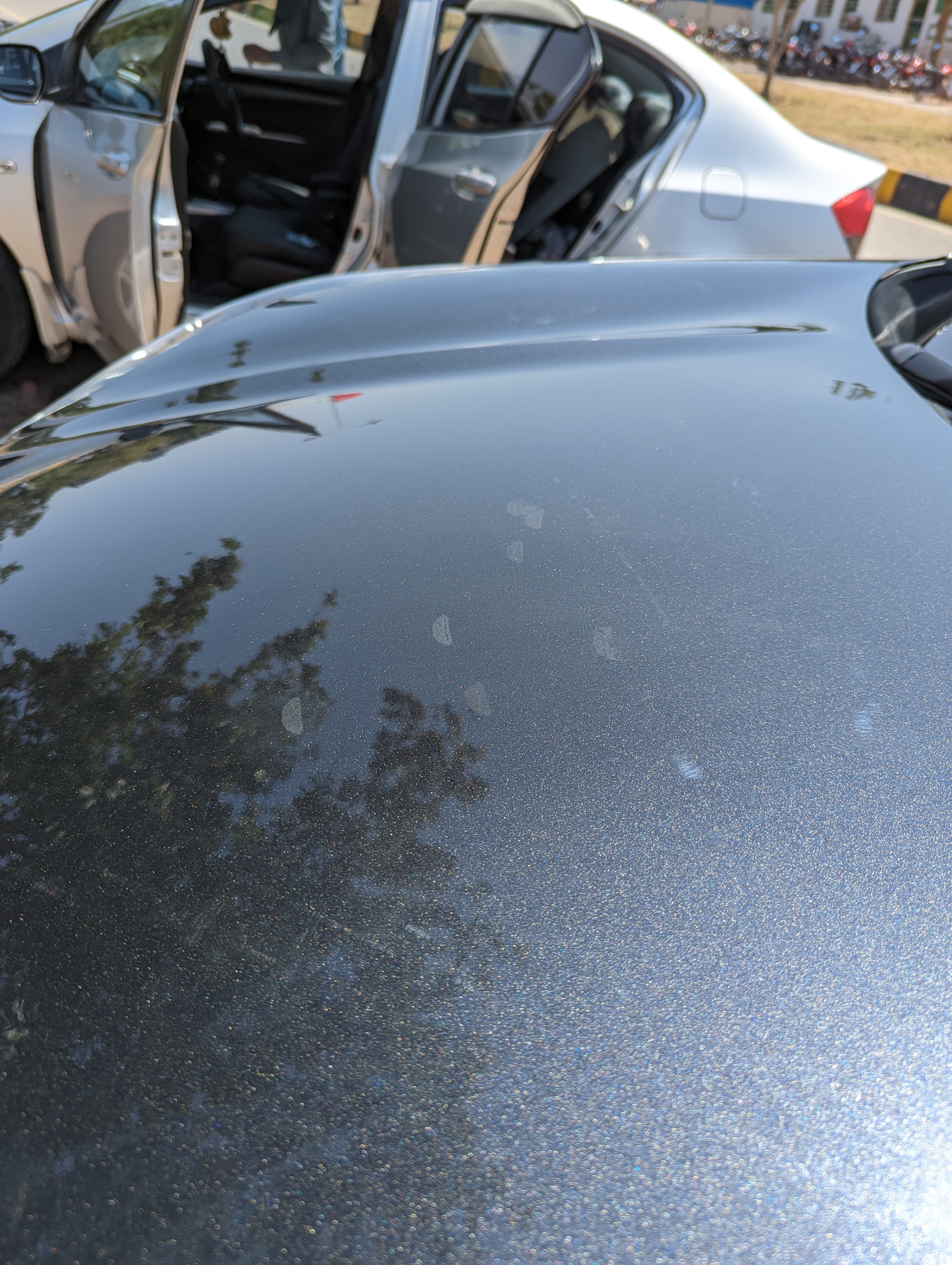

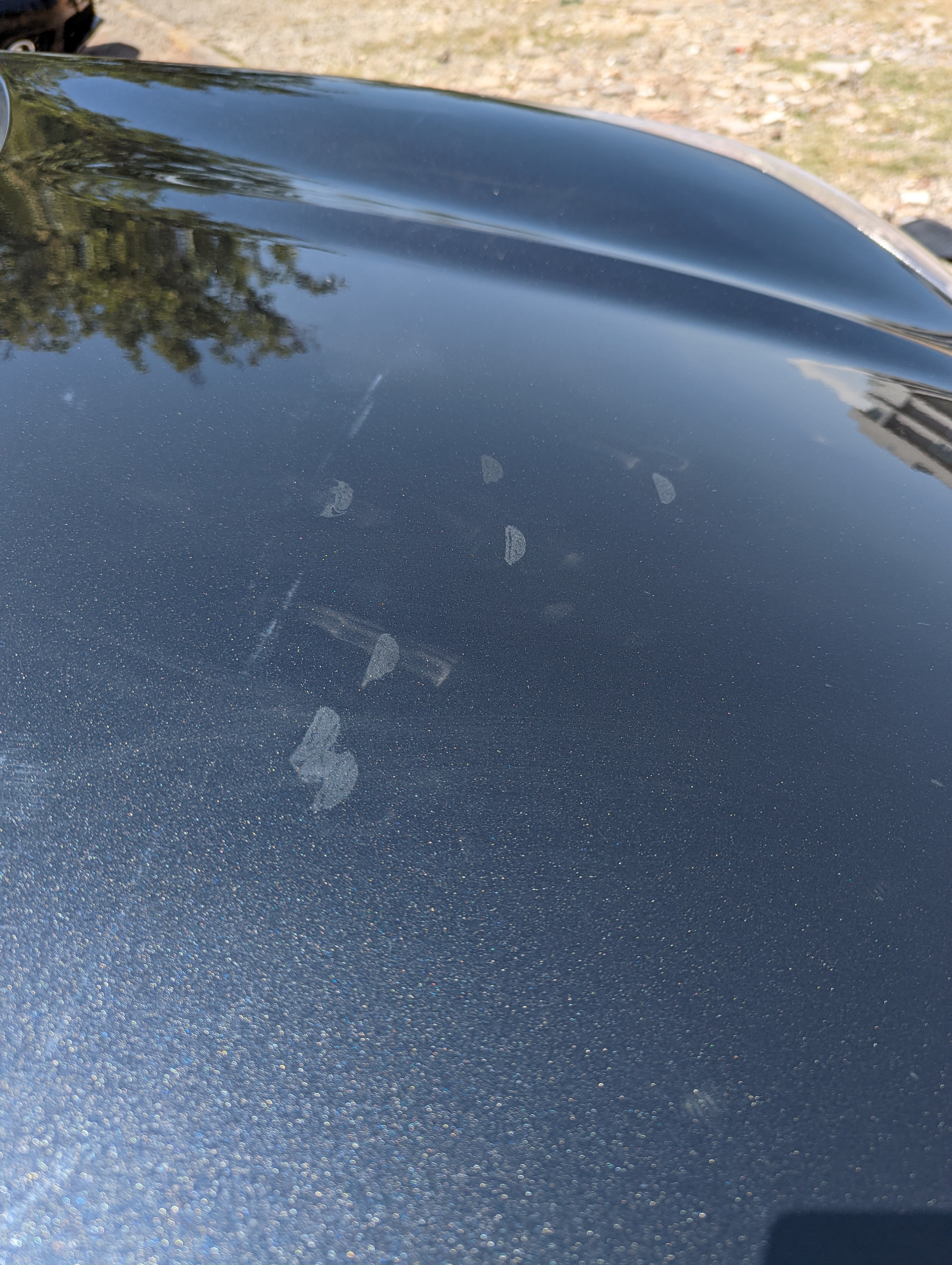

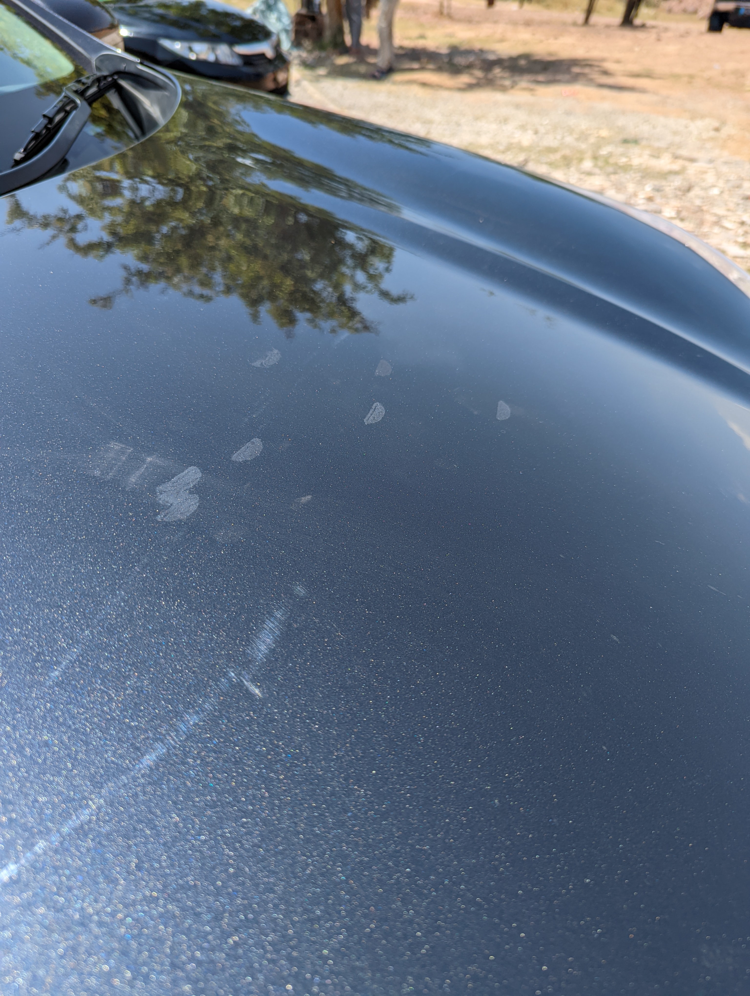

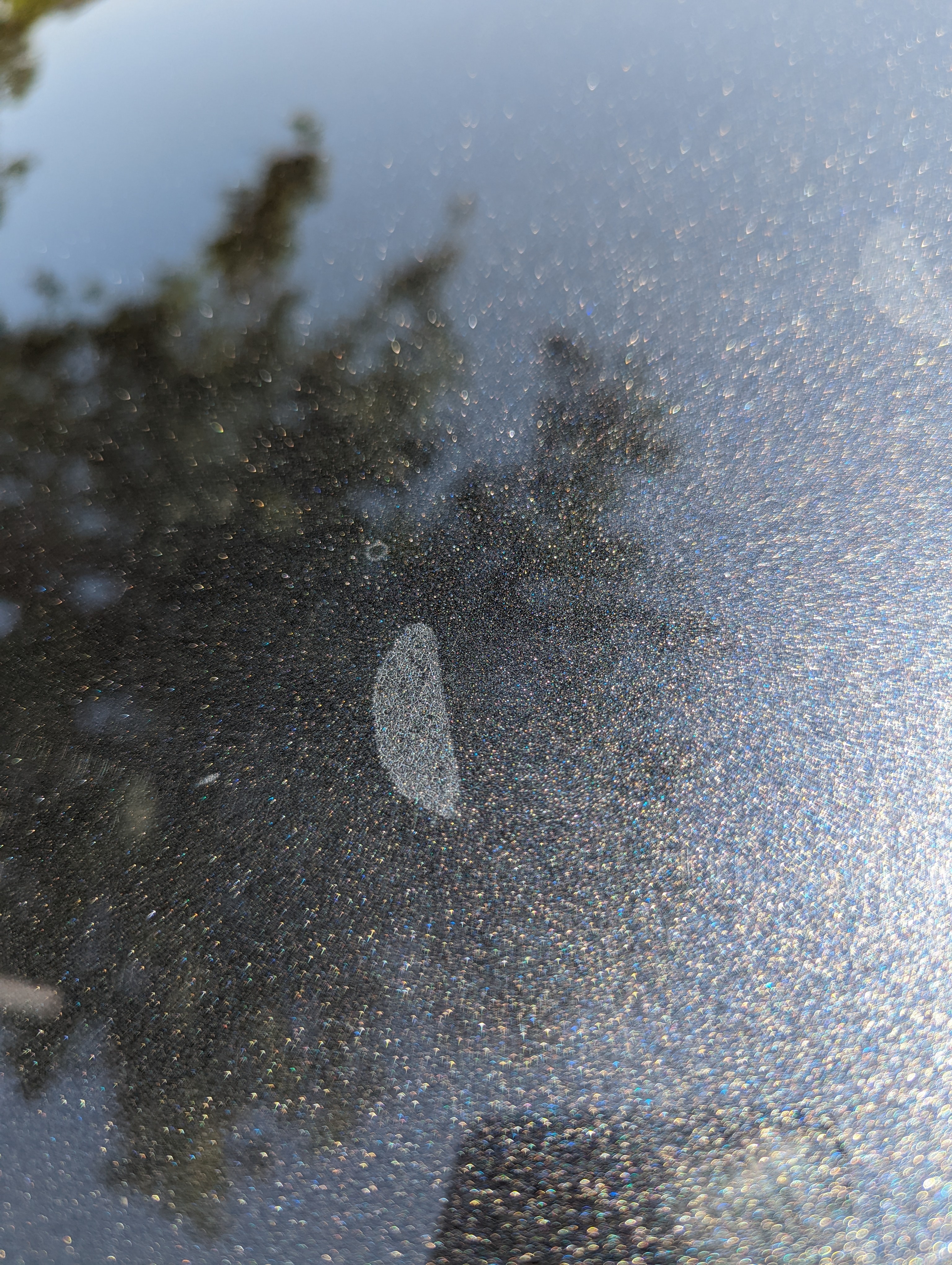

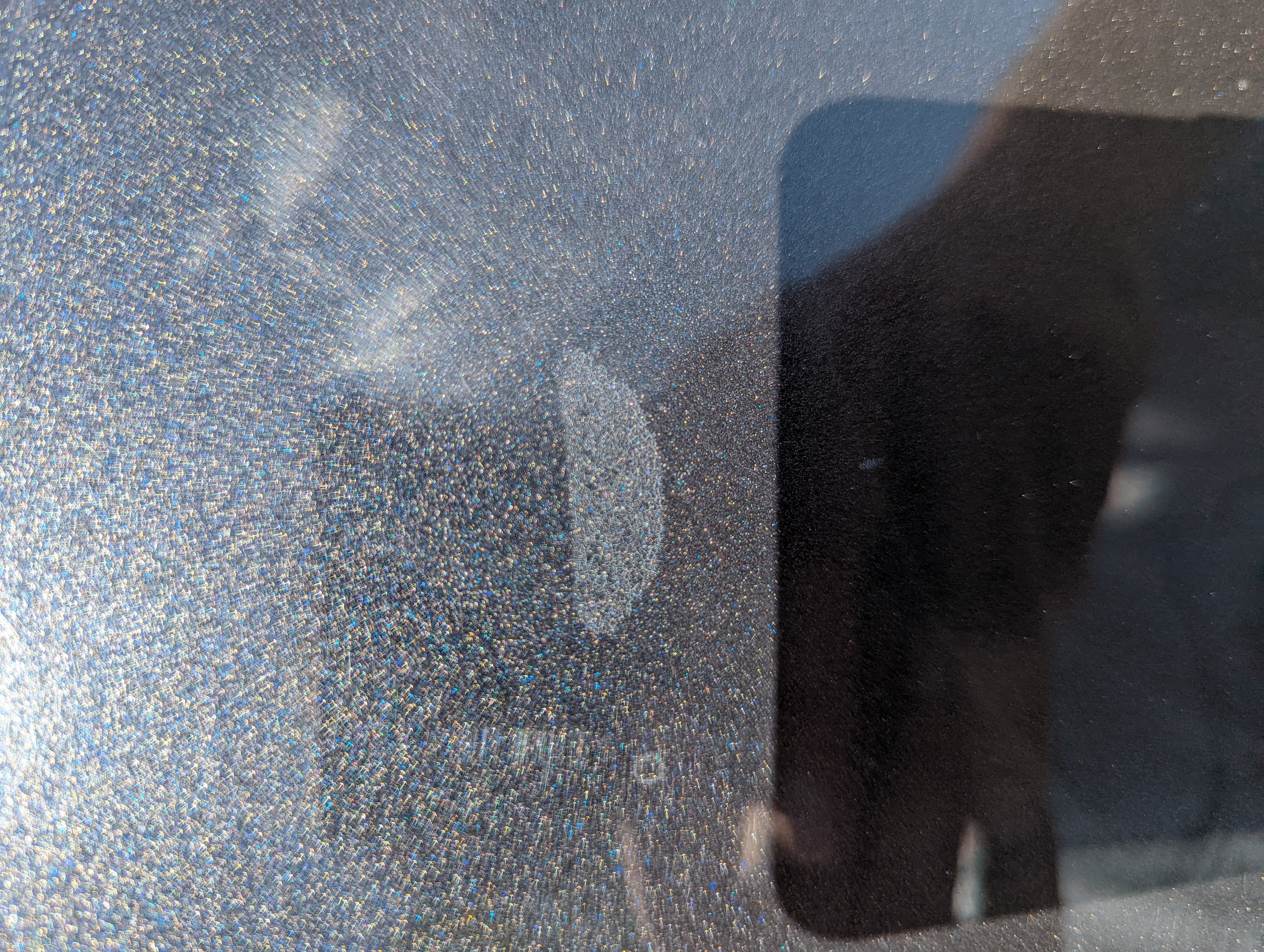

Hi all, need to report on a couple of issues I'm facing with my Sportage. It's 12k driven and so far everything is quite smooth, but recently I noticed these marks on my bonnet. Now keep in mind my car is completely untouched, no detailing work, PPF or coating has ever been done on it. Initially I thought these marks were fingerprints and ignored it. Took it to the wash where they tried to scrub them out but to no avail. Used polish, still not effect. Upon closer inspection, the paint within these marks seems to be cracked. Is this a factory fault? If so I think it should be covered under warranty. Attaching pictures for reference.

Looks like some paint or clear coat from outer is deposit on paint.You can use a clay bar as a proper way or just some petrol as a desi jugaar.
Just rub some petrol and then immediately clean with shampoo.
Use car compound

Take it to any good detailing center, compounding should clear it if it is anything in the clear coat.. if paint is damaged then you need to repaint the bonnet.

Take it to a pro detailing spot. InShaAllah remove hojaiyga and please don't repaint it.
