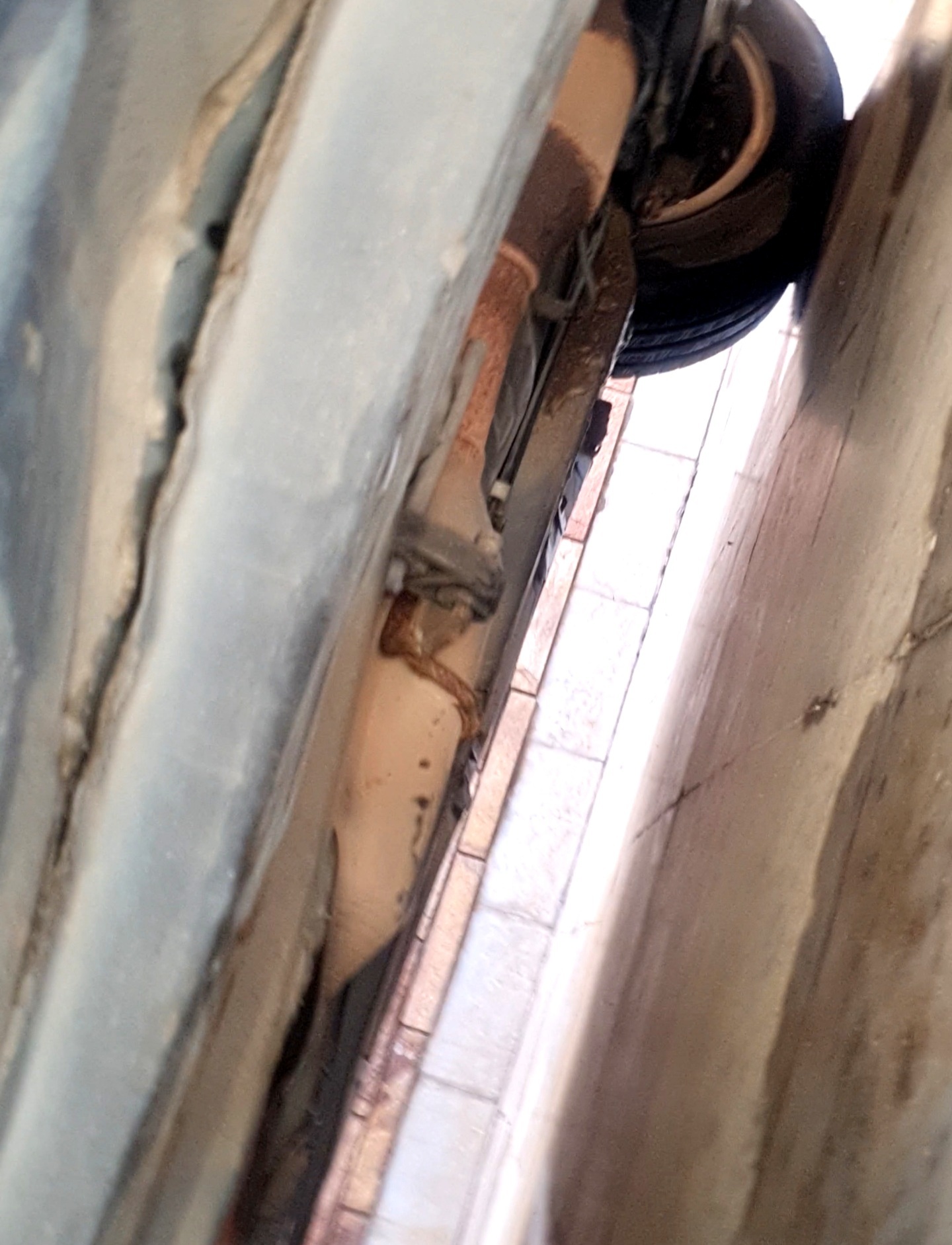

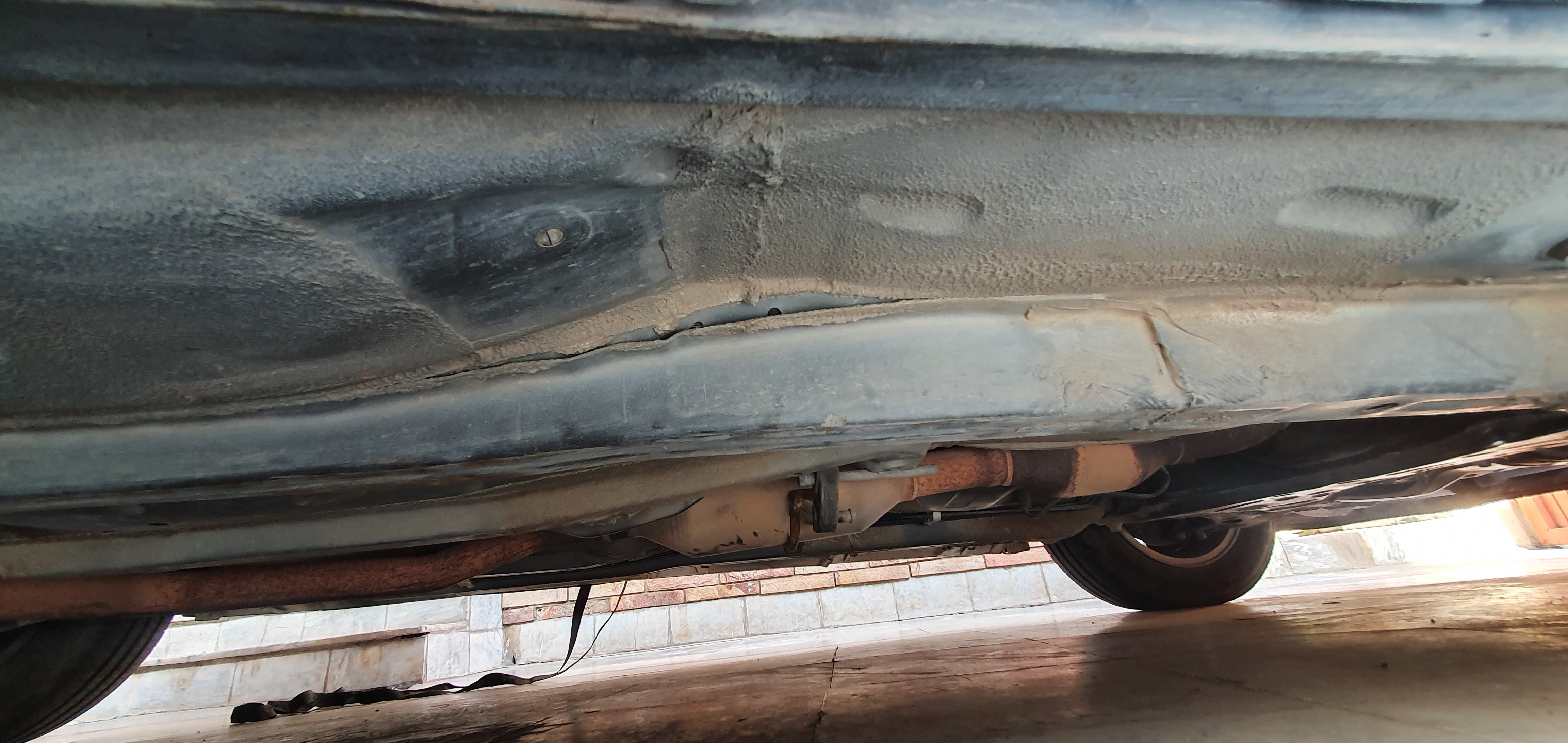

Aoa guys car is 9/10 corolla altis old model. Yesterday during car wash i found out this thing benath right side of car floorKindly suggest me any solution The body is intact from the other side as seen in second picReference pictures are attached

Obv something hit the car underneath and pushed the floor inwards. Shouldn't be an issue
Bro kindly advice kran is ko as it is chor do ya weld waghara krwa lou pull krwa ka denter sa. Kiyunke is ma shyd paint bhi ho
Weld na karwaein dent pull karwake normal paint mardein. Rust is the only concerning thing. Baki kher ha
Brother ak advice dain. Dosri side sa tu intact hai. Is sidelar aga rsilicone laga kr fill ap kr doun upper layer si bna kr. Ta kai pani andr na jae ? Tu is it ok. .?Actually ma khud welding nhi krwana chahta ?
Dent pull ka loye bhi hole krain gai body main ? Asa hi ha na bro ? Agar asa hi chor do upper silicone si laga dou ta kai pani na andr jae tu is it ok ?
I suggest you going to a good workshop and showing them the damage. App unse estimate lelein. Agar water Jana ka issue ha to phir apko welding karwani paregi. Agar frame rails me Pani Jane lag gaya to frame waqt ke sath destroy hojay ga.
