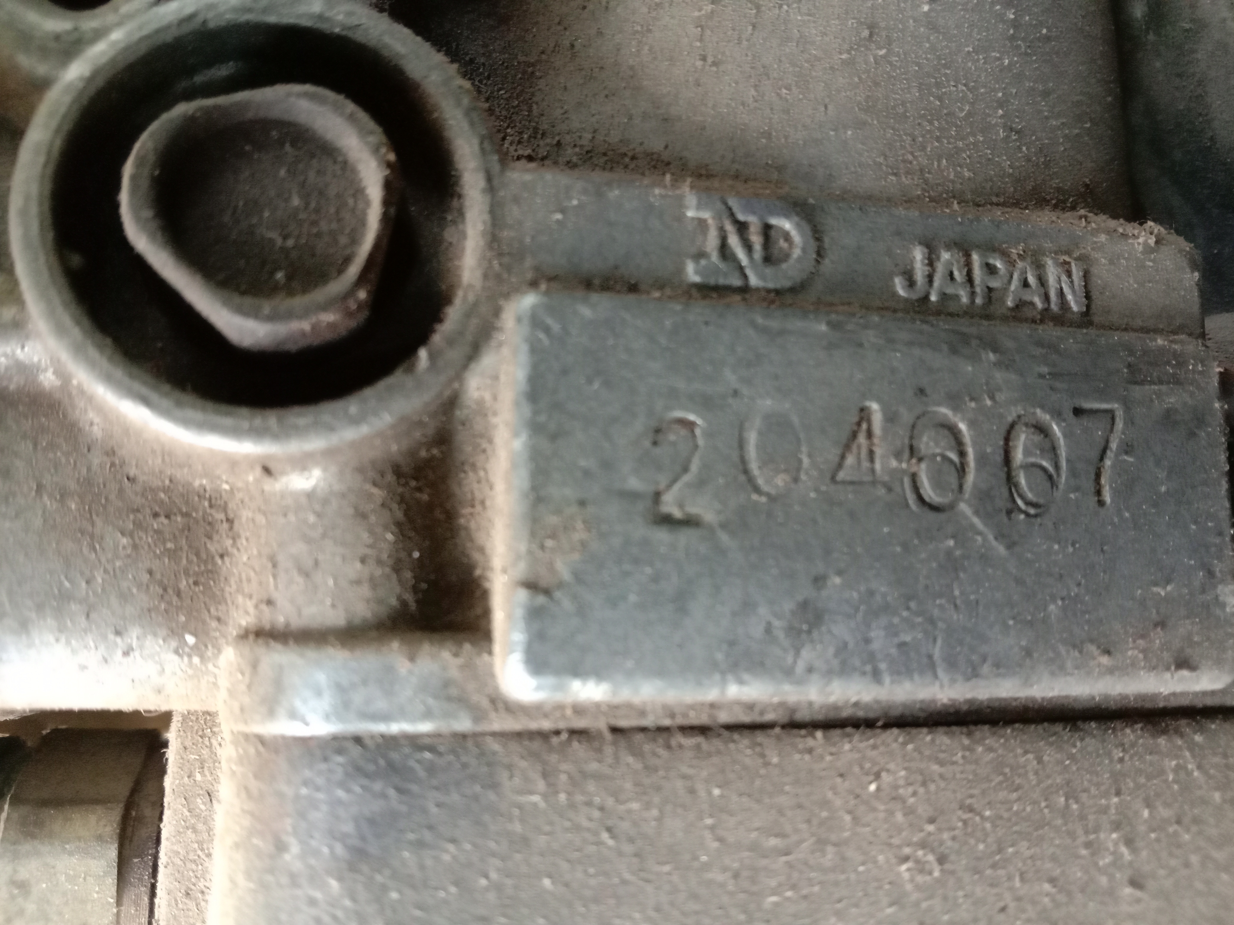

4 is the pump from a turbo engine? (Has the boost compensation device)
I am not sure, showed this to Waris Shah lab in Gawalmandi and he didn't say anything so I assume that it is genuine turbo pump. Here's the picture:
5 how did you time the pump to the engine?
Waseem Diesel lab technician on Tipu road made some adjustments and he told me that pump needs to be repaired but first I needed to fix the turbo or get rid of it. However, starting and overall performance got a lot better after he did something to the pump, the only problem left is bad fuel economy, it isn't giving more than 14 km/l in city traffic. Not too much traffic jam and very low rpm driving.
