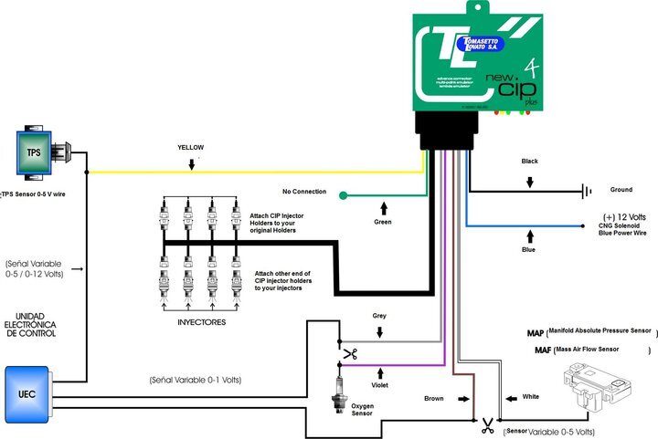

I have replaced "Timing advance processor and emulator" (1+1) from neotek with Lovato Tomasetto cip 5 (2 in 1 advancer and emulator). I have complete wiring as per given diagram.

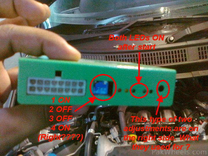

After starting the car, there are 2 green LEDs ON while it should ON only one green LED of Idle rpm. It also gives P0105 MAP sensor error code. what i have missed?
Can anybody tell me about the right side two variable adjustment in the holes? (I know that the front one is for advance adjustment).
Help from experts is required.
