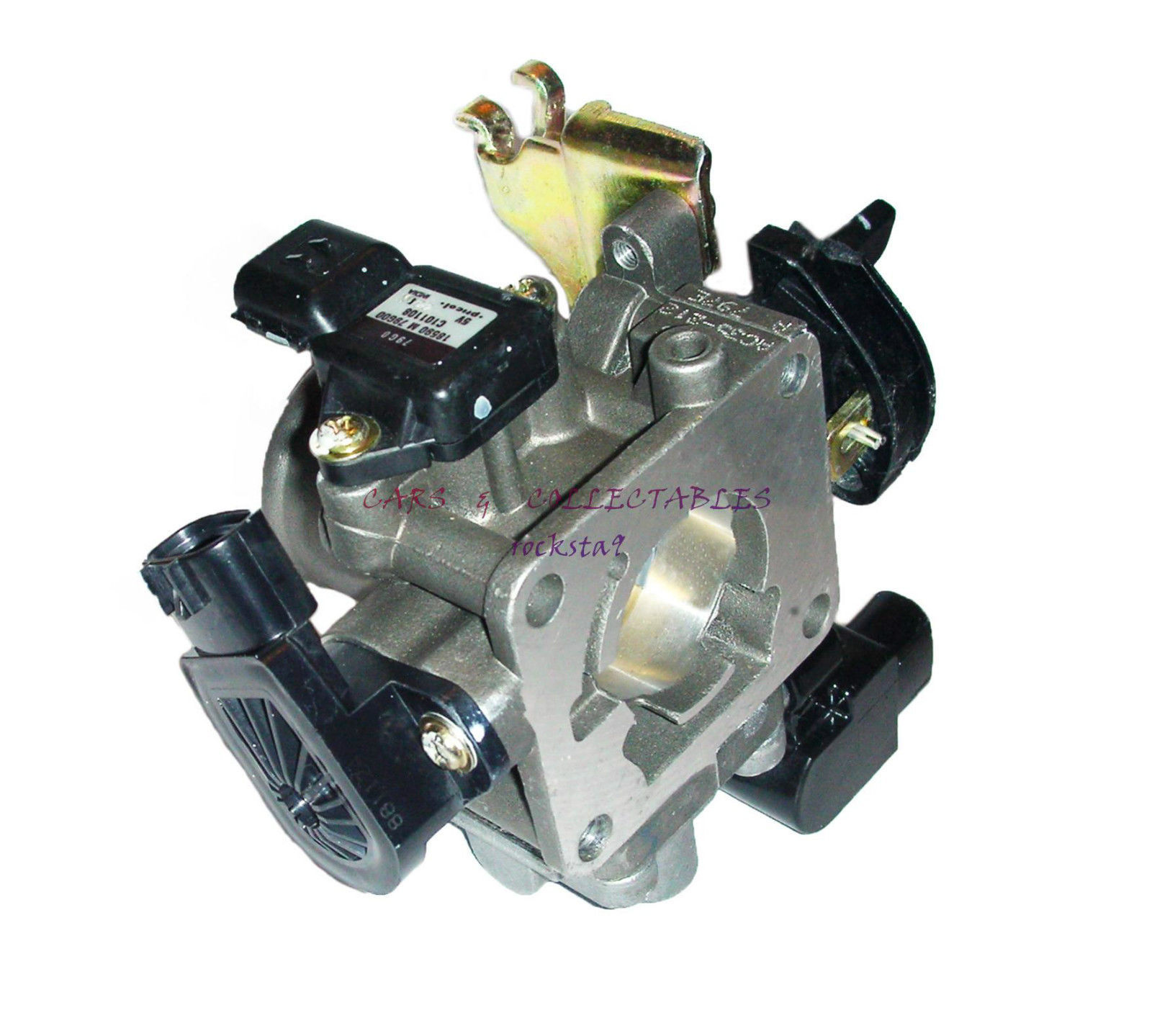

Visited last week and got its injectors (have been reading from internet and thought that injectors would be the culprit) and TB cleaned but that didn't solve the problem. Now I suspect the IAC (if I got the name right, the sensor / motor at the top of throttle, see pic attached at the end) as its adjustments were broken when the mechanic unscrewed it or the TPS as the mechanic didn't clean it (saying that it doesn't need cleaning)
