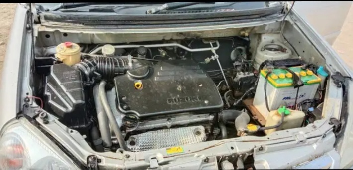

Salam All,Please guide me im looking to buy a 2012 liana in lahore if anybody has any good car at reasonable price please do contact and also im worried about soare parts availability and prices as i read many times about expensive spares also i have notice two types of engines of1300 cc engines in older cars its different and in 2012 engine is different
Engines are same since 2006.Its just factory fitted cng liana has thin cover and bigger cover comes on non cng fitted liana. Engines are same.
