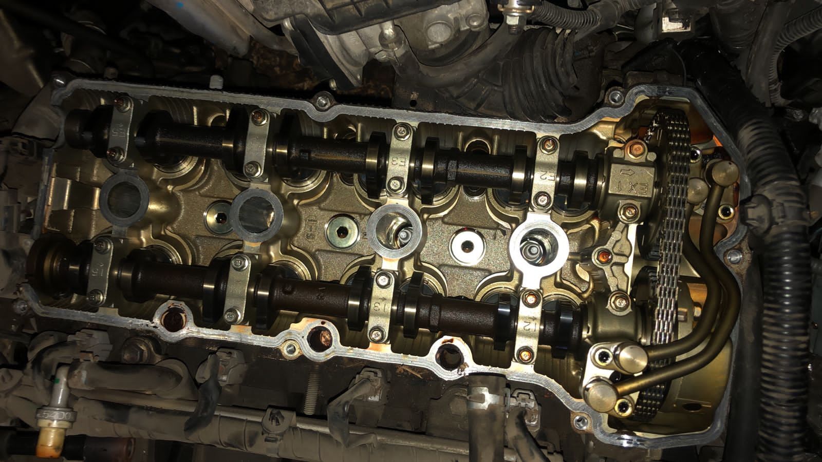

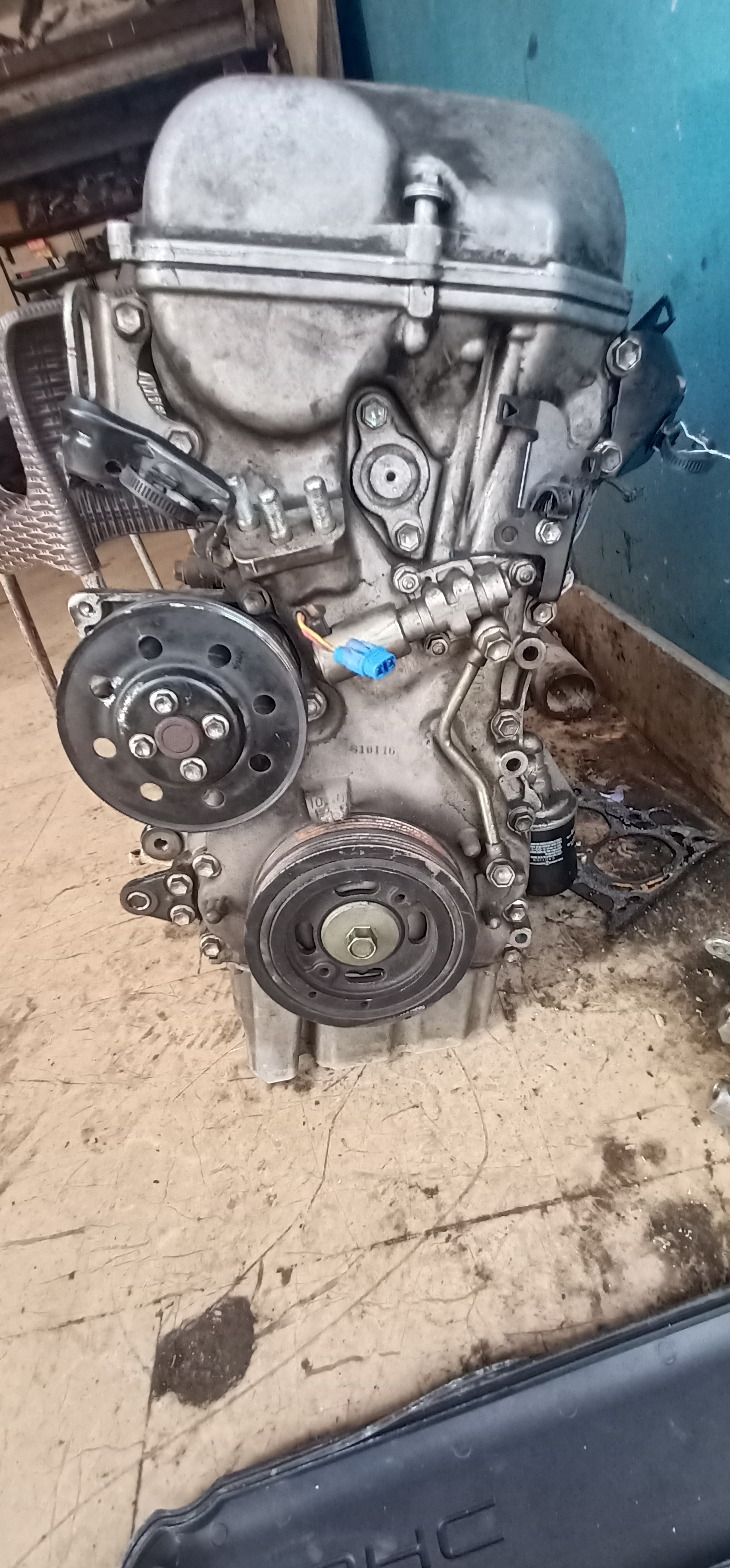

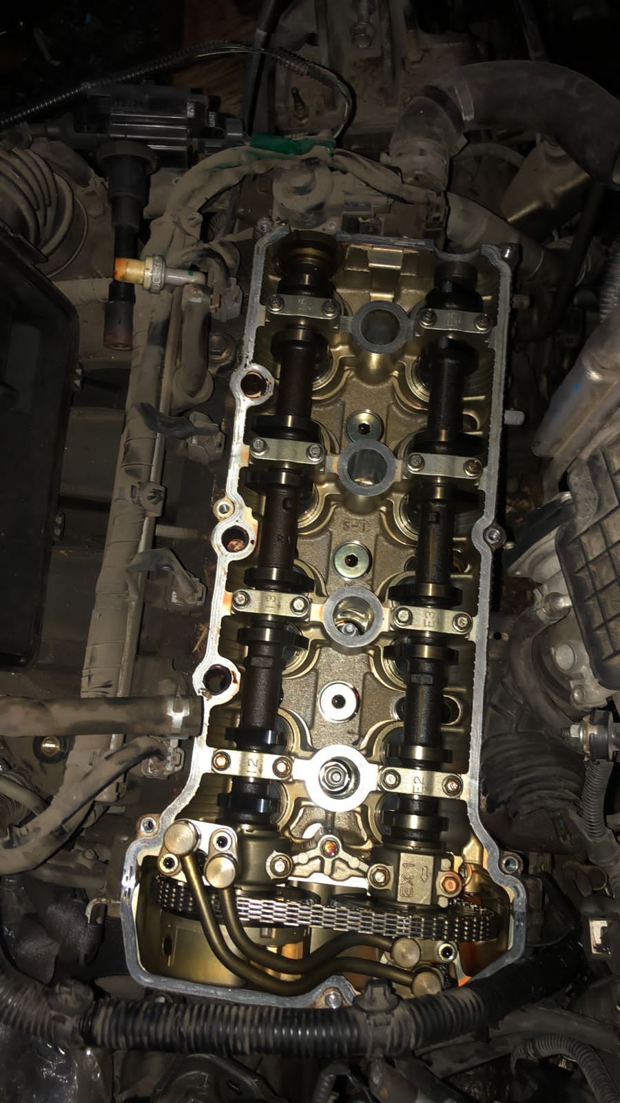

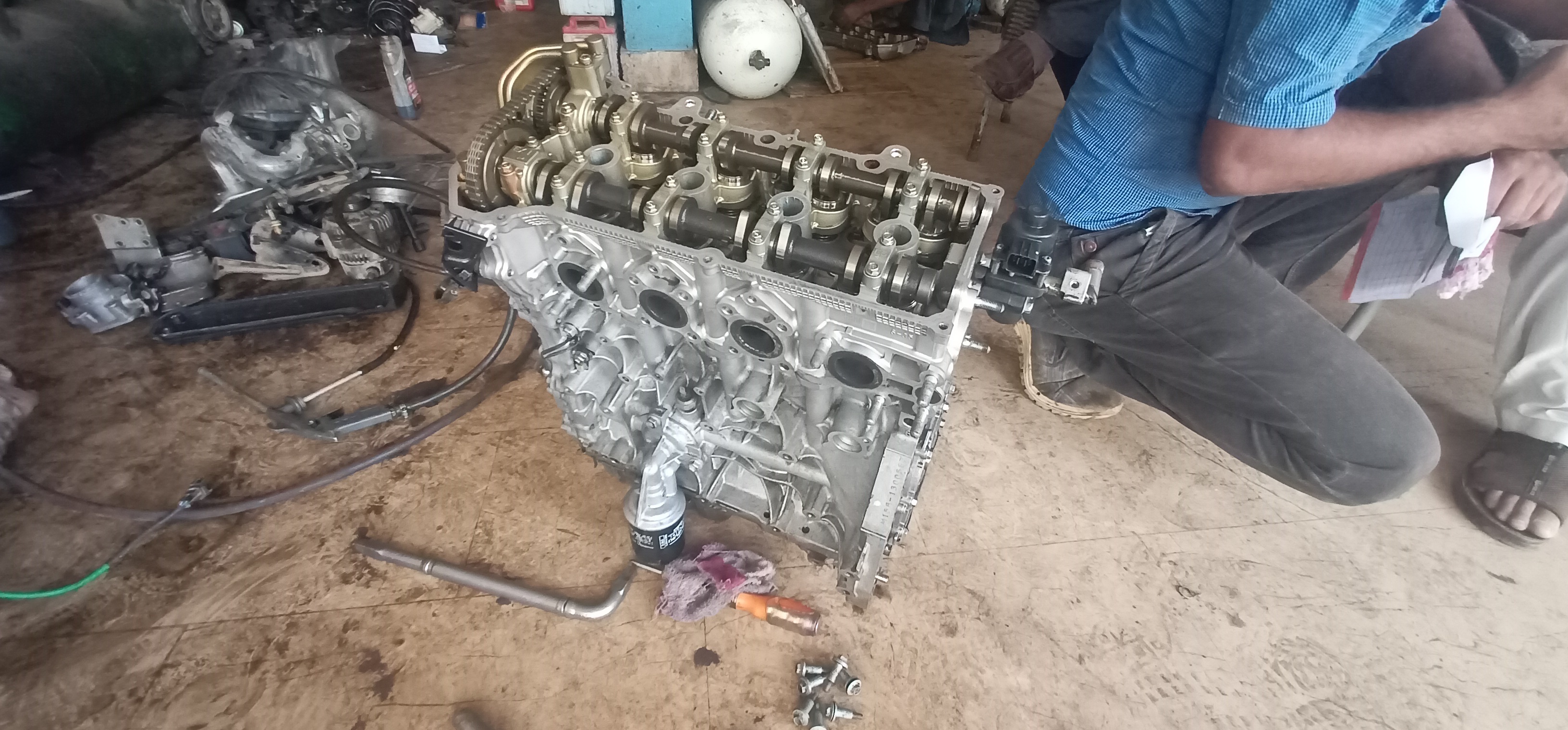

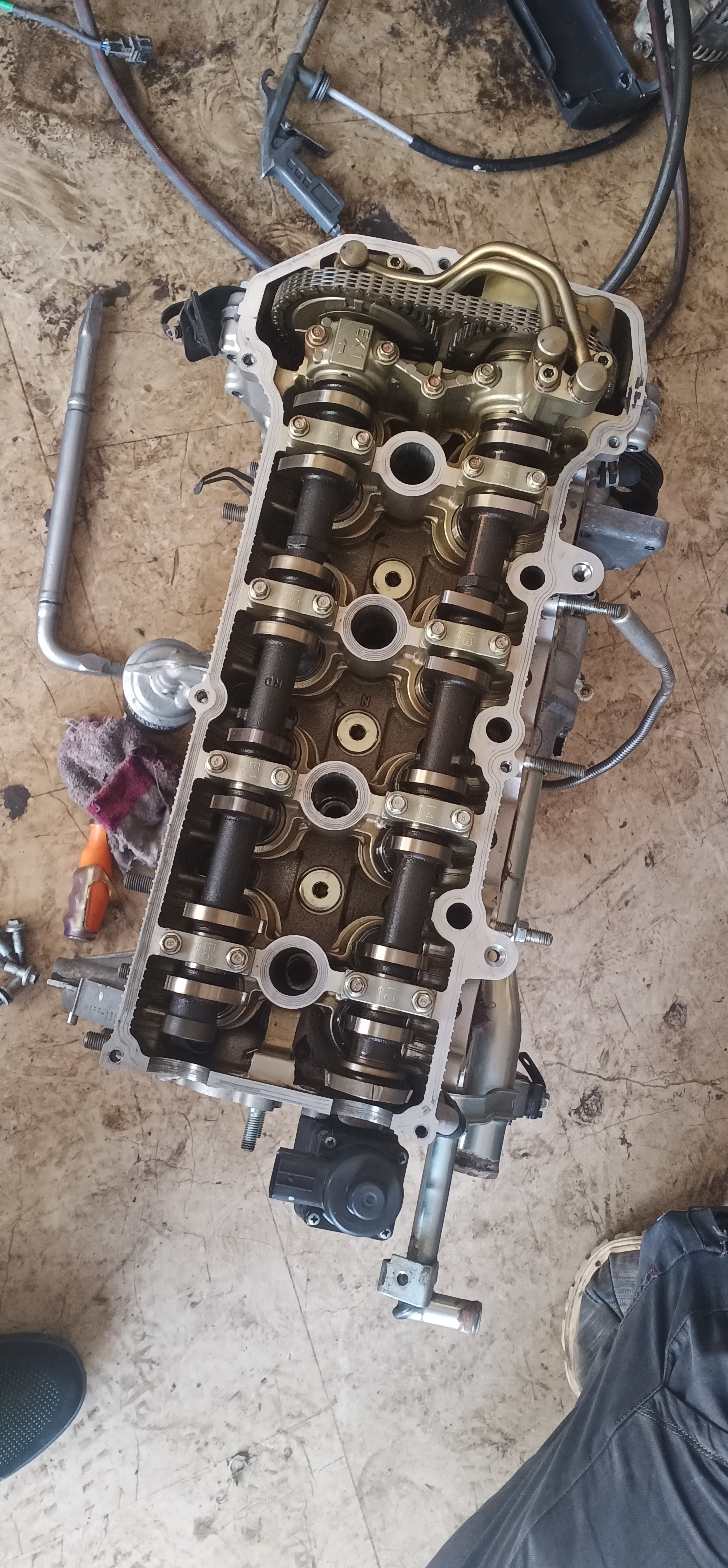

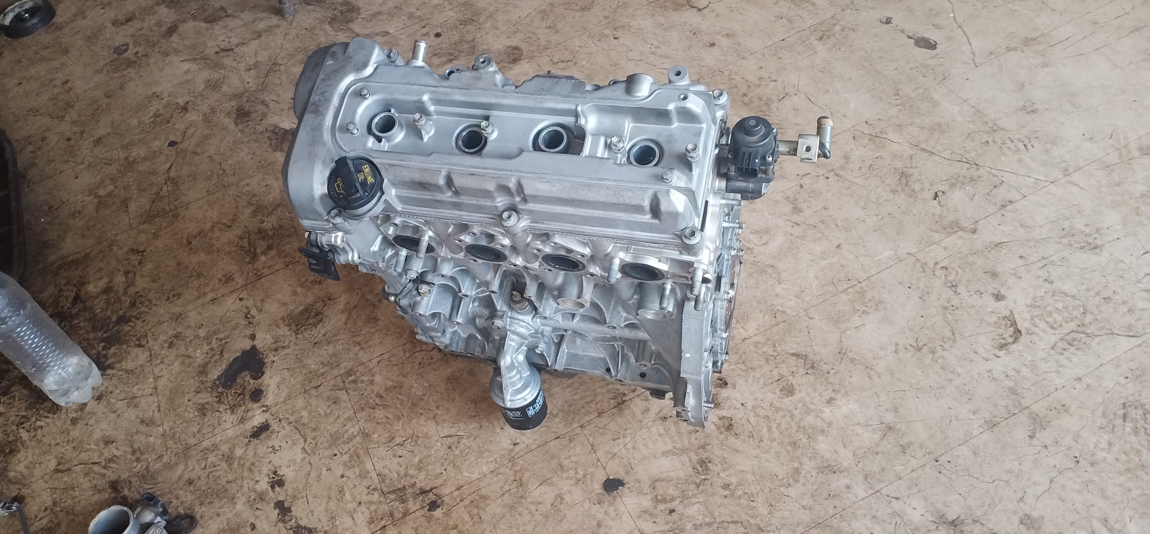

It's vvt engine but can't active because need card & wirring mean 25k extra so I have no extra budget

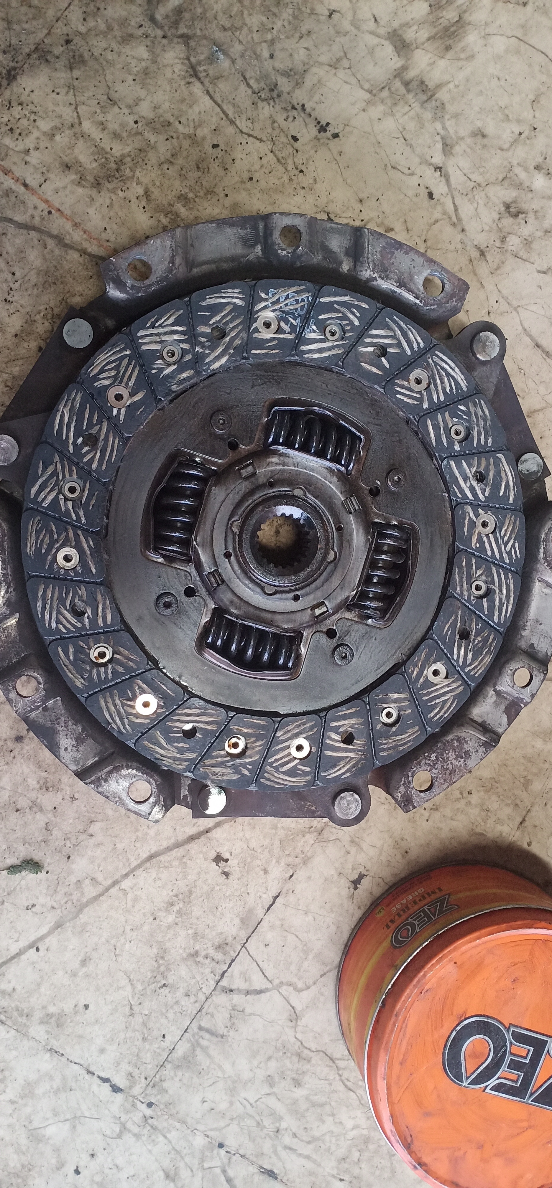

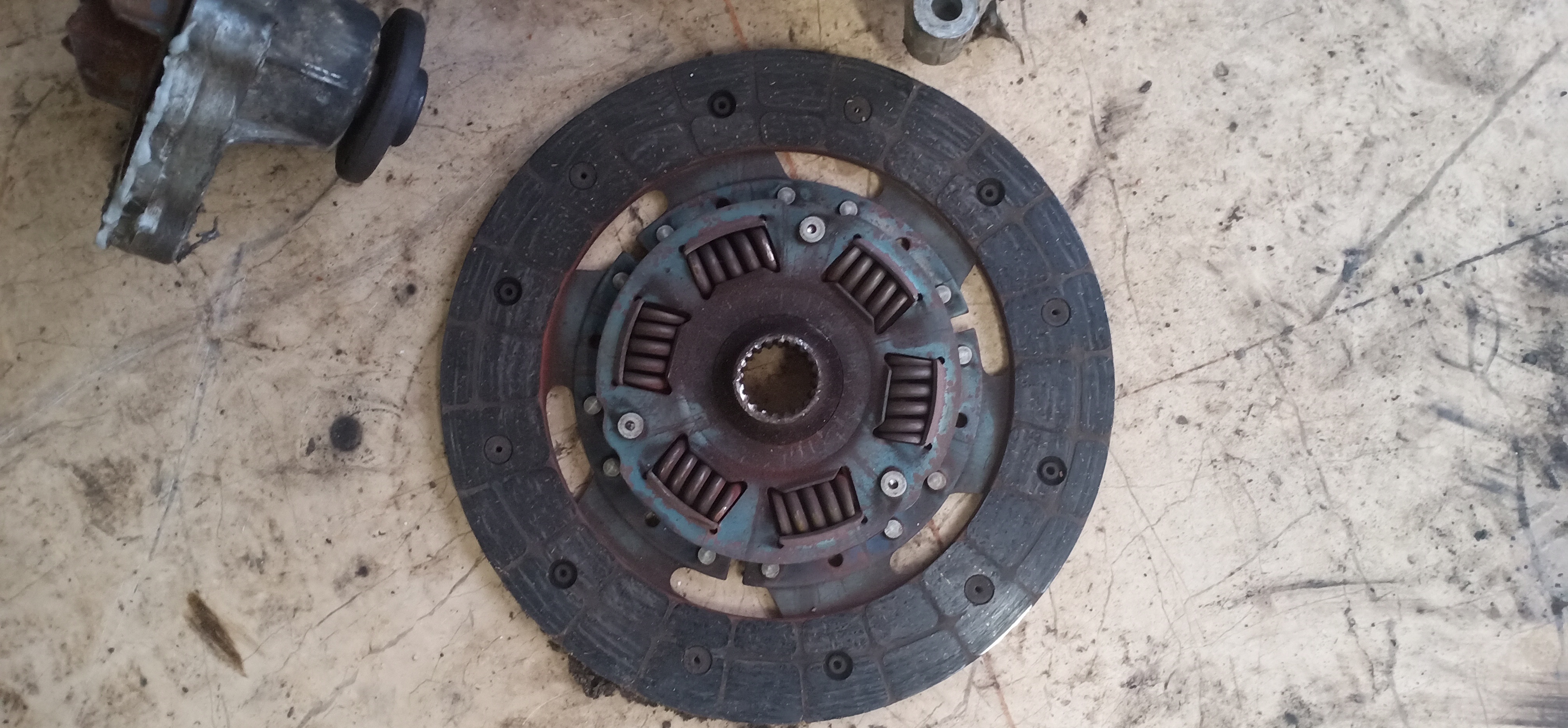

But my old engine clutch plate's khatam the

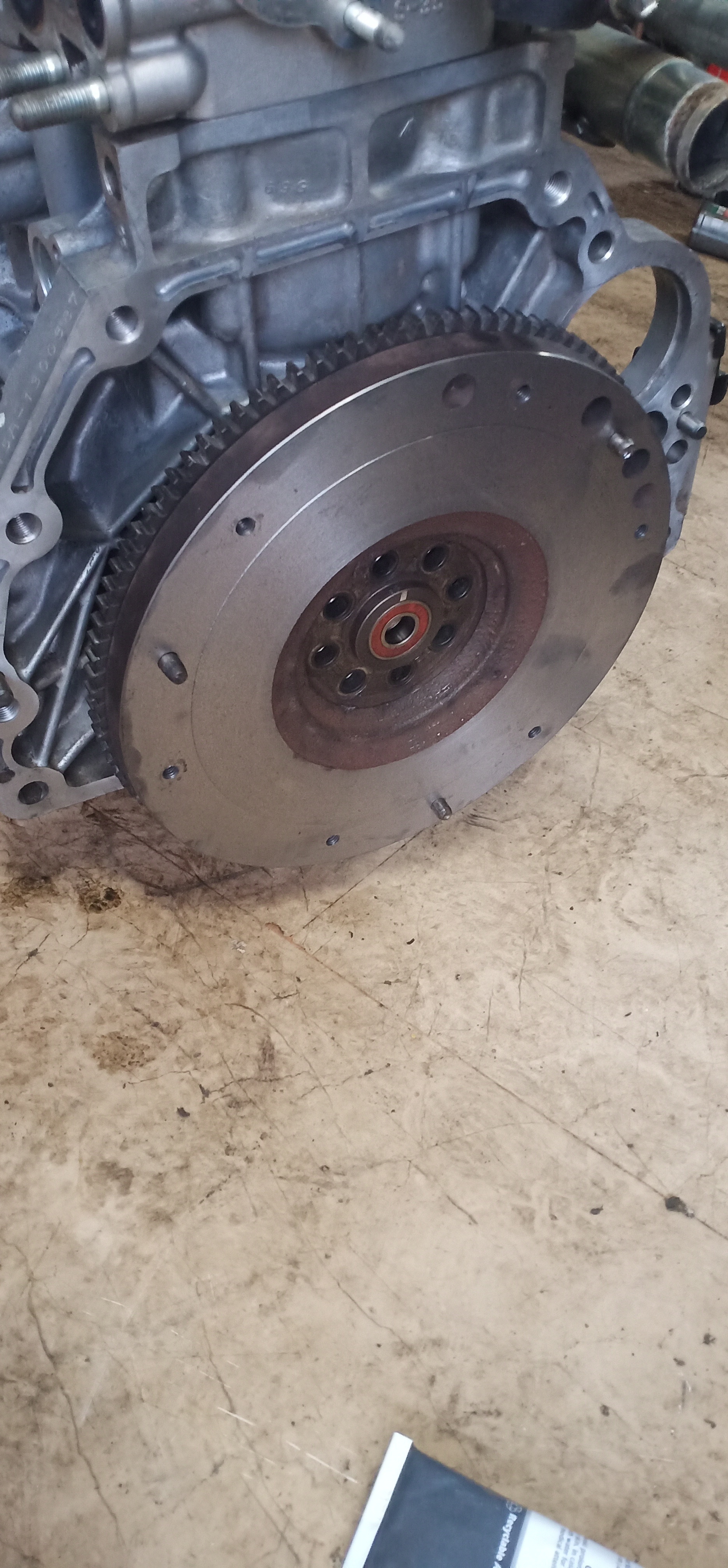

But pressure plate or fry wheel leath per OK ha just plate pitches ki 2500 m
and now assembly fitted properly Allahmdulilah
Voice like zero meter engine MashaAllah
No any vibration automatically with settings Rpm comes on idl position 650 some time i feel like engine is off Allahmdulilah Pick up is Shoot amazing result Clutch to much soft
Honda SAE 10w40 API SN blue DA be wala
Plugs Japanese assembly wale IR Lesar=IR DIFR6D13 blue type writing m tha
Mane to new NGK k purchase kiya tha 1600rs wale but mechanic ne kaha bhai y assembly wale 9k to 10k tak ha bhale ap market malom krle apki marzi phr jab malom kiya to waqai rate 13k tha phr wohe Japanese lagwai mane..
Allahmdulilah perfect 🤲
Total Cost assembly exchange 54000 with +Labor 5000+ wiring3000 leth 1500+Clutch plate 2500
Oil filter+ 3450+ new belt 2 +1200
Total lamsome 71900
