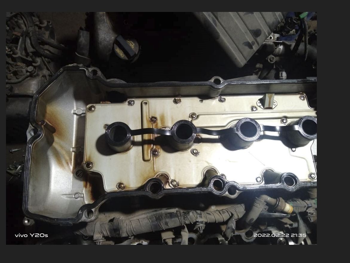

i did conversion with my 07 Liana, swapped complete M1.6 with Auto tranny imported from japan, did wiring used 1.5 TCM and ECU , computer scan is clear no code shifting and all is good
only issue is detonation/knocking at idle vibrate and make sounds, for sure no cam or barring sound, looks like pre ignition or timing issue, using G Power plugs with original coils, 5W 30 Kixx oil engine was clean on pistons and head cover
please guide what should i do to make it smooth

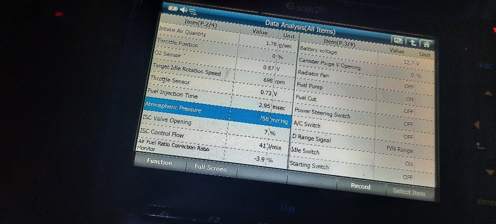

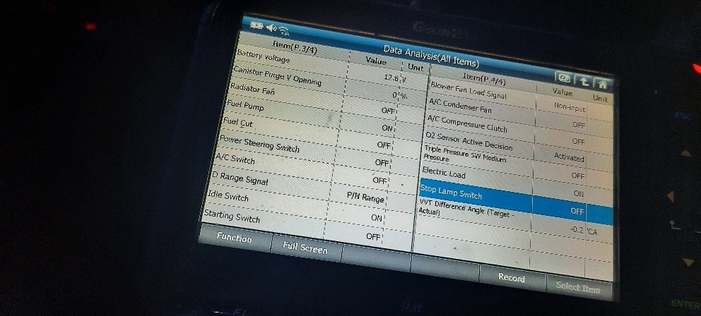

please see these scanner pictures and guide
