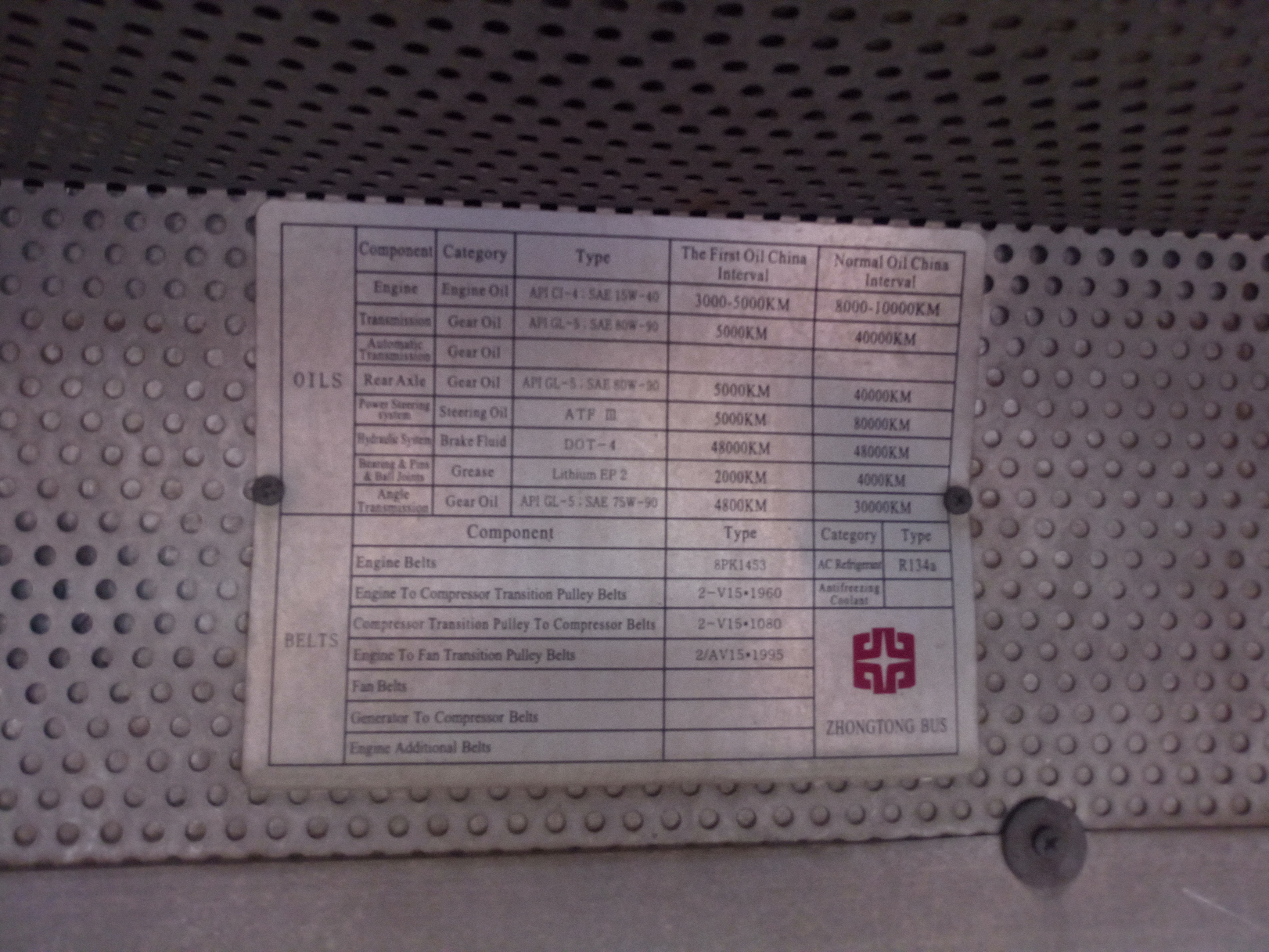

Glad to see that some manufacturers are installing such plates within Engine bay to provide guidance regarding Oil and Fluid types, category along with their change/drain interval.
This is recent image from Zhong Tong Engine Bay (Diesel Engine).
