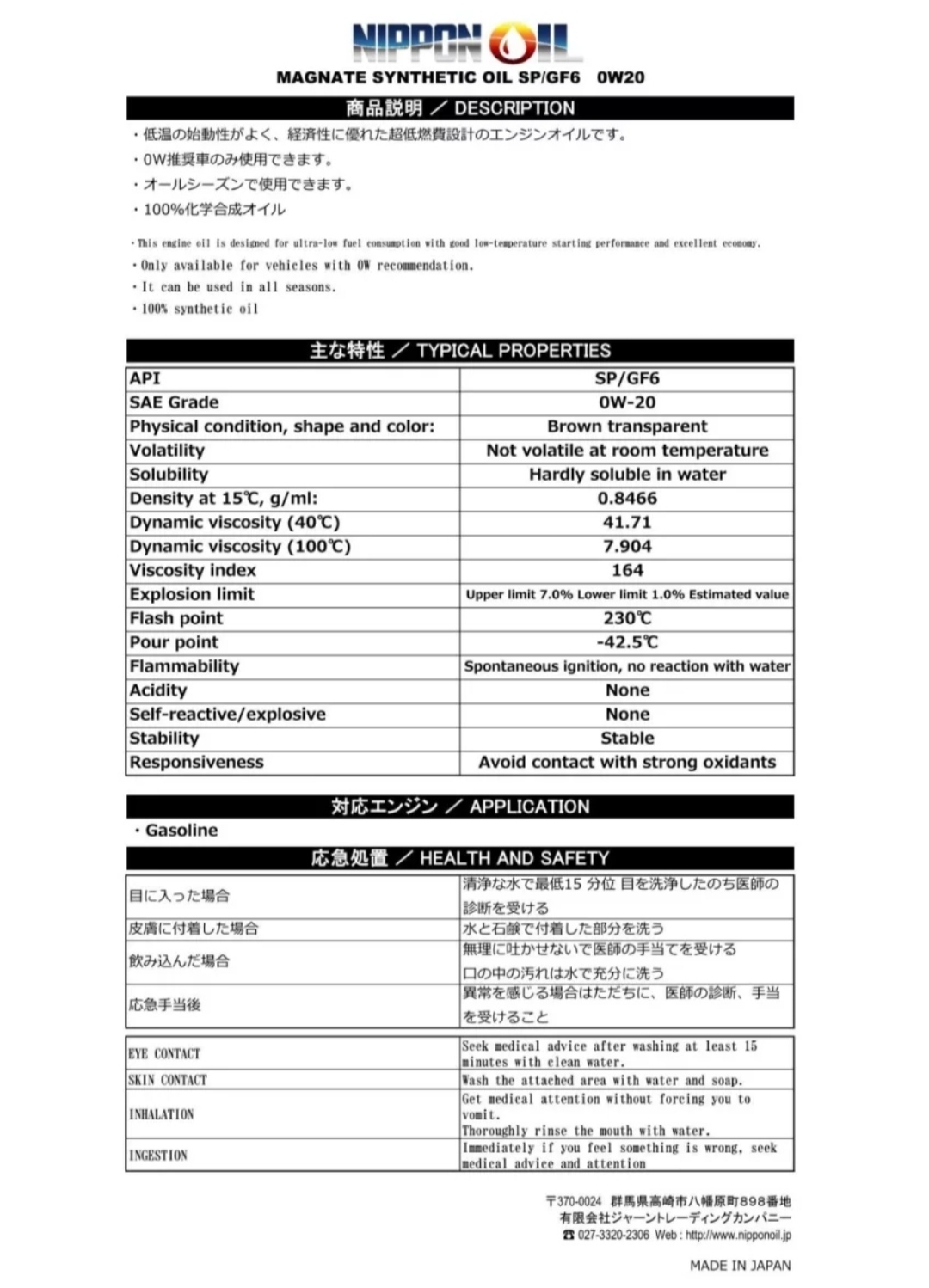

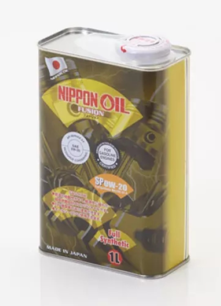

Just promotiing their brand, nothing more than a normal marketing strategy.
