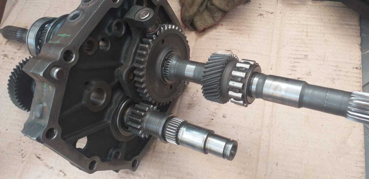

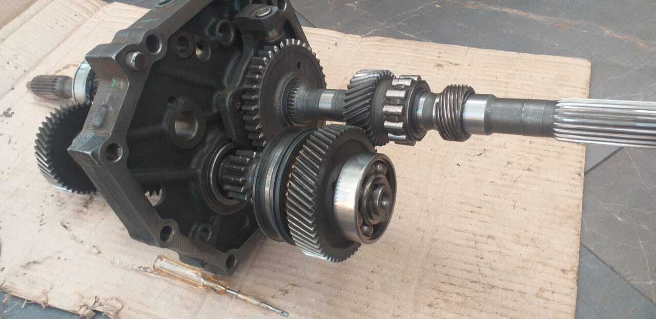

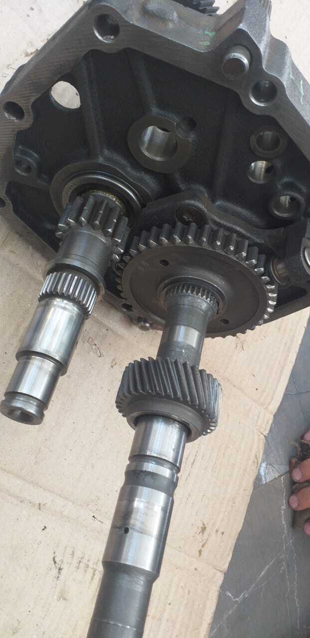

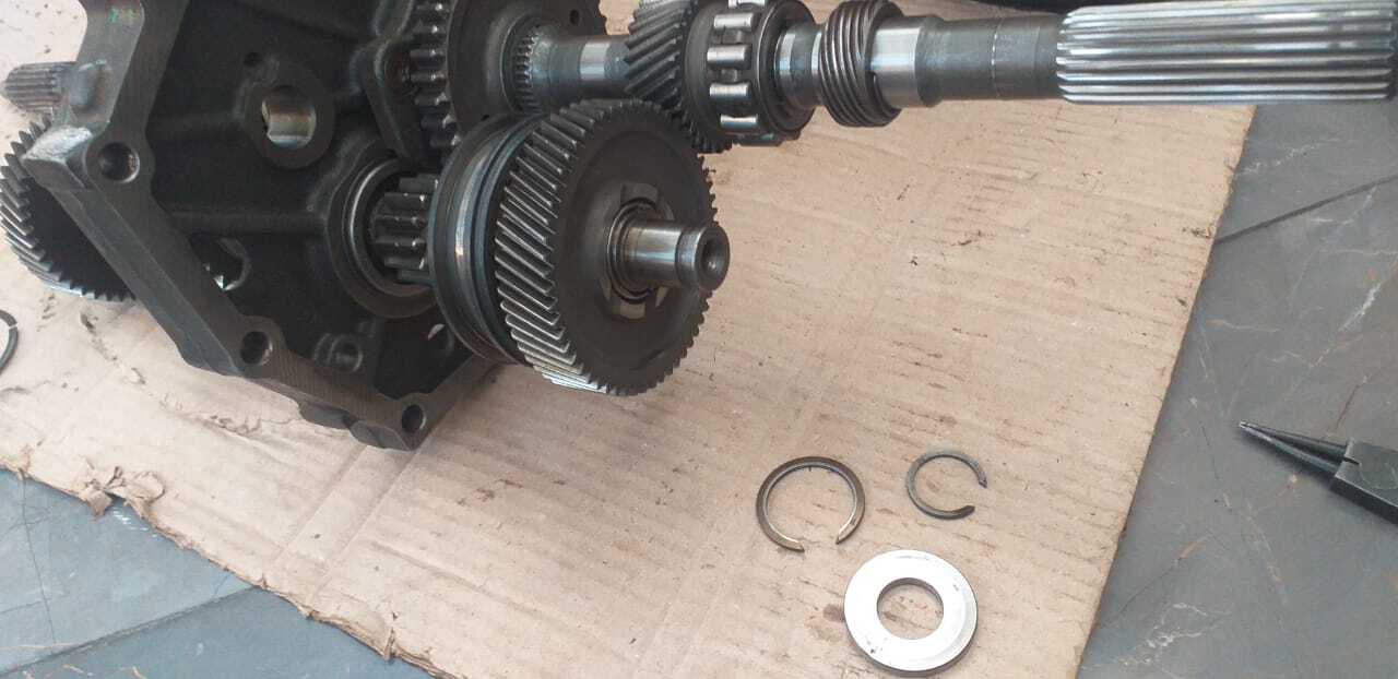

next is the reverse gear , 5th gear , roller bearing and the speedo meter drive gear ,,,,,,,,, all will go on output shaft ,,,,,,,
speedo meter drive gear ,,,,, goes on output shaft ,,,,,

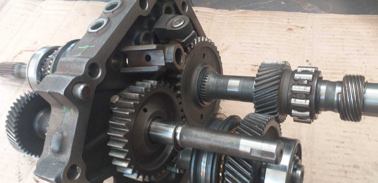

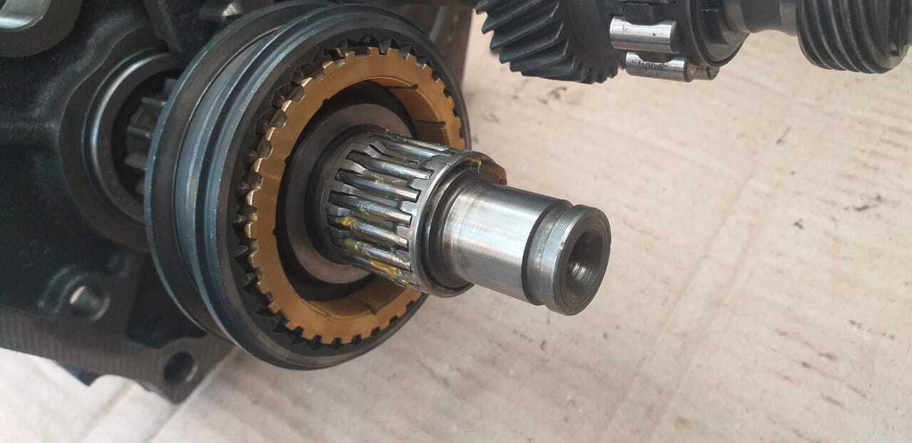

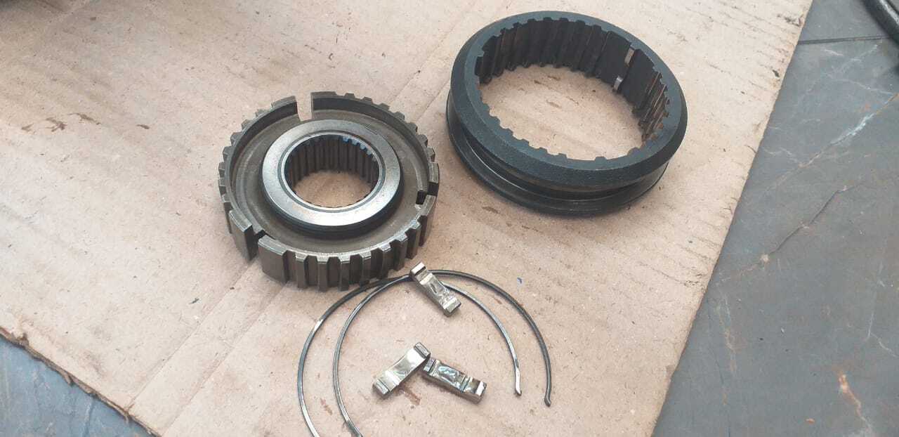

next is the 5th gear clutch hub with hub sleeve ,,,,fit on counter shaft ,,,,,,,

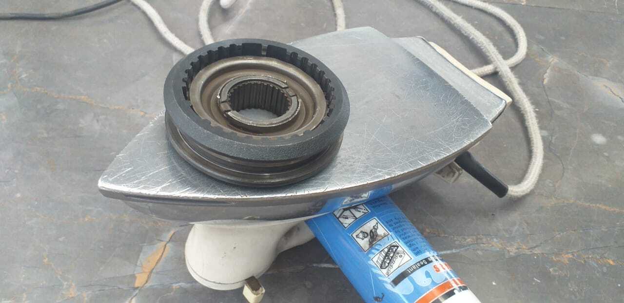

assemble the clutch hub and heat it up ,,,,,,,

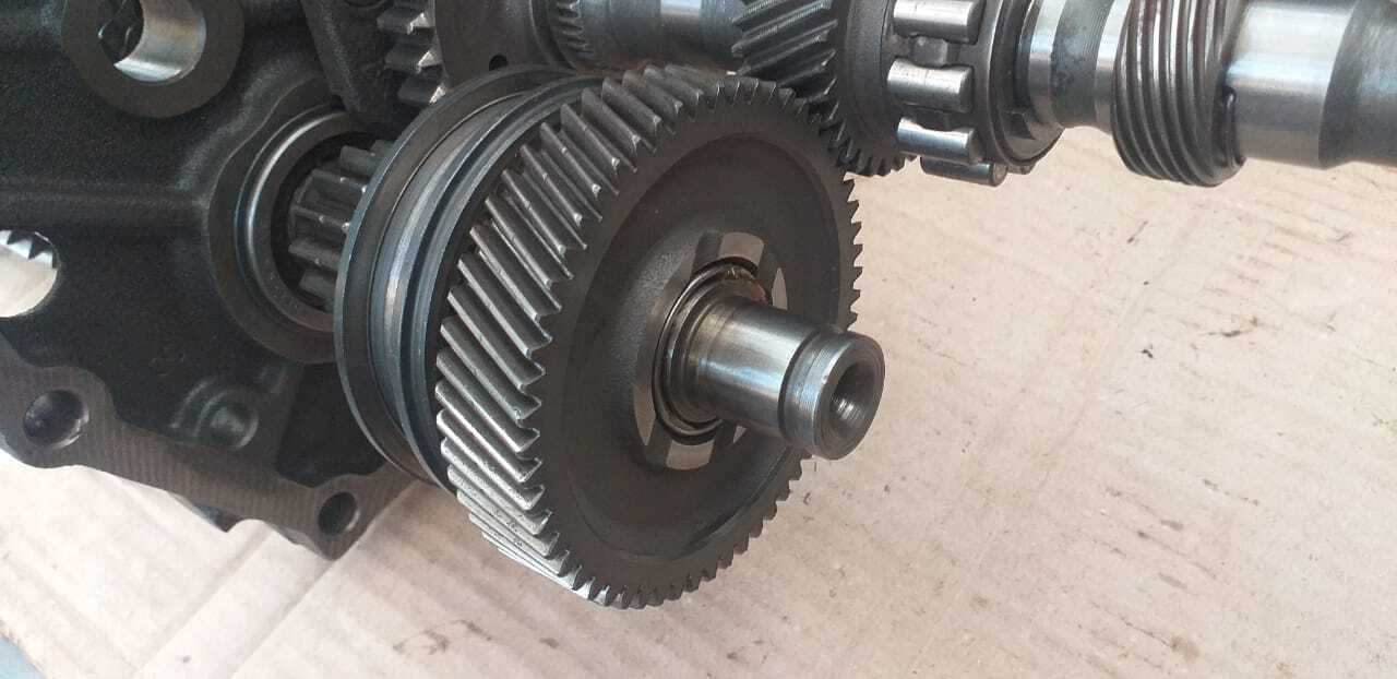

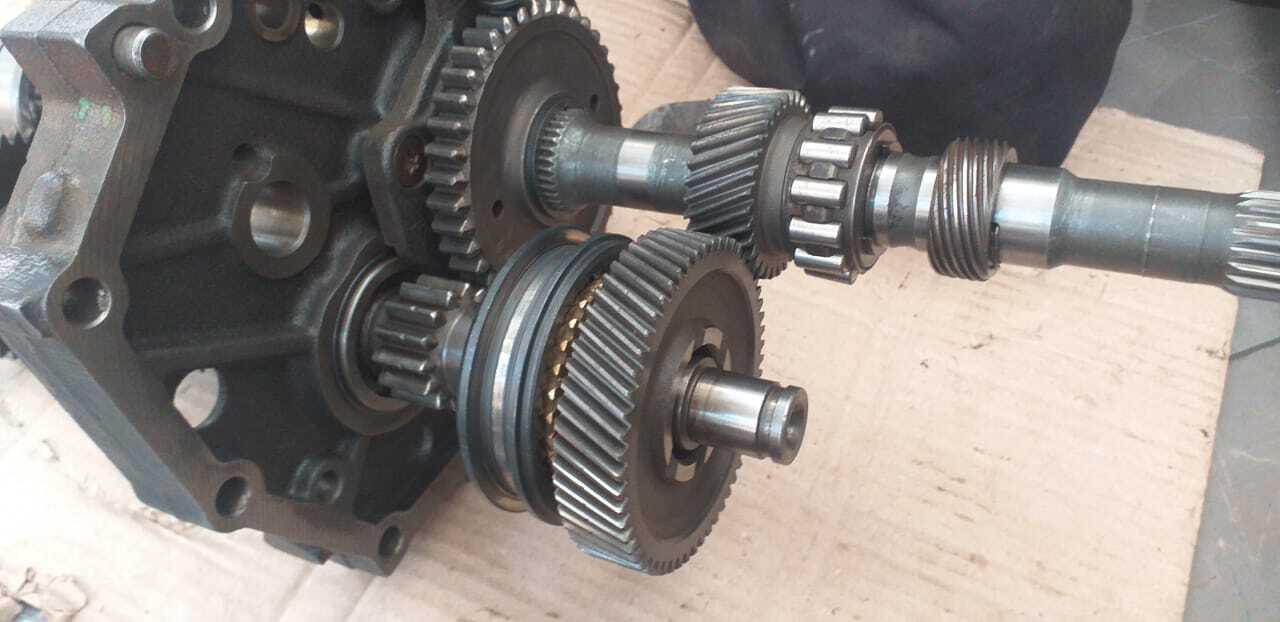

5th gear clutch hub and hub sleeve fitted on counter shaft ,,,,,,,,,

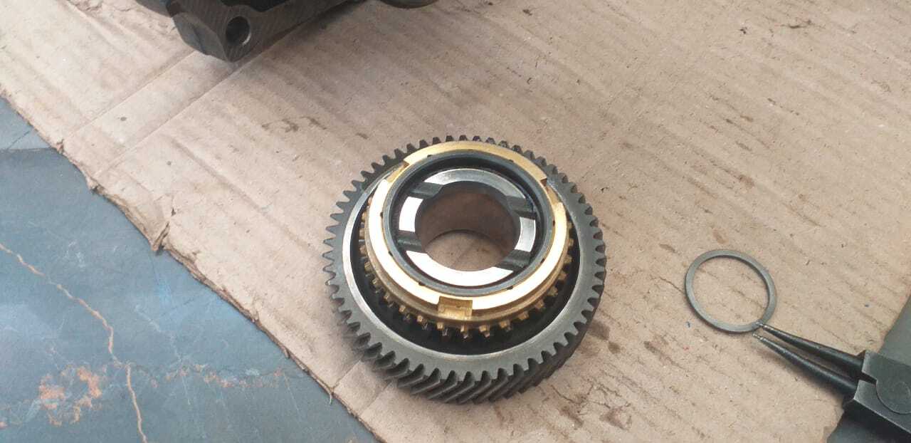

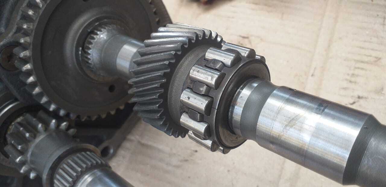

5th gear counter gear with synchronizer ring,,,,,,,,,,,

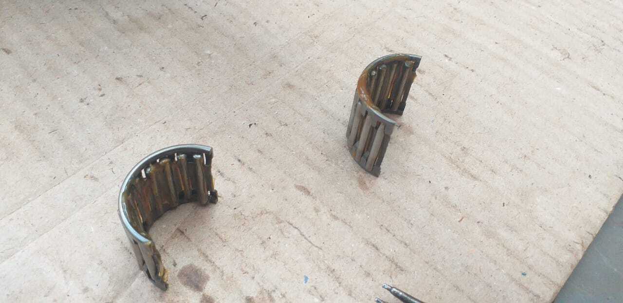

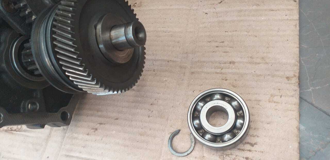

5th gear roller bearing ,,,,,,,

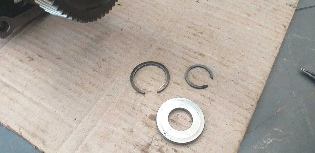

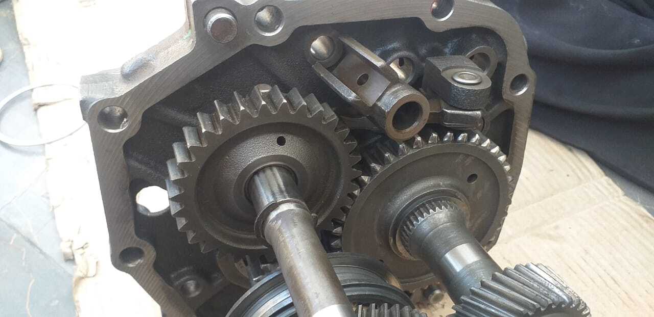

spacer and snap ring of 5th gear ,,,,,,,

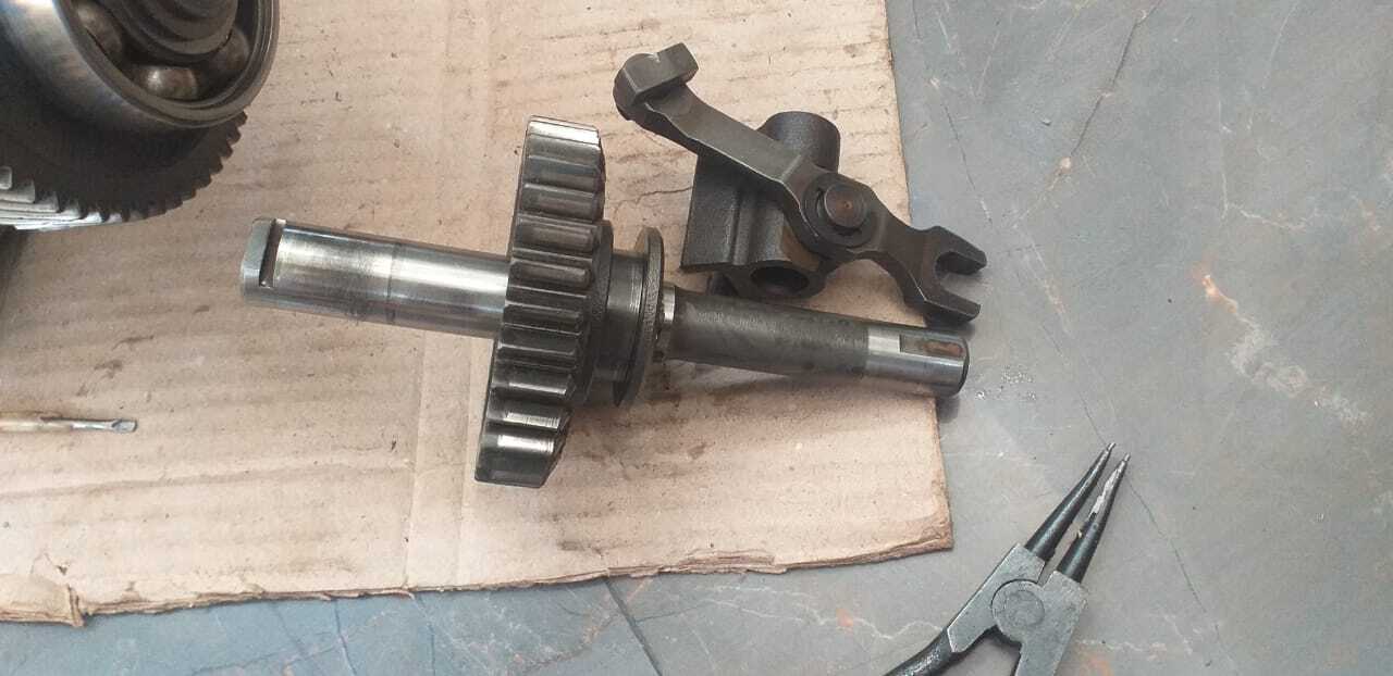

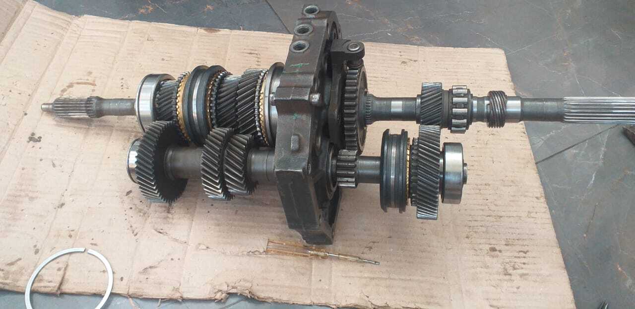

counter shaft completed ,,,,,,, now reverse gear and shifting fork are left
reverse gear ,,,,,,,
