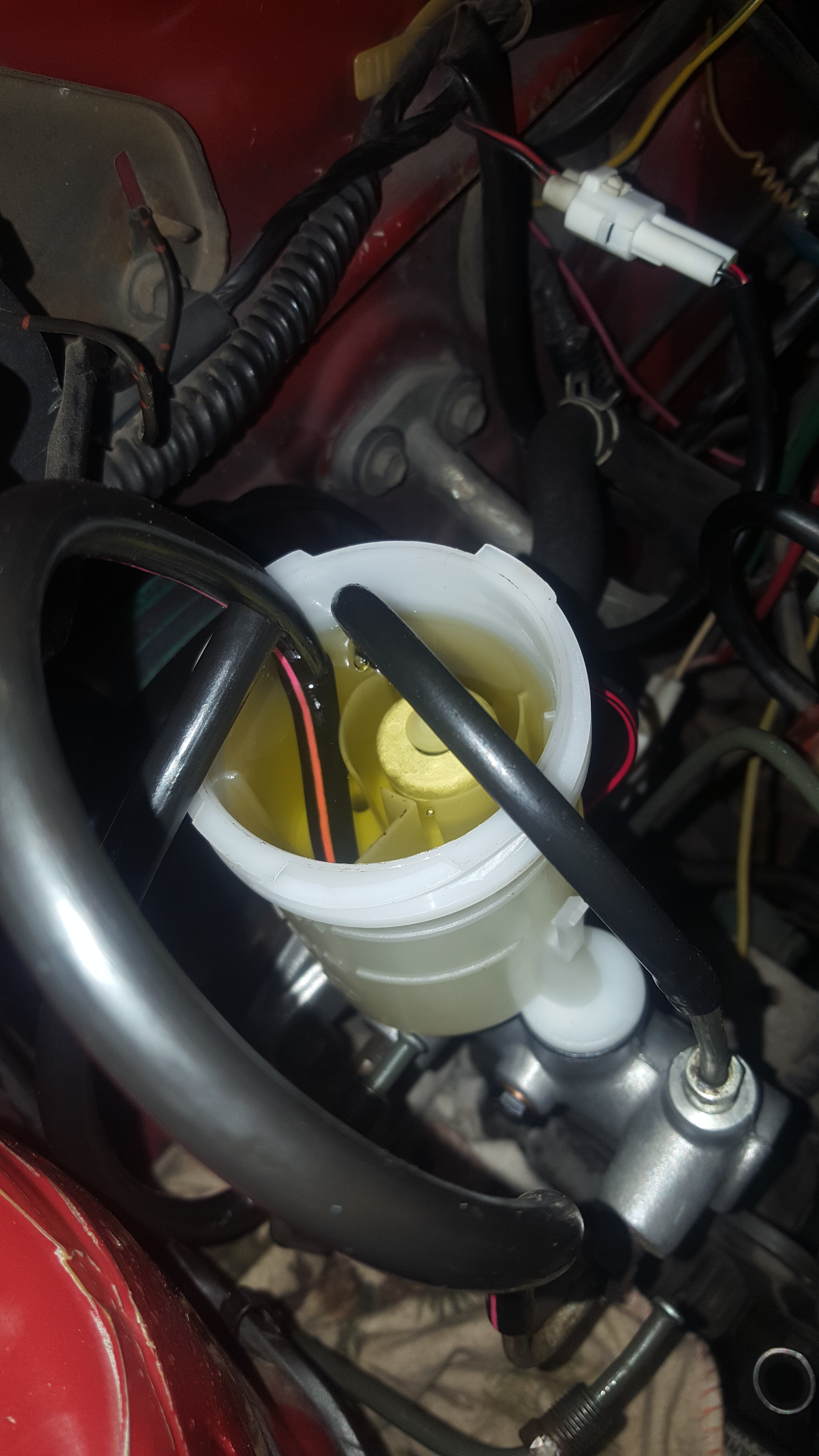

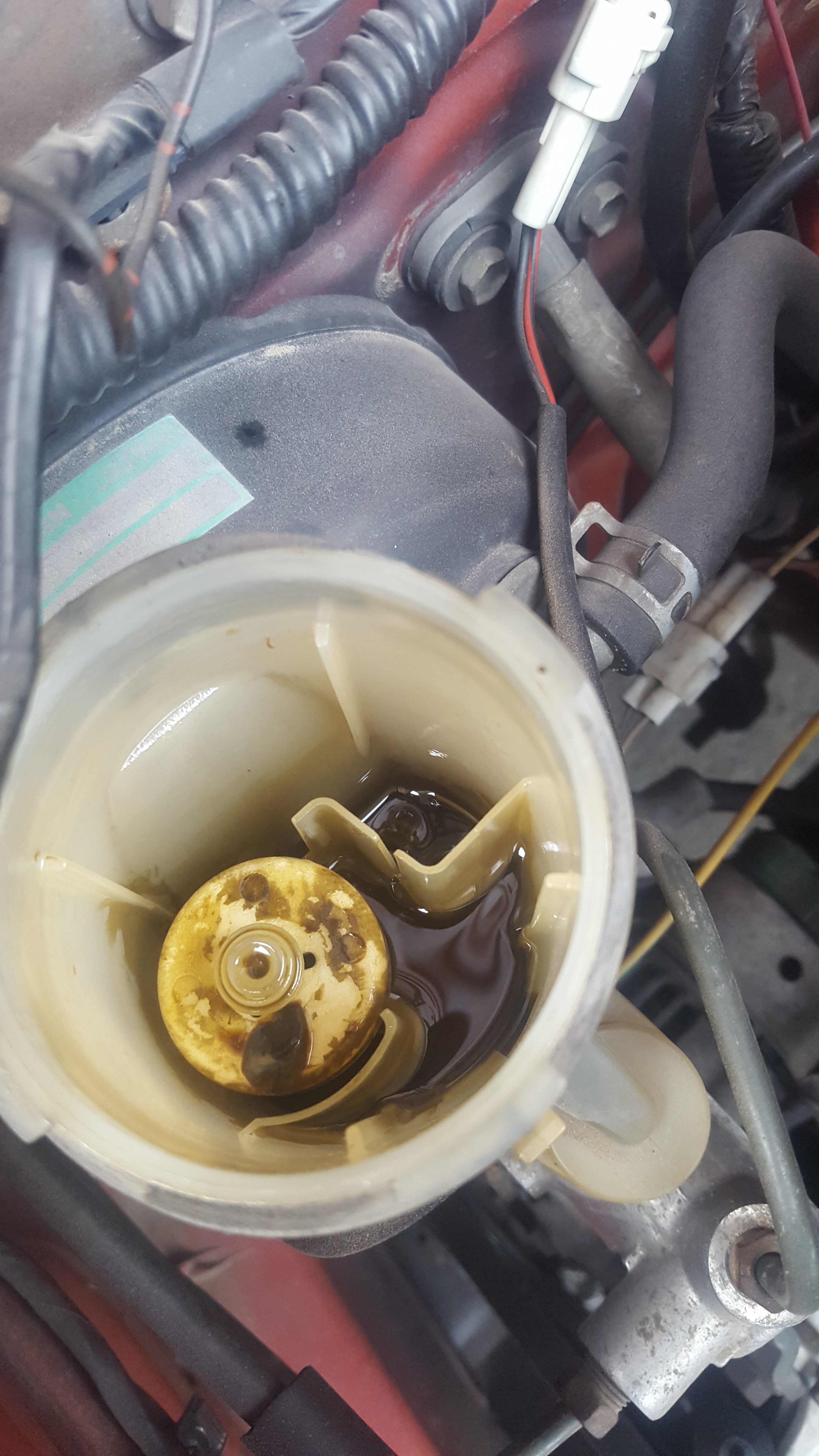

You have replaced the master cylinder because its rubber seals became too old and leaked, and you are already planning a rear slave cylinder overhaul. At this stage, it would not be unwise to perform a full caliper overhaul on the front brakes.
This way you'll get to replace all the brake fluid, and (most important) the main washers of the front slave cylinders.
