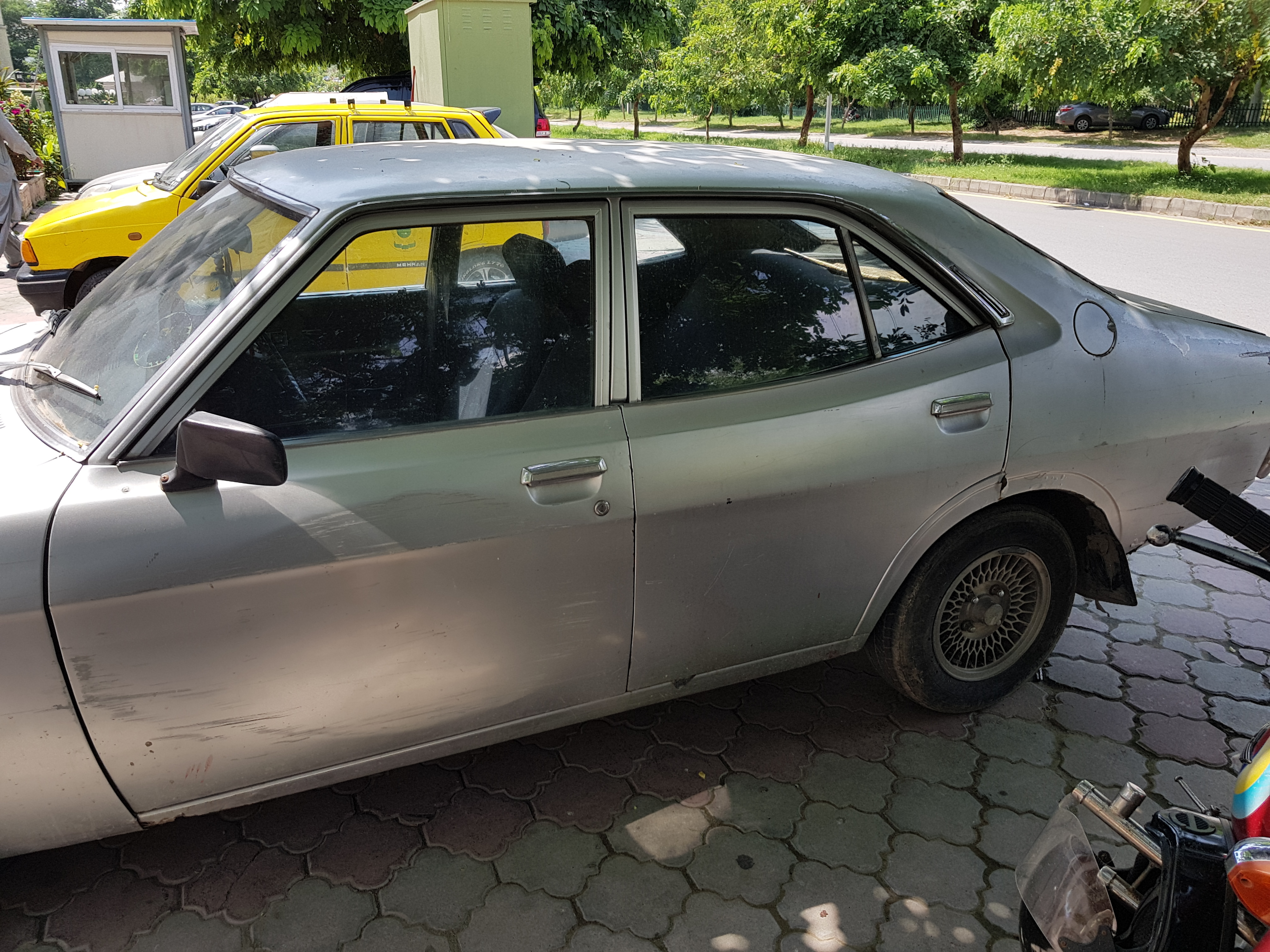

I was looking for this car since last 3 months and finally got one! The car was with second owner since last 35+ years nd parked for last 4 years because the person was unable to move - Now they needed cash so they sold it nd i didnt negotiate on their demand!
This car has a 2c diesel engine with auto gearAC installed but gas needs refillingAll spring suspension/No leafspring And rest the images will talk
Car seems to be in very good nick. Best of luck with project.
Are those bbs? Look really eye catching even if they aren't,

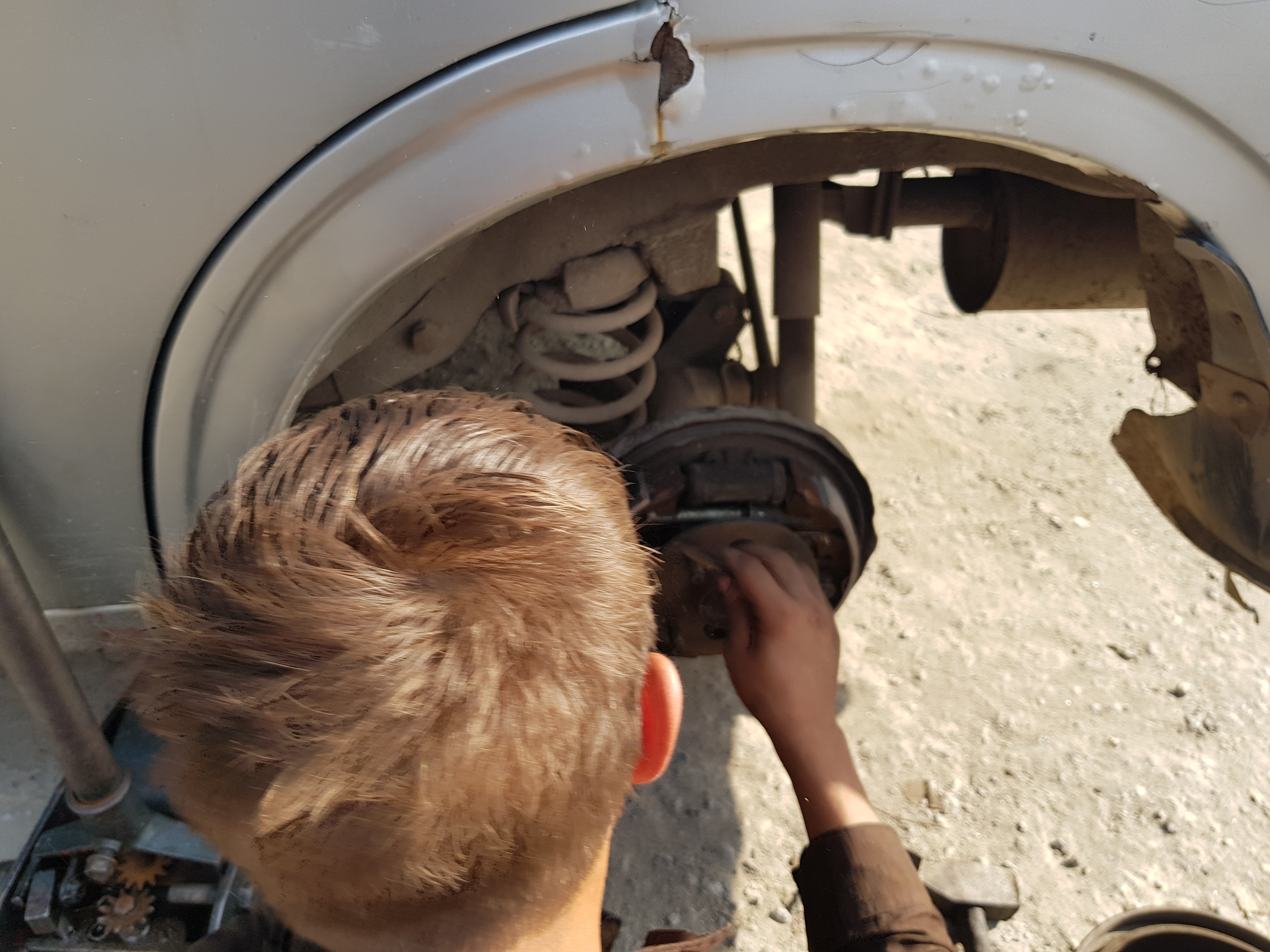

Day 1 - since the car was parked for last 4 years, it had no brakes! Literally none! So first things first - Got them cleaned and all 4 brakes were bled! There was an issue with front driver side brake calliper as it was leaking the oil onto the disc so mechanic had to alter the rubber washer to make it fit and tadaaa it did work and no leakge - brakes are much better now as car jams in when hit hard
Thanks mate - some areas on body have rust but overall its okay nd it had the best interior i culd find across all mark 2s i saw
Nope they are not - was unable to read the brand at the back due to extreme dusty condition of it but it did say made in japan

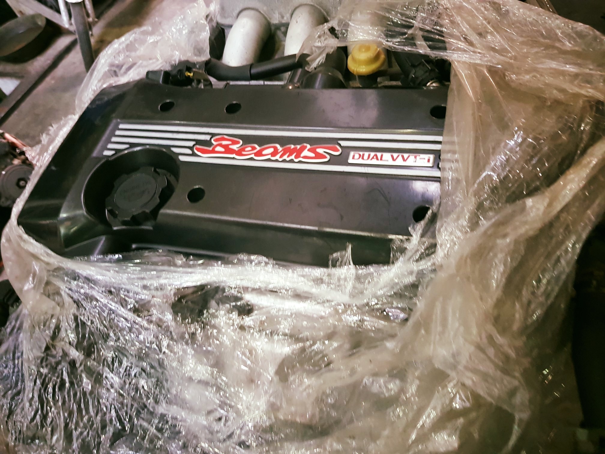

Coming up - Got it for 85k with auto gear - complete engine with power pump, Ac compressor nd uncut wiring!
That's nice, from where did you get the engine? Pindi?
Lahore - Bilal Gunj!
that's very nice..... how many engines he had ? and what other options of engine you looked for?
He had 2 3sge beams - only 1 was with gear that i have booked1G beams i have also looked into but it's a heavier and bigger engine
