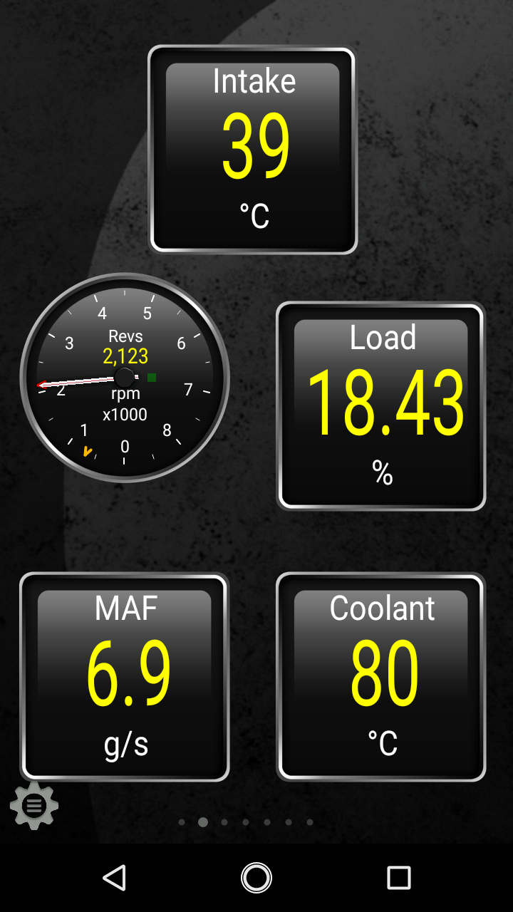

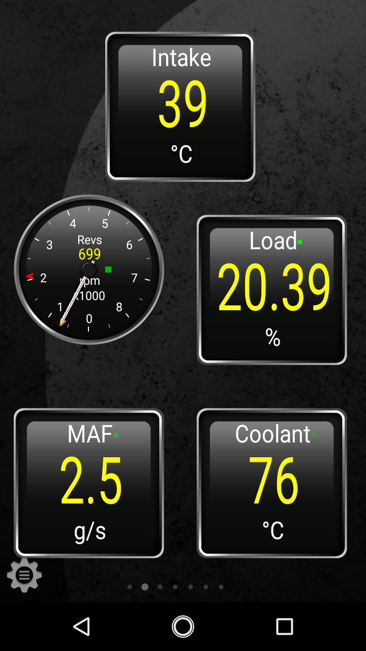

I used Torque Pro to get some MAF readings at different RPMs, are these values normal for 1.8 Liter 1zzfe engine
Looks ok with three values.Do u have any drievability issue with car?Get values at 750 1000 1250 1500 1750 2000 2250 2500 rpm, u should see a linear graph
