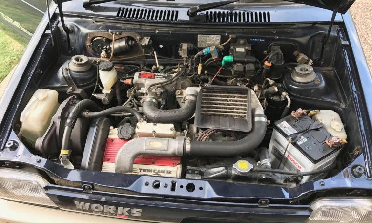

2.Engine swap. I have Automatic K6Ain mind like the one in the video. He swapped K6a from Seventh Generation ALTA aka HA25 2009-2014 and has installed the meter of the same car. I also had R06A in mind but it is more advanced engine and successor to K6A and I might not be able to properly hook it up so I’ll go for K6A Automatic. Now K6A (non-turbo) came in from Fourth Gen ALTO to Seventh Gen ALTO (read Wikipedia on Suzuki ALTO) and is quite a good engine. Versus the F8B (Mehran’s own engine) which has 39.5 HP/29 kW output, K6A has 53 HP/40 kW output. Now there are three versions of K6A, normal K6A (my intended swap), lean burn K6A (46 HP/34 kW which I don’t want), and Turbo K6A (60 HP/44 kW which I don’t want due to hassles involving turbo). Now the lean burn K6A came in and was common in fifth generation alto (the alto having same shape as our 1000cc local ALTO), thus I am avoiding the K6A’s of fifth gen alto as I can’t differentiate between normal K6A and lean burn one. Moreover, the Automatic K6A comes in 2 variants, one with 3 gears and one with 4 (OD) gears. The OD version one has larger and heavier gear and the ustaad/mechanics here are advising me against it and I also don’t want it as I don’t intend to put extra weight in my car. The guy in the video swapped K6A from seventh gen ALTO which only comes in 4 (OD) gear version. After all the research, I have decided to swap K6A from Sixth Gen ALTO (2004-2009) which only comes with the 54HP/40 kW version in automatic with only 3 gears. One of my friend here has this ALTO, I drove it and I liked it. It’s engine is in abundance here in quetta with complete wiring and costs only Rs. 30k. Below is the picture of Sixth Gen ALTO’s engine which I’ll swap in my Mehran:

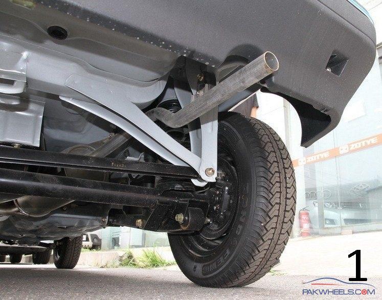

6.Bumpers/body kits. I will order simple elegant looking (not racer or ricer stuff) from this guy (most probably the 1st Picture one): https://www.facebook.com/groups/306839890084123/permalink/543811299720313/?sale_post_id=543811299720313

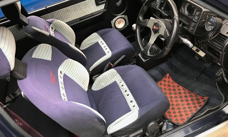

7.Seats. Guys please recommend me the most comfortable seats that I can install in Mehran. I saw a thread where Mira’s seats are recommended for Mehran. But I need expert’s advise on the seats.

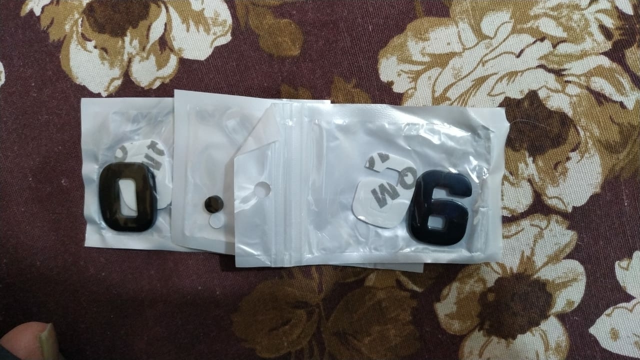

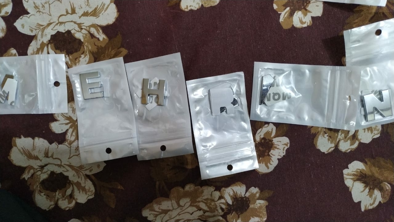

ix. Many other small stuff like metal decals/emblems, Suzuki keychain rings emblems etc

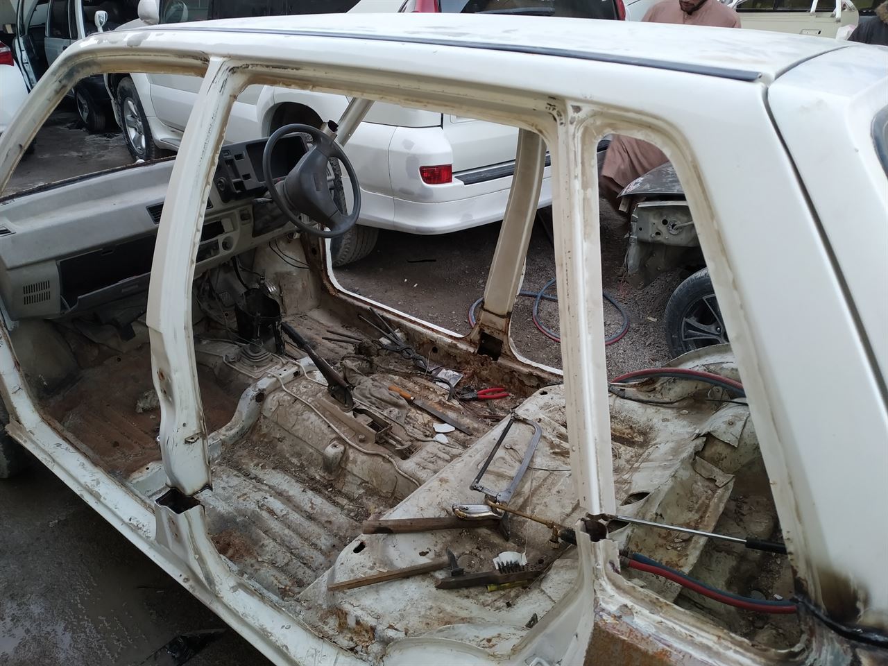

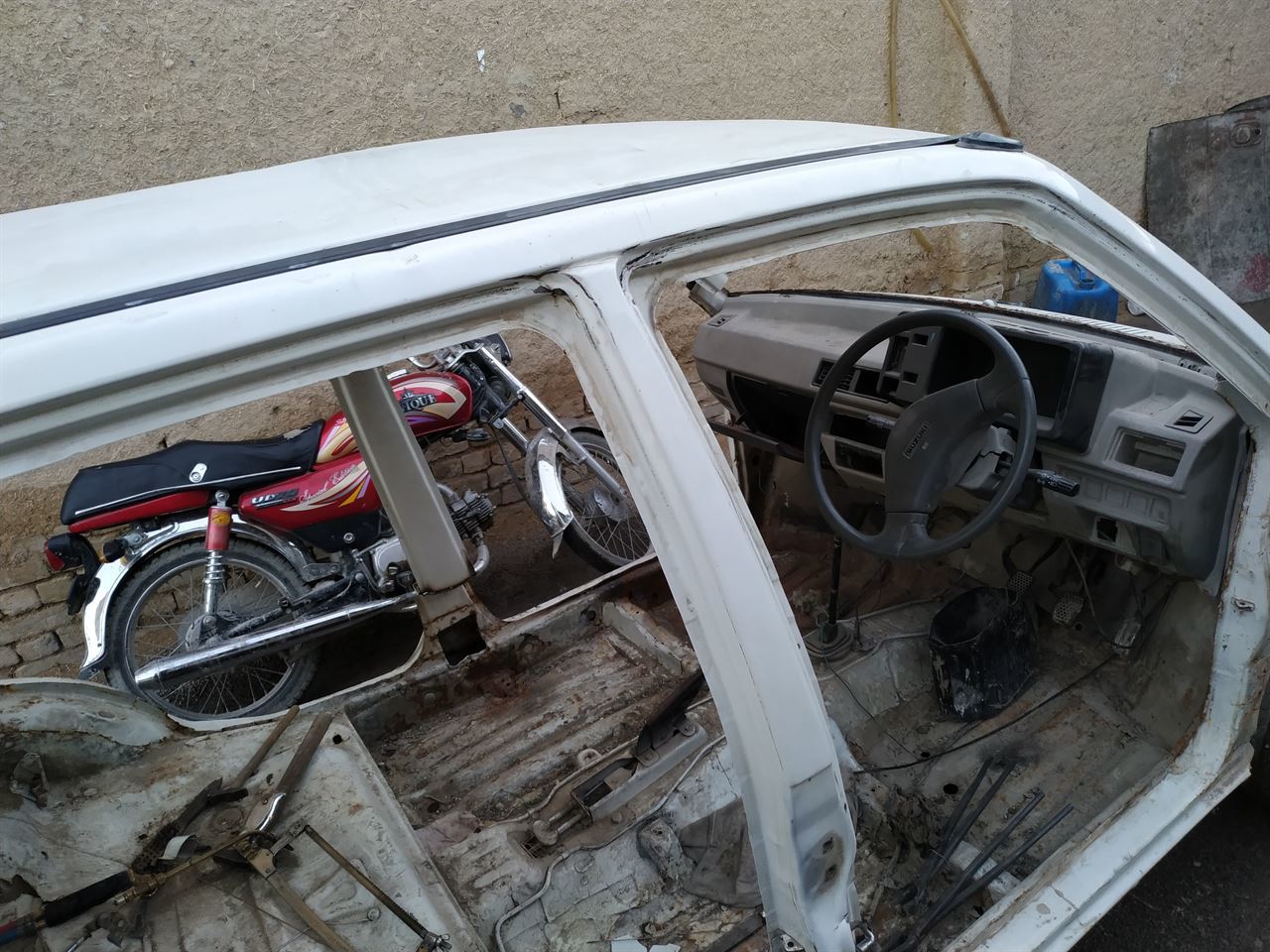

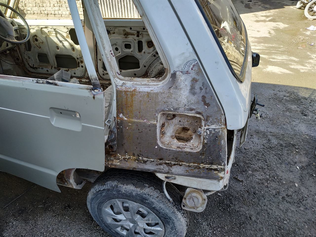

Below are the current under progress pictures of the car:
I will keep on updating this thread and post my progress. I request expert advise for my project as well as suggestions for any other thing to do. I request you guys to pray for the success of this project. I intend to keep this car afterwards for a long time since it’s a small car best for city use, has low cost and cheap spare parts, and can be parked in small spaces.
